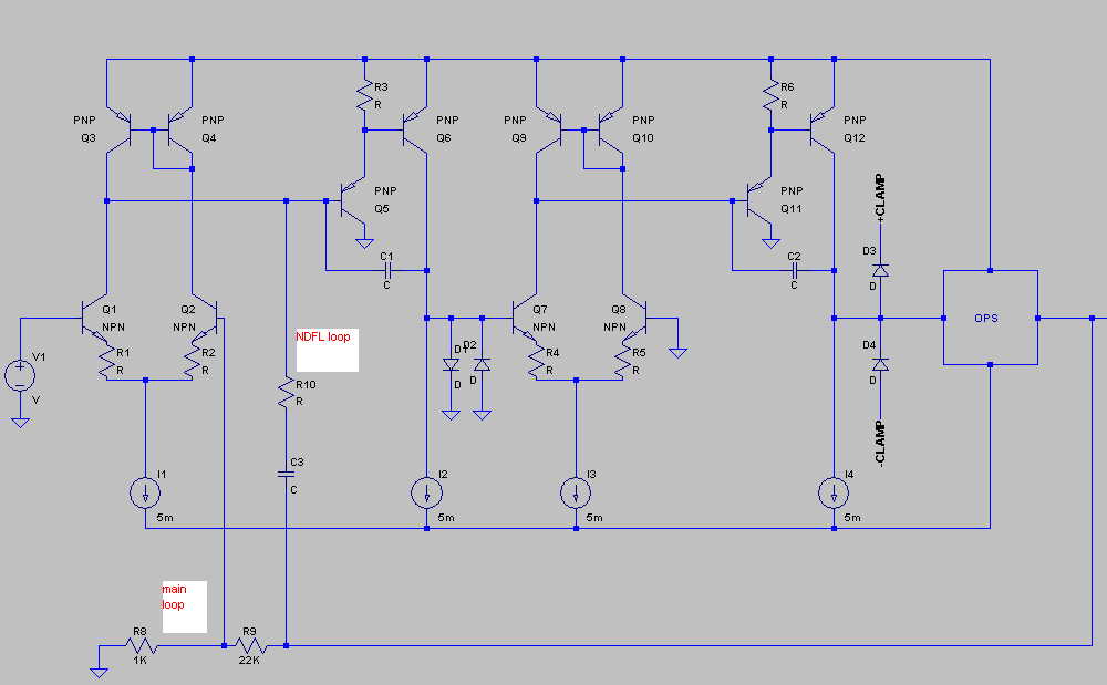

Re: Re: Re: Re: Re: CFB OPS
Hi Glenn,
Nice work and nice results.
I have a few questions and observations.
First, I hate to sound ignorant, but I have forgotten what CFB stands for and who came up with the term.
Congratulations on mastering NDFL!
One thing I notice in your output stage that is of possible concern is your use of 0.1 ohm emitter resistors. Such a low value choice of emitter resistor often helps reduce crossover distortion, but at the expense of potentially serious thermal stability problems in the output stage.
BTW, how much bias current are you running in the output stage?
What governed your choice of the 6.8-ohm base stopper resistors?
One thing that can be tricky with base stopper resistors is that they result in an effective ohmic emitter resistance at low frequencies that depends on transistor beta and is modulated by beta droop. If the output transistors have RB=4 ohms at low currents and 7-ohm base stoppers and beta=75, then the effective ohmic resistance seen at the emitter is 0.15 ohms, comparable to the external emitter resistor value of 0.1 ohm.
Bob
G.Kleinschmidt said:
Well with only half as many tricks and a "bare-bones" circuit I'm already down to ~1ppm 50W into 8 ohms and 2ppm 50W into 4 ohms with a single pair of optimally biased (class B) RET's in the output stage.
My very first attempt at ndfl and a evening of playing with the simulator.
This is also a realistic sim - not the kind BS so often seen around here such as ultra low THD but with 1 degree of phase margin (ie only workable in simulator land).
ULG of the ndfl front end is 1MHz. The CFB OPS is 3.5MHz. ~80 degree phase margin and clean squarewaves with no overshoot.
The THD-20, 50W into 8 ohms (28.28V peak):
Harmonic Frequency Fourier Normalized Phase Normalized
Number [Hz] Component Component [degree] Phase [deg]
1 2.000e+04 2.827e+01 1.000e+00 -2.30° 0.00°
2 4.000e+04 2.303e-05 8.149e-07 94.90° 97.20°
3 6.000e+04 1.950e-05 6.899e-07 -136.53° -134.23°
4 8.000e+04 3.238e-06 1.145e-07 -92.86° -90.56°
5 1.000e+05 8.918e-06 3.155e-07 52.96° 55.26°
6 1.200e+05 1.655e-06 5.856e-08 -107.33° -105.03°
7 1.400e+05 6.442e-06 2.279e-07 50.49° 52.79°
8 1.600e+05 3.130e-06 1.107e-07 -115.97° -113.67°
9 1.800e+05 8.567e-06 3.031e-07 39.75° 42.05°
Total Harmonic Distortion: 0.000119%
Schemo:
Hi Glenn,
Bob

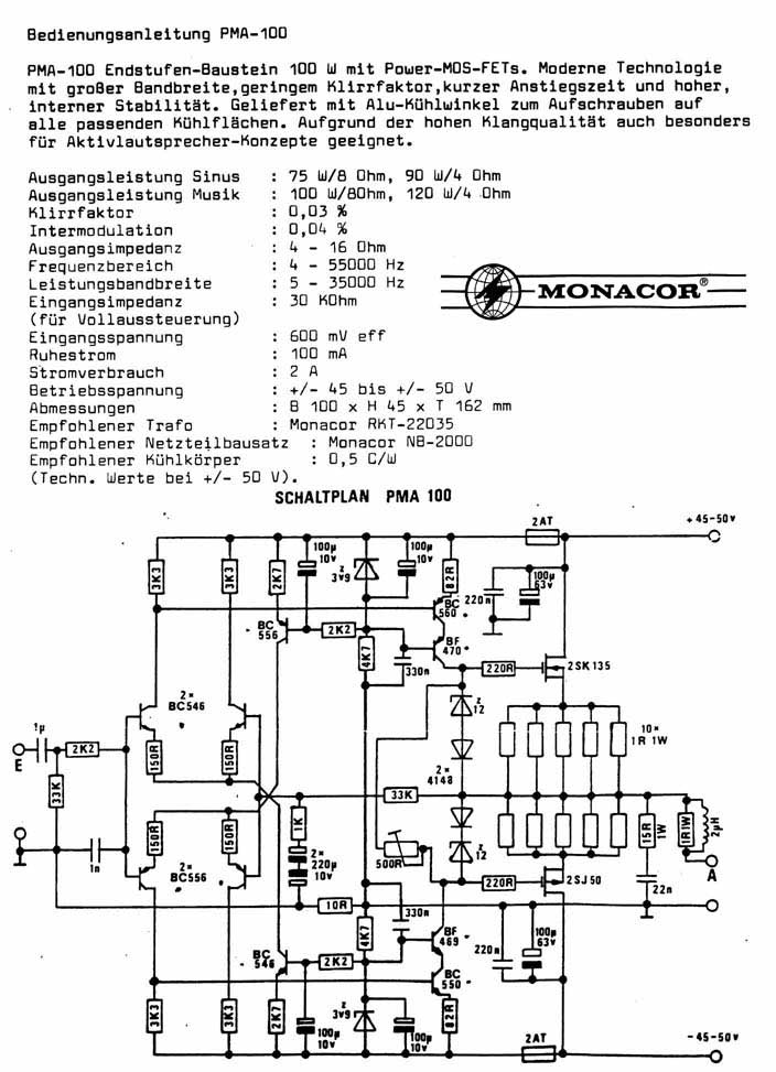

Re: Re: Re: Re: Re: Re: CFB OPS
Using various resistance in parallel minimize this problem?
OBS: This schematic is whith Mosfet, I have seen more with Bjts...
NO!. There are no overload recovery issues with a miller cap connected as feedback around a VAS. As far as that stage goes, all you need is a voltage clamp on the VAS collector.
I've got a few ideas for replacing that funky Rush current amplifier stage.
I agree, but this is just a simulation to test out NDFL combined with CFB. 6.8 ohms seemed like a nice value and the output transistor bias current was set for the lowest distortion (about 200mA).
Glen
