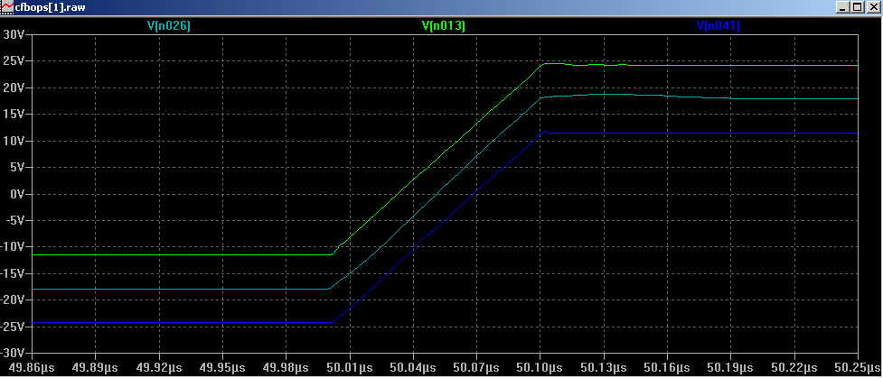

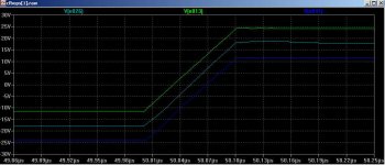

The sim below shows how the collector voltages of the input transistors track the voltage at the junction of the emitter degeneration resistors.
With 5V Vce maintained on the input trannies, low voltage, high speed small-signal types can be used here to further complement the bootstrapped Cob to keep the input impedance really high.
Glen

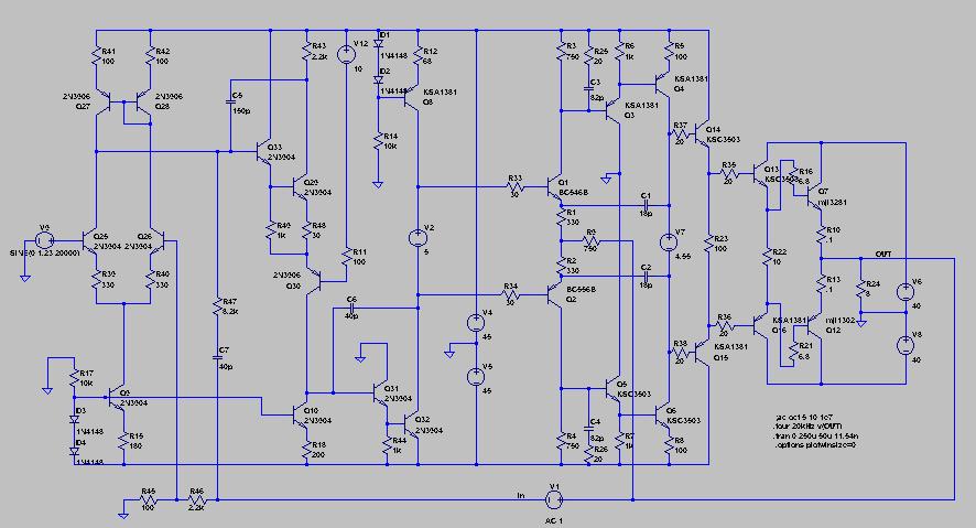

Well with only half as many tricks and a "bare-bones" circuit I'm already down to ~1ppm 50W into 8 ohms and 2ppm 50W into 4 ohms with a single pair of optimally biased (class B) RET's in the output stage.
My very first attempt at ndfl and a evening of playing with the simulator.
This is also a realistic sim - not the kind BS so often seen around here such as ultra low THD but with 1 degree of phase margin (ie only workable in simulator land).
ULG of the ndfl front end is 1MHz. The CFB OPS is 3.5MHz. ~80 degree phase margin and clean squarewaves with no overshoot.
The THD-20, 50W into 8 ohms (28.28V peak):
Harmonic Frequency Fourier Normalized Phase Normalized
Number [Hz] Component Component [degree] Phase [deg]
1 2.000e+04 2.827e+01 1.000e+00 -2.30° 0.00°
2 4.000e+04 2.303e-05 8.149e-07 94.90° 97.20°
3 6.000e+04 1.950e-05 6.899e-07 -136.53° -134.23°
4 8.000e+04 3.238e-06 1.145e-07 -92.86° -90.56°
5 1.000e+05 8.918e-06 3.155e-07 52.96° 55.26°
6 1.200e+05 1.655e-06 5.856e-08 -107.33° -105.03°
7 1.400e+05 6.442e-06 2.279e-07 50.49° 52.79°
8 1.600e+05 3.130e-06 1.107e-07 -115.97° -113.67°
9 1.800e+05 8.567e-06 3.031e-07 39.75° 42.05°
Total Harmonic Distortion: 0.000119%
Schemo:

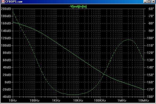

Here is the ndfl loop gain and phase (excluding the CFB OPS).
The Rush current amplifier used as the 1st intergrator is a real limiting factor in this design. I've improved it's linearity a lot by loading it with a CCS (so as not to "cripple" the VAS also) and adding an EF buffer between it and the LTP.
However it still contributes too much distortion and it totally farks the amplifiers overload / transient recovery.
I'll replace this stage with a "VAS" style intergrator next.
Glen
