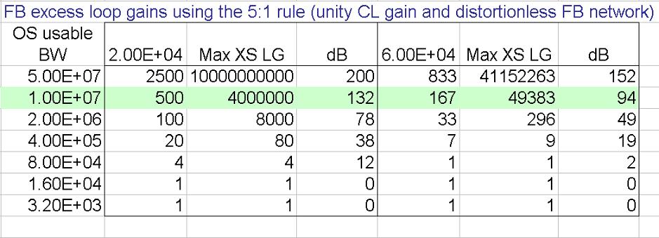

Just for fun. Tell me if this is right.
How much excess NFB loop gain is theoretically achievable using the 5:1 rule?
Suppose the usable bandwidth of the raw OS is 10MHz. IOW, 10MHz is the unity loop gain f of the closed loop amp, and suppose the FB network is distortionless.
Max excess loop gain at 20kHz = 10MHz/20kHz x 2MHz/20kHz x 400kHz/20kHz x 80kHz/20kHz = 4 million or 132dB. And the CL amp has unity gain.
Suppose we are interested in THD20 and we are good designers and H3 dominates, then we care about excess loop gain at 60kHz. In this hypothetical case it will be 94dB.

I see 4 tau's. One for the OPS and the other tau's for a three stage TPC, TMC or whatever. If that's what you mean I think you're right.

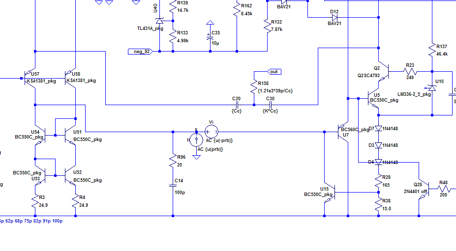

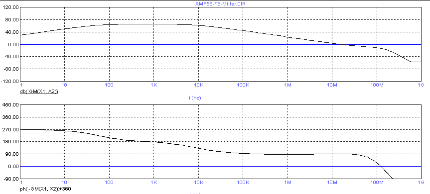

Re: TMC
Hi Andy,
Many times I have also seen such anomalies. BUT putting the gain probe on the right position and disabling the global FB loop (only at the AC level of course), then I get a picture that makes sense, see below.
Edmond
andy_c said:Yup. In fact, what I've noticed in my circuit is that TMC adds a kind of TPC-like effect to the Miller loop gain. IOW, the phase of the Miller loop gain approaches -180 at mid frequencies, then goes back up to around -90 at higher frequencies. Along with that is a -40 dB/dec rolloff in the Miller loop gain over part of the frequency range, but approaching -20 dB/dec as the Miller ULG frequency is reached. Have you seen this?
Hi Andy,
Edmond

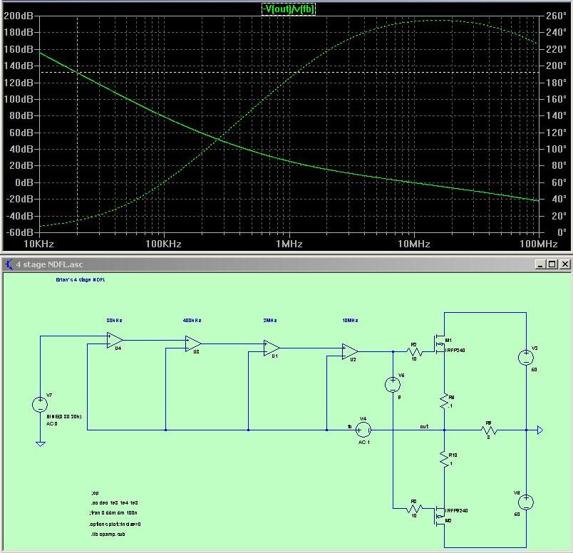

traderbam said:Out of interest, just how linear do you guys think you can implement a NDFL stage? This determines how many stages are effective. Is 2 stage, TPC, the practical limit or is ThreePC worth pursuing? It seems to me that 4 stages can fit in the bandwidth available, in theory.
Not sure I follow your stages enumeration, but to me anything over input stage(no pole)--gain(pole)--gain(pole)--output stage(pole) makes little practical sense. I'm sure an extra gain stage can be accomodated but I doubt its worth the trouble.
andy_c said:Now that you mention it, I believe my probe may be in the wrong place (see below). I'll put it next to C20 and give it another try. I am blocking the global loop gain, so that's not the problem.
Hmm... I don't see why the current position of the gain probe should be wrong.

Here's a schematic to illustrate what I'm trying to ask. Here I have created 4 NFB stages, each perfect integrators and each at a 5x GBP interval up to 10MHz. The total excess gain at 20kHz is 132dB and, as you might expect, the THD20 is really tiny...around 500ppb.
The number of stages that can be implemented in practice will be limited, not least, by the THD of the stages, particularly the first stage. So my question is how low a THD do you guys think you could build a stage in practice?
Eg: is -132dB at rated output achievable?
I believe Halcro claim 1000ppb or so.
Brian
