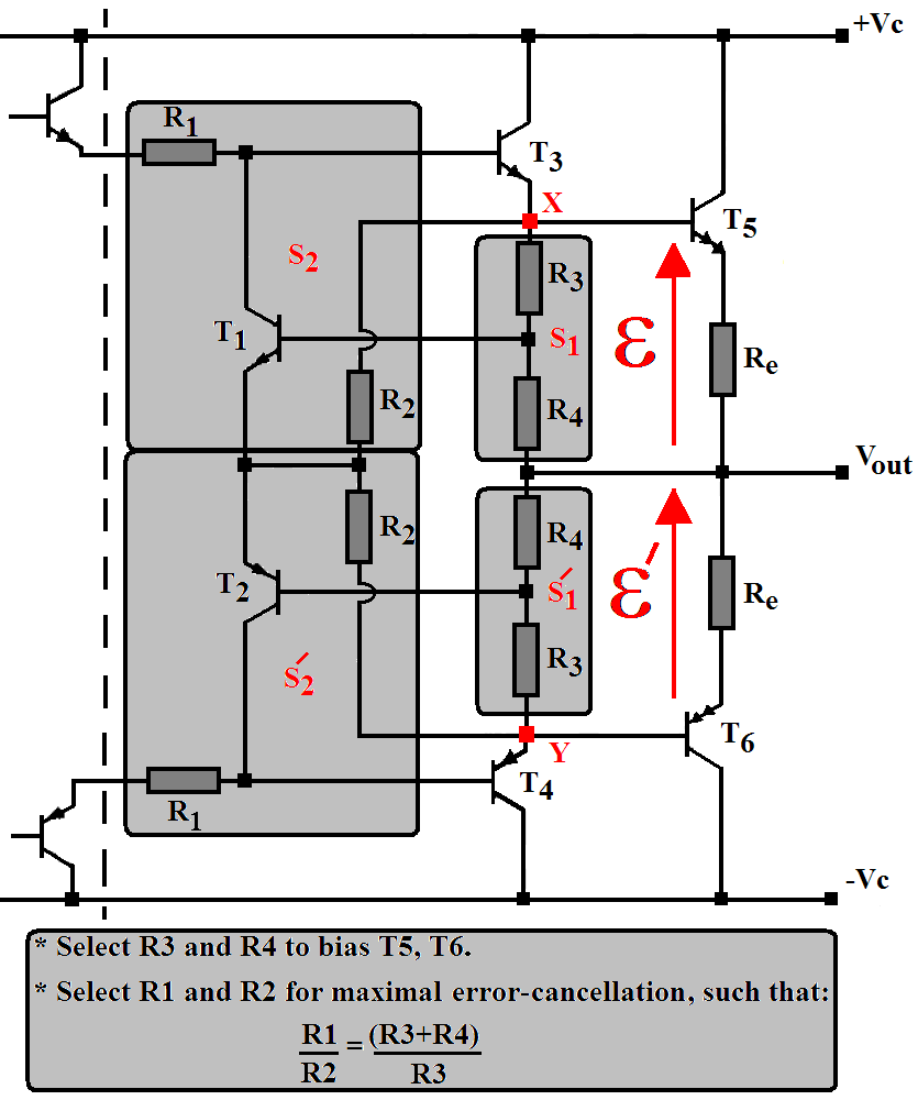

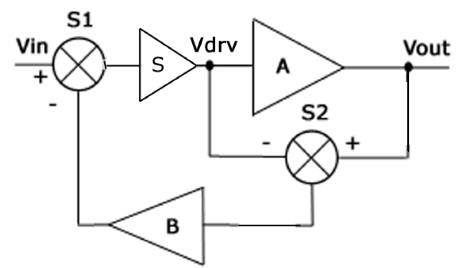

Given the former, further insight in the remarkable linearity of Hawksford/Cordell may be gained by comparing the basic block diagram with the nominal practical implementation given below.
Clearly the linearity of summer S1 is beyond reproach since it consists entirely of resistors! 🙂
Summer S2, on the other hand, consists of an active element, T1, and two resistors, R1 and R2.
The presence of T1 may at first appear dubious in respect of linearity, but this notion is quickly dispelled by the realisation that its non-linearity is significantly ameliorated by the heavy local feedback provided by emitter degenerative resistor R2. Indeed, in Bob's circuit this transistor is only required to generate a nominal gain of 2.
To my mind, the foregoing explains the remarkable practical performance obtained by Bob's circuit.
Nevertheless, it may be taken as axiomatic that residual summer non-linearity in the correction loop is entirely due to transistor T1.
This, of course, also applies to the negative polarity arrangement of transistor T2.

Hi Rodolfo,
Perhaps this is yet another case of misunderstanding.
I have reviewed your figure 3 below extracted from here, with 1/A' set to unity.
Now, noting that S must be unity at balance, what is S2's output when A is exactly unity?
Otherwise, what happens to your major-loop gain when A is exactly unity?

Hi Rodolfo,
Now, what is S2's output when A is exactly unity?
I bet it is misunderstanding.
By the very nature of the error correction approach, output of S2 when A=A' (which is the same to say unity gain plant and bypass of 1/A') is null. This is only to be expected and lends to Jan's insight, no error ->no feedback. It mus be understood the fact there is no error signal does not mean at all there is no gain or whatever.
What brings confussion to this simplified approach is the fact the inner loop embodies in fact a singularity, making simplified calculations including balance from the outset to fall appart.
I was from the start cautious to not include directly the cancellation condition, for doing so is what brings chaos. Further, recognizing at least one element in the inner loop chain must be active (I considered natural S(s)) the singularity automatically disappears except for s=0.
An please, it was you who was pulling my leg with the dimensions issue, weren't you?
Rodolfo

The small-signal gains within the EC loop(s) are largely independent of the amplitude of the errors, as long as clipping is not approached. Rodolfo is correct.
Bob
Bob
Some misunderstanding here.
The individual ''small-signal gains within the EC loop(s)'' are certainly ''largely independent of the amplitude of the errors, as long as clipping is not approached'', as i have pointed out here.
However, this was not the issue referred to by Rodolfo and i, here, here and here.
Clearly the matter was about the major loop, and not individual ''small-signal gains''.
On this basis, therefore, i fail to see how Rodolfo could possibly be correct.
