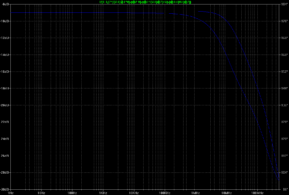

The result below (loop-gain less than unity) proves the correctness of the simpler approach above, and the correctness of this analysis.
Mike I hope I get some time this weekend to look at your analysis. I agree that the 'actual' ec loop gain is somehow proportional to the extracted error but hadn't realised the equation was so neat.
Nice work, thanks!
Jan Didden
Hi Mikes, re Post #1338:
1st circuit "loop gain" test with unity gain output seems to demonstrate that you made a pretty hi cmrr diff amp with U2
more informative to my mind is moving R9_1 ( “inverting input” of U2 viewed as a diff amp) left of the test source V1, this tests the loop gain the “controller” consisting of U1 and U2 is applying around the E1 output stage
My explanation for the 168 dB DC loop gain (conveniently –12 dB from the 1000Meg gain declaration inside the spice “universal” op amp models you used) is that the U1,2 diff amp inverting inputs in series form a positive feedback loop that effectively cancels a negative feedback loop, making the open loop gain of the loop around E1 equal to ¼ of the open loop gain of the op amp models used visible, the factor of ¼ even works out nicely:
simplified equation for U1,2 gain from R11 diff amp input, through U1,2 to the input to E1:
-(1/2) * (a_1 * a_2) / (a_1 + a_2 + 2)
the ½ up front could be attributed to the R10,11 divider, the other feedback networks R4,9 and R5,6 cancel when their equal R match exactly
for a_1 = a_2 = a >> 1 this further simplifies to loop gain of ~ -(¼) * a
I can’t think why your 2nd version with a 0 bias diode that acts like a high impedance – mostly the few pf diode C forming a ac attenuator with the 1K load has any relevance beyond the fact that if you include a high attenuation in you loop by changing the gain of a series element then the loop transmisson does change proportionantly since the loop transmission is the product of all of gains of the series elements
I would like to reiterate the point that the "increased transmission with error" you keep touting is referring to the Modeling Error of the output stage gain which means you are assuming a change in the linear system itself, ie the Model of the output stage, not the same at all as determining the disturbance rejection of a nominal linear system which is the more common sense usually meant by reducing a error signal with a linear feedback system
jcx said:
[snip]but I would like to reiterate the point that the "increased transmission with error" you keep touting is referring to the Modeling Error of the output stage gain which means you are assuming a change in the linear system itself, ie the Model of the output stage, not the same at all as determining the disturbance rejection of a nominal linear system which is the more common sense usually meant by reducing a error signal with a linear feedback system
Huh? Why would the effect of a modelling error in modelling a linear system be different (for the resulting error supression) from the effect from an accurately modelled linear system with induced error? In both cases there is an deviation from the idealised linear system; an error that is subsequently supressed to some degree.

jcx wrote:
more informative to my mind is moving R9_1 ( “inverting input” of U2 viewed as a diff amp) left of the test source V1, this tests the loop gain the “controller” consisting of U1 and U2 is applying around the E1 output stage.
My explanation for the 168 dB DC loop gain (conveniently –12 dB from the 1000Meg gain declaration inside the spice “universal” op amp models you used) is that the U1,2 diff amp inverting inputs in series form a positive feedback loop that effectively cancels a negative feedback loop, ...
Exactly.
My explanation for the 168 dB DC loop gain (conveniently –12 dB from the 1000Meg gain declaration inside the spice “universal” op amp models you used).......
Actually, the op amps are unity gain diff. amps., courtesy of 100% local NFB.
Their individual forward-path gains become somewhat irrelevant, don't you think?
....simplified equation for U1,2 gain from R11 diff amp input, through U1,2 to the input to E1:
for a_1 = a_2 = a >> 1 this further simplifies to loop gain of ~ -(¼) * a....
Clearly, you failed to recognise that each op amp is configured as a very elementary unity-gain differential amplifier. :bawling:
