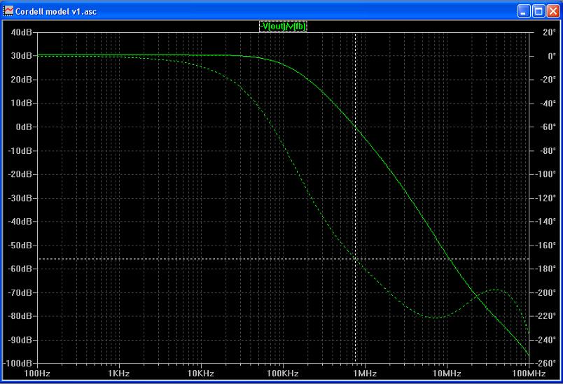

Brian's Cordell 1984 o/p stage model v1
Here is version 1. I've used the actual passive parts values that Bob gave me from his 1984 board. Most of the small power transistors are right. For drivers I have chosen ZTX651 and ZTX751 as approximations to MPSU07 and MSPU57. The output FETs are Andy C's, substitutes for the original IRF132 and IRF9130. Output bias is about 150mA. I've included Zetex's model statements in text files.
I have included a voltage source V9 so that the output device feedback loop gain can be measured as -v(OUT)/v(FB). R18 is the bias adjust resistor (a pot in the real circuit). V8 can be used to measure the closed loop response as v(OUT)/v(IN). The output is loaded with an 8-ohm resistor R18. I have a cap placeholder C8 for checking stability. The output current source I1 can be used to measure output Z as v(OUT)/i(I1). V6 and V8 provide the +/-11V input offset that Bob describes in his paper.

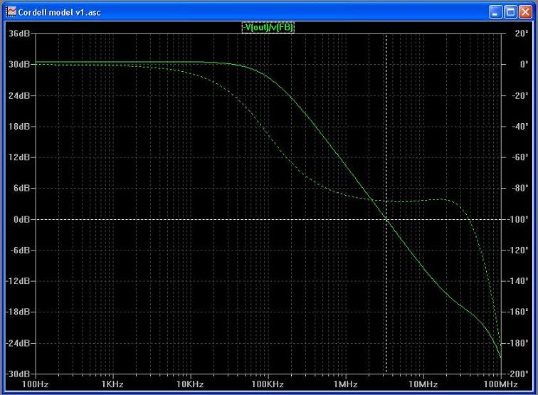

loop gain response
Here's the loop gain of Cordell v1, with v(IN)=0 and an 8-ohm load.
The LF gain is about 31dB, with a knee at about 75kHz. The unity gain frequency is 3.3MHz with 88 deg phase lag. The system is very stable.
This result is consistent with the actual measurements Bob made in terms of the reduction of THD when the feedback was applied (see post #743).
Bob, did you measure the loop gain of the actual circuit?
Here's the evil capacitor load test. This is the feedback loop gain measured with C8=2uF. This may be of general interest to show what capacitive loads can do to feedback circuits.
The knee has been reduced to 64kHz and unity gain frequency is now 750kHz with 172 deg phase lag. This is very unstable and is the reason why an output inductor is essential in the real circuit.

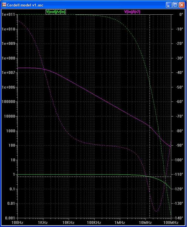

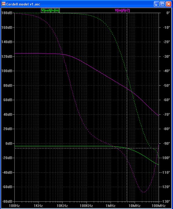

Now the overall transfer function into 8 ohms load, V(out)/V(IN) and the input Z, V(IN)/I(IN)
The -3dB point is about 15MHz.
The input Z is very high, being over 1 Mohm at 20kHz and is capacitive. The input Z drops to 3k at 10MHz and sees a second pole above this frequency.

Re: loop gain response
Nice work, Brian.
No, I never measured the loop gain of the actual EC circuit.
Bob
traderbam said:Here's the loop gain of Cordell v1, with v(IN)=0 and an 8-ohm load.
Nice work, Brian.
Bob

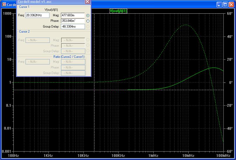

traderbam said:Same agin, 1 ohm resistive load but this time with the feedback disconnected (V9 removed).
Not that the overall gain is about -3dB and the knee is again at about 5MHz. The input Z is higher, this time over 1M ohm at 20kHz.
Brian, great posts. Thanks for that.
Jan Didden

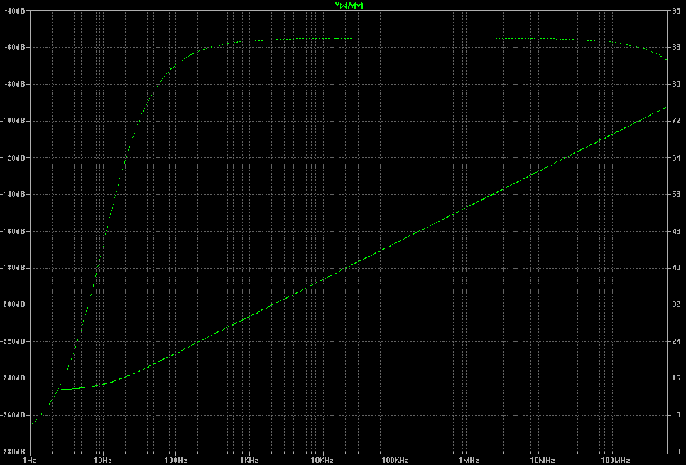

Continuing from here and here respectively, the equivalent circuits below are used to demonstrate that loop-transmission in the major-loop described by summers S1 and S2 (here op. amps. U1, U2), is very small, being much less than unity if an ideal output stage (E1) with exactly unity gain is used.
If non-linearity is introduced courtesy of a diode in series with the ideal output stage, then the magnitude of loop-gain increase to virtually unity, proving that loop-transmission is proportional to extracted error.
This is consistent with this analysis.
