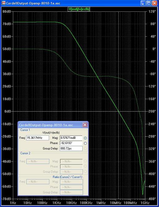

Focussing on the output stage, here's the output stage feedback loop gain with the input grounded. Unity gain at 15MHz - very fast. I noticed you've bootstrapped the output driver psu to the output. Lots of things to look at from both distortion and stability perspectives.This is not the amp I mention before!

traderbam said:Focussing on the output stage, here's the output stage feedback loop gain with the input grounded. Unity gain at 15MHz - very fast. I noticed you've bootstrapped the output driver psu to the output. Lots of things to look at from both distortion and stability perspectives.
Brian,
output driver PSU is (and must!) be bootstrapped to the input of the powerstage.
This I use frequently more then 20 years, only the last 10years I do it also in simulations.....because I started with computer and simulations late in 1996 😉
Therefor I use for stability tests normally rectangle signals...on the bench it´s hard to measure the (open) loop gain!
Heinz!
The beauty of this circuit is that when the loop gain of the error correction loop goes to zero, the feedback just "gets out of the way", allowing the circuit to have its natural bandwidth. It's my view that Heinz has just cracked the problem of error correction without adjustment.
