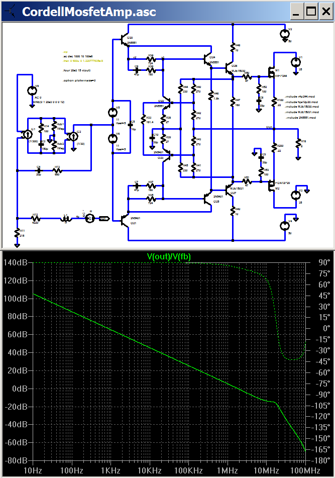

...still temporarily available, at http://www.fullnet.com/u/tomg/EC_Amp.asc. To actually run it, you would also need http://www.fullnet.com/u/tomg/OPA541E.SUB . Note that the downloadable version is the slightly-older one, without the magic notch filter.
thanh said:@gootee: I downloaded your schematic, file .asc 17KB. I open it by LTSpice but there is nothing

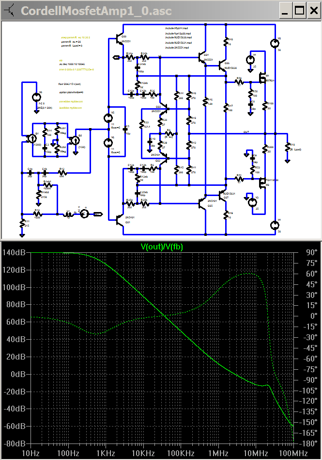

Here I’ve added local positive feedback to extend both the error correction amplification bandwidth and to take advantage of more open loop gain from the front end, the “minor” structural changes include reconnecting Q24,5 collectors to add current gain, and bootstrapping the supply to the error correction/driver stage
I see 0.5 ppm thd from the sim – 8X “better” than the nominal error correction circuit above
The price paid is the loss of phase margin,
The ac plot shows gain intercept at 2.7 MHz, 56 degrees
This is not necessarily the best approach – but may answer the question of whether positive feedback can improve distortion performance
My view is that the AC positive feedback bootstrapping of the error correction gain RC networks has extended the bandwidth of the local ec loop and increased the input impedance of the whole ec/output stage at higher frequencies
With increased input impedance at higher frequencies it is then attractive to split/bootstrap the front end diff/vas compensation cap C4, moving the sim’s 20KHz outer loop gain from ~45 dB to ~75 dB, this increased outer loop gain is partially offset by the reduction of the error correction loop gain due the increased drive impedance, but the net is a reduction in simed distortion

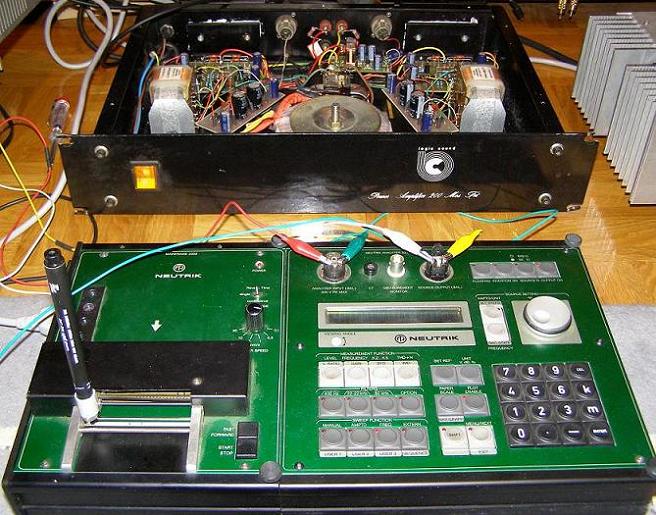

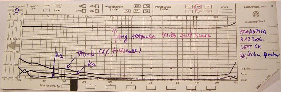

OK guys, now that we've started talking measurements here are the measurements of a real world error correction output stage, a.k.a. Academia.
Before I give you the results, I wish to say that the measurements were done in a home environment, on a real world loudspeaker with a nominal impedance of 8 ohm and using my home measurement set. Also, you will note a peak in the frequency response at 50kHz, which is due to the interstage transformers I mentioned earlier (compensation required). Given the circumastances, I think the measurements are very good but will appreciate any comments and suggestions.
Legend:
THD + N = no filters
K2 = second harmonic
K3 = third harmonic
Measurement set = Neutrik Analyzer 337
Milan

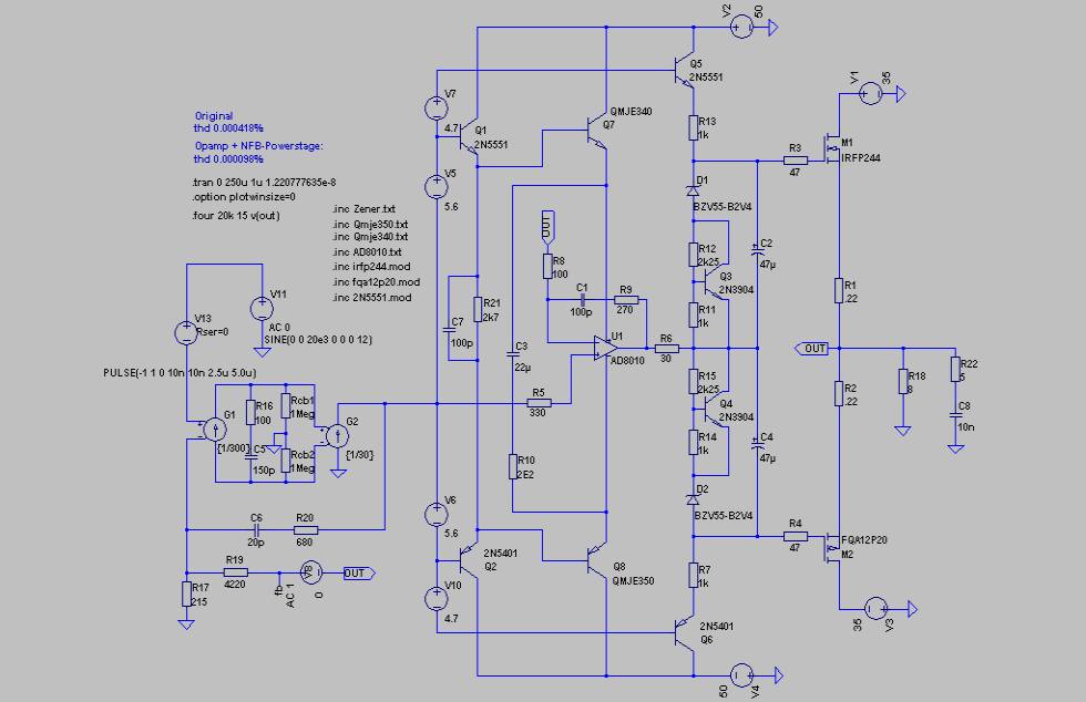

Hi John,
I'm not sure I'm reading your graphs properly but it looks like the second circuit is somewhat unstable? I've attached my current LTSpice model of Bob's output stage so you can see the resistor values he has actually used. You should see the "EC" loop gain is about 31dB flat to a knee at some 90kHz or so with unity gain at about 3.4MHz. This is into an 8-ohm resistor. The circuit to thr right is nothing to do with it...just my FET "matching" jig.
Brian
I'll publish this again once I've got better transistor matches in it, along with loop gain graphs.
Brian

Milan,
This looks pretty exciting. Can you measure the THD 20 like Bob did on his and give the result? I'm not sure what load Bob used - I guess an 8-ohm resistor.

Hi Brian:
The measurement printout shows the frequency response up to 40kHz and THD up to 40kHz. The only caveat is that the frequency response of the Analyzer's own measurement amplifier affects negatively THD measurement results at frequencies above 20kHz. If you take a look at the printout, you'll se that K2 and K3 are approx. 0.05%. As with the frequency response, one should bear in mind that the THD measurement results are inclusive of interstage transformer characteristics.
Milan

Milan,
Let me do a "back of a fag packet" estimate. Bear in mind I don't smoke. If both k1 and k2 are 0.05% I make the distortion -60dB or higher. That seems reasonable to me. What resistor values are you using...the ones in Bob's 1984 paper or the actuals he told me earlier in this thread?
