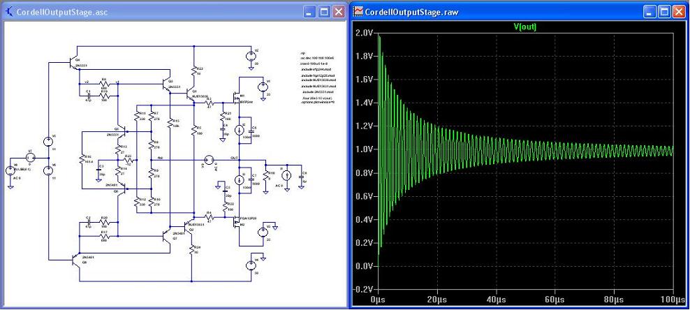

The outter loop gain of the EC will reveal the cause of the peaking. Would you measure the outter loop gain with the 2uF and tell me the unity-gain f and the phase margin?
When I do this simulation with the Cordell model, nulled, the unity gain f is 750kHz with 1 deg of margin. Pretty unstable - no wonder an output L is mandatory. To resolve this the outter loop phase margin needs to be widened by at least 45 deg.
Possible...but tricky.
That's an interesting idea. I've been stuck in the "inner loop" rut, but it looks like the outer loop approach is a good one to take here.
I just did the sim with the Cordell model in the "as posted" conditon with a 2 uF load. Result was an outer loop unity loop gain frequency of 658 kHz with a phase margin of 5 deg. With the current project I'm working on, I get an outer loop unity loop gain frequency of 570kHz with a phase margin of 78 deg. This is also with a 2 uF load.

Andy_c wrote:
When you apply global fb the phase shift of the global loop components must be added to the phase shift of the EC. If the global feedback has unity gain at 570kHz and no phase shift (unrealistic) then the whole amp won't show much/any overshoot in the sim. So it is no surprise that any reasonable amount of global feedback destabilizes it.
How much overshoot do you see with the global feedback applied and what is the GB of the system?
You should be glad that your new project has a good amount of phase margin. In a simple two-pole system you need >76 deg of phase margin to eliminate overshoot as you know. Of course this isn't a simple two pole system so more may be needed. Can you see how much overshoot the output stage has on its own, if any?I just did the sim with the Cordell model in the "as posted" conditon with a 2 uF load. Result was an outer loop unity loop gain frequency of 658 kHz with a phase margin of 5 deg. With the current project I'm working on, I get an outer loop unity loop gain frequency of 570kHz with a phase margin of 78 deg. This is also with a 2 uF load.
traderbam said:When you apply global fb the phase shift of the global loop components must be added to the phase shift of the EC.
I don't follow. Even though the unity loop gain frequency of the error correction loop is only 570 kHz, the -3 dB bandwidth of the output stage itself is about 2.3 MHz with the capacitor and almost 23 MHz with an 8 Ohm load (though it has about 108 deg phase lag there). So it doesn't behave as a classical feedback system in that sense.
I'm still working on the rest of the design 🙂. I started with the output stage and am working backwards. I've done some experiments with an idealized VAS and input stage, along with a variant of Bob's lead compensation that bypasses the output stage at high frequencies. That's it so far.
Andy_c wrote:
Does the output stage overshoot at all on its own into 2uF?
Sorry, you are quite right. I need to go to bed. So you need to see what the phase response is of the output stage vs f with the dreaded 2uF attached, then add this phase to the global loop phase, once you've designed it.I don't follow. Even though the unity loop gain frequency of the error correction loop is only 570 kHz, the -3 dB bandwidth of the output stage itself is about 2.3 MHz with the capacitor and almost 23 MHz with an 8 Ohm load (though it has about 108 deg phase lag there). So it doesn't behave as a classical feedback system in that sense.
With the output inductor, resistor, zobel, etc., the load seen by the amp as far as computing global loop gain is very benign. I'm not messing with a design without output inductor. Also, the series R-C from VAS to inverting input does an amazing job to reduce the output stage's phase lag contribution to the loop gain at high frequencies. I had to do a variant of this design to get a realizable C value though.
I'll look at the overshoot later and report back.

Andy_c,
Here's the 1V step input response of the Cordell model when driving a 2uF cap, with near optimum null. The ringing reduces if the capacitance is reduced: 1nF gives 3% overshoot.
The ringing will reduce if the PFB is reduced in one direction from its peak, but will increase in the other. This is because the phase of the PFB loop changes through the "null" point. Go too far the wrong way and you'll have your own radio station.
Brian
