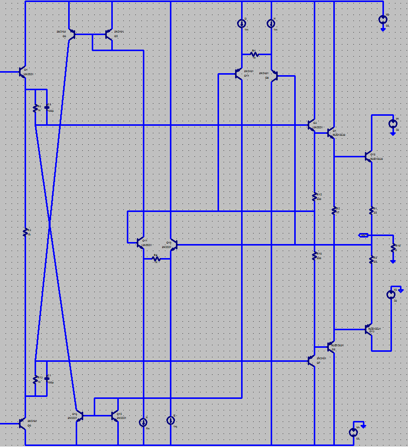

Hi Bob.
What do you think of Hawksford's alternative to defining the error amplifier's collector loads below?
I am presently mulling over how Yokoyama could be similarly implemented.
I suspect, for a start, that a complimentary pair of emitter-coupled stages (as error extractors) may be necessary.

Re: Hi Bob.
Continuing from here.
Something roughly like this:
mikeks said:What do you think of Hawksford's alternative to defining the error amplifier's collector loads below?
traderbam said:Does the output stage overshoot at all on its own into 2uF?
Okay I just looked at this. If you do a sim of the square wave response of Bob's output stage, you'll see that with an 8 Ohm load, there is some overshoot. This appears to be caused by its transfer function having a zero on the negative real axis, like a slightly overcompensated scope probe. A low-pass filter at the input takes care of this.
When I do a sim of my circuit with a 2 uF load, this overshoot also appears and is cured the same way, with an input LPF. With the LPF, its square wave response into a 2 uF load looks like a single-pole circuit - no overshoot, no ringing. The highest LPF -3 dB freq that fixes the overshoot is 660 kHz. When put into a real-world amplifier, it would seem to be a non-issue, since the bandwidth of the amp should be limited either by caps in the feedback loop, an input LPF or both.
This overshoot is also present in my design with an 8 Ohm load. I suspect it's a side-effect of the error correction.

Bob wrote:
Yes, that would be useful. I want to try to mimmick your results as closely as possible. By the way, which of the resistors did yout tune if any? I notice in your paper that you suggest a resistor in the PFB loop, between the junction of the 330 ohm resistors and the 27 ohm resistors. I'd like to make the LF loop gain comparable...I realise this may be tricky unless you've measured it in the specific circuit you built. Based on your THD improvement measurement I'd guess the loop gain of the EC was about 30dB at 20kHz.I thought all the values you needed were in the MOSFET amplifier paper on my web site. I think only the transistor types are lacking. Is that what you needed?
