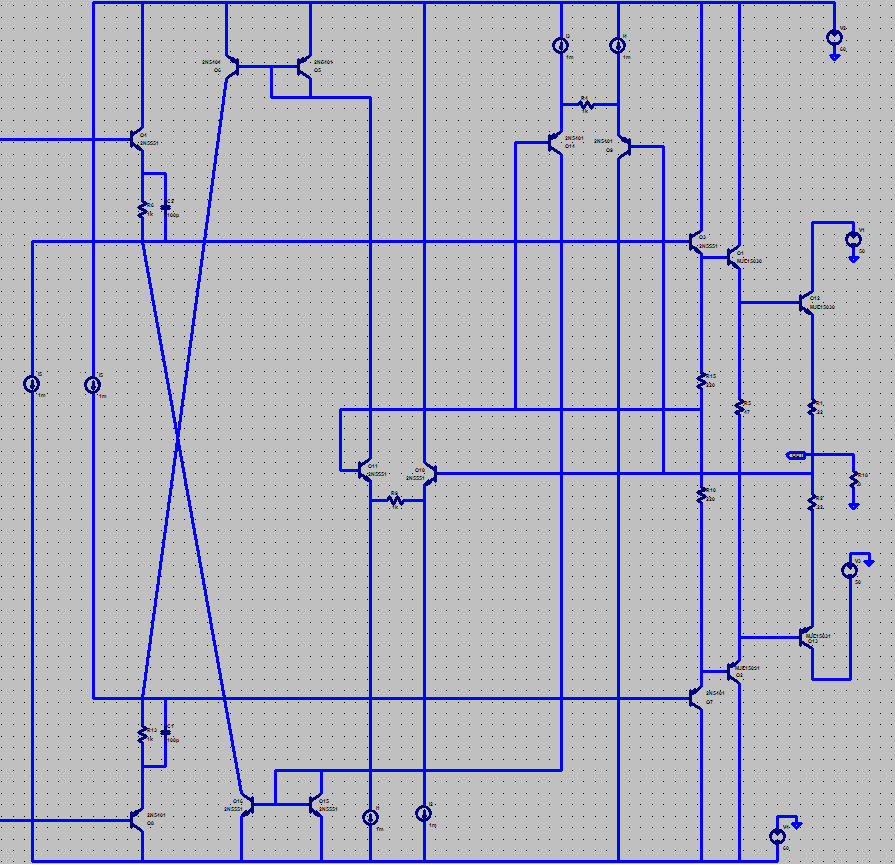

mikeks said:
Another possible arrangement?
Mike, I don't think you need those current mirrors. For each diff amp, you can take one collector and hook it up to the parallel RC. Then you can take the other collector and hook it up to the emitter of the emitter follower at the input. Notice this results in a constant current of the emitter follower, even as the error correction current varies.
Then you might imagine floating the diff amp current sources so they're bootstrapped to the output voltage somehow. This may be more practical with FET output devices, as the bipolars develop so little voltage drop that VCE crowding of the error correction transistors or their current sources could result.
