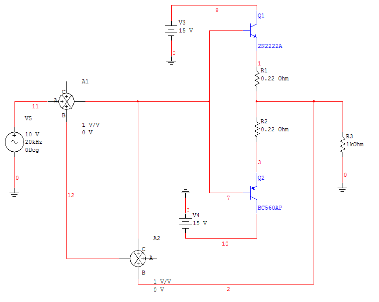

PPMFJI. I've been watching it happen on my simulator screen, most of the afternoon, in a new amp's simulation: With relatively low feedback gain, the cancellation will be imperfect. The more gain there is in the feedback loop, the closer to perfect the cancellation gets. BUT, _that_ means that the feedback loop then gets a smaller and smaller error signal. And, also, the cancellation effect increases more slowly than the feedback loop's gain. As the error gets vanishingly small, a real system has already run out of feedback gain, and an ideal system's feedback gain goes to infinity.

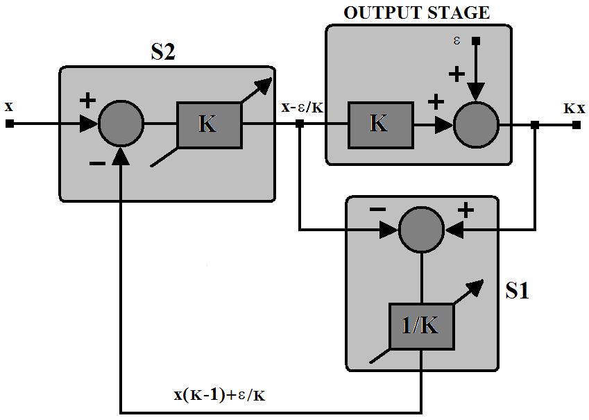

Actually, without Rodolfo's 1/A' term his equation 2 here reduces to this equation here.
Viz.There is no positive feedback.
Michael, in your equation, looking at the original (fig 1) diagram one can see the cancellation condition is K2.K3=1, this is crucial for error correction to be such, any other choice is not error correction and cannot be considered and compared as such.
Substituting, the result not unexpectedly is G = K3, and the contribution of K1 disappears.
In my case, the cancellation condition 1/S-B=0, exactly the same, the result not unexpectedly is G =A', the contribution of A disappears.
In neither case the positive feedback is obvious algebraically, because de double loop topology conceals it, better said, cancels the inherent pole at DC.
Rodolfo
Rodolfo

This thread has taken now an interesting turn again.
My view at least, and of course can be falsified if wrong, goes along this way.
Given a physical system with inherent transfer error, there is absolutely no way to correct it only by taking action "after the fact".
The rationale is, once an infinitesimal deviation occurs, there is no way for a feedback / feedforward mechanism to erase it as if it had never happened in the first place. This should be a time paradox, but this is precisely what complete correction means in the first place. Second best is to reduce it to vanishingly small levels, accepting never to erase it completely.
I also mentioned feedforward for, despite it has been said for example in the Liptshitz Vanderkooy paper, it must be accepted the error is computed a some instant in time, but cannot be added with zero delay (it must be amplified to be injected). This may have no practical consequences, for this delay can be made as small a technology allows without compromising stability. But cannot accomplish complete correction in a strict sense.
Turning back to feedback, in the form of error correction and following the previous line of thought, it is apparent one wants to apply the correction as soon as possible, that is, to have the highest practical processing bandwidth. This is precisely what error correction implies.
For negative feedback, the asymptotic requirement is infinite gain. This can be seen also as a zero delay equivalent, for it means an infinitesimally small departure instantaneously elicits an infinitely large corrective action.
Both approaches have been shown to be dual faces sharing a common mathematical description. This is what I hinted in a previous post as a joke Nature is playing, showing the way for a deeper reality. In fact I have been toying with the idea of proving negative feedback and error correction belong to an equivalence class where a functional transform turns one into the other. This is well above my par in math, so I was thinking to contact people form the Mathematics Institute at the Faculty. A good hint in this direction is both lead to the same description of a circuit, but this is not what I am seeking as a result.
Anyway, it does not harm to poke around this garden.
Rodolfo

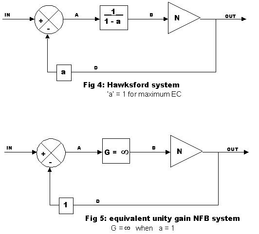

The nulling feature explained, part 2
Your simulation results make sense to me, Tom.
Let's look again at Hawksford. What the fig 4 system actually gives you is the ability to adjust the loop gain of the system by means of "a". When a = 1 the loop gain is maximized. In a real circuit there will be at least one pole in the loop and the unity gain bandwidth will not be infinite. As you change "a" you both change the low frequency loop gain and move the pole frequency.
This is very much like the behaviour of an op-amp integrator where the -'ve input is fed by a current signal and the output is connected to the -'ve input with a capacitor. If a variable resistor is placed in parallel with the capacitor the integrator response gains a pole whose frequency can be varied. The null condition, when a=1, is equivalent to the resistor having infinite value.
The loop gain of Bob's output stage exhibits this behaviour in simulation too.
My proposition is that this ability to adjust the positive feedback and minimize the pole frequency is very useful, but not as useful as using a fixed integrator (always at perfect null) and varying the gain bandwidth product of the loop. For it is the GBP of the loop (with adequate phase margin) that utlimately drives how powerful the distortion reduction can be.
In fig 5, this means the forward gain function, G, would be a pure integrator with a GBP adjustment. More on this after Bob's output stage has been analyzed in full.
Have you got those component values handy, Bob?

This Error-Cancellation method is quite interesting. I haven't had time to read the papers or re-derive it in mathematical form. No need. But I happened to be working with a new amplifier's simulation, when I read one of the messages about error cancellation. So I decided to just try it, in LT-Spice.
Interestingly, the "input + correction" signal that gets applied to the chipamp's input (i.e. just after the summing junction) looks almost EXACTLY the same as it does in the classical-feedback version that I already had finished.
(I'm sorry if mentioning chipamps is heretical, in this group, but,) I was designing a control system to wrap around a single-IC power amp (e.g. LM3886 et al, except the only Spice model I could find that was at-all similar was for the OPA541(E)). In addition to the standard out-to-neg inner feedback loop around the power amp, I have an outer loop, with an opamp ahead of the power amp, so the power amp is inside the opamp's FB loop, in the forward path, with the chipamp's output (eventually) connected to the opamp's neg input, and the input signal connected to the opamp's pos input. The chipamp/inner loop is set for a gain of 20.
The error-cancellation loop was very easy to slap together, with a couple of dual opamps.
Having not read the papers about it, my system might be simplistic: To get the error signal, I merely scale the output by the inverse of the forward gain, using a resistive divider (with buffers before and after the divider), and then subtract the input from it, by using an opamp as a differential amplifier. The error signal is then amplified and subtracted from the input signal (using the opamp that feeds the chipamp's pos input).
It works. But, to get it to give THD that's as low as my classical version's, I'd probably need to tweak or servo the output offset voltages of all of the opamps in the feedback loop, to make the error signal more accurate.
I also created a "Classical/EC Hybrid" version of the same amplifier circuit, by simply adding the error cancellation loop to the completed design that already had the classical-approach outer feedback loop, subtracting both of the feedback signals at the same point.
I must say that adding the still-imperfect EC loop to the classical system made a major improvement! I thought that I had wrung almost every last bit of performance out of that system, already, and had THD figures of 0.001926% @ 20 kHz and 0.000330% @ 1 kHz. BUT, after adding the EC loop (but not fixing any of the offset voltages in it), the THDs went to 0.001166% @ 20 kHz and 0.000048% at 1 kHz! And everything else still looks good, too.
I think I'll keep it.
- Tom Gootee

True.
Note that although the product of the gains across the summers has to be unity for balance (error cancellation), this does not apply to the system's loop-gain.
