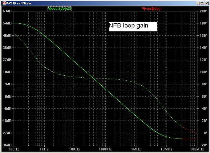

Yes, that is the trade-off between stability and NFB loop gain. In the circuits show (which are only approximations to PAX) the NFB unity gain f is about 200kHz. 150/5 is 30, so your performance difference corresponds closely to the NF loop gain.
I guess you simmed these, can you show us the beef please?
As shown I guess it is stable without C2/C4; how does it look without these caps?
These caps are like Miller caps. They set the first pole frequency. So if you make them 15pF the ULG f rises to about 2MHz.

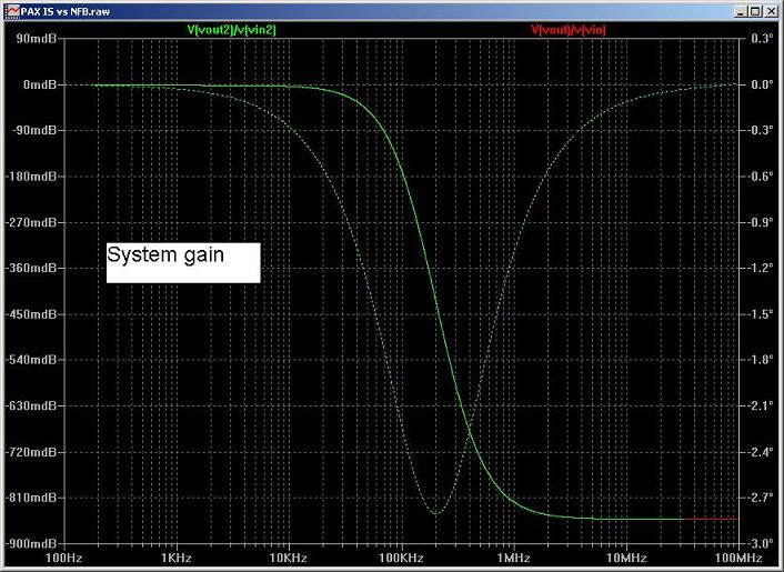

I'll post the simulator results...
System gain, Vout/Vin for Figs A and B. They are identical. They don't look like real life because the plant has not phase shift.

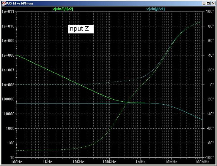

Input Z for figs A and B. Here, fig A has a fairly flat impedance of 50k-ohms up to about 2MHz. Fig B has a rising impedance with decreasing frequency.
You'll observe that C4 does not need to be connected to Vin. I did this just to make the circuits look similar. If C4 is connected to gnd, then the input Z of Fig B is infinite. In practice, it will be the i/p Z of the AD844, increased by the NFB.

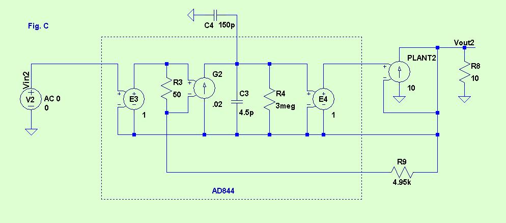

I don't know whether you have the time or inclination to try this, but I would be interested in whether changing your PAX to the conventional FB makes a difference to its sound. Fig C is the arrangement I mean, and it is only a few solder joints different. At the simple simulation level, Fig C should be slightly better because the preceding stage sees a much higher input Z. But reality may be different.
