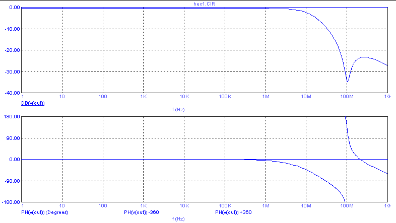

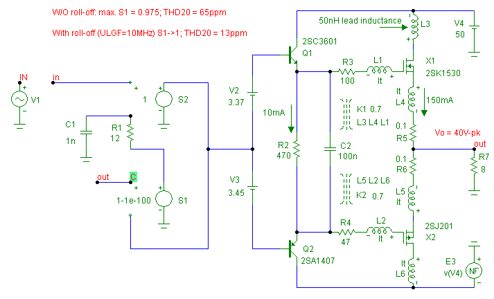

In the meantime I was playing with my simulator and the results confirm that even if we have summers/subtractors with infinite BW and zero phase shift, we cannot build a perfect HEC. The phase shift of the OPS is a limiting factor as well. If it reaches -360 degrees we get in trouble.
The circuit below, for example, gets unstable if S1>0.975. Below this critical value the THD20 sticks at an unexciting 65ppm.
But now comes a surprise: If I inserted an additional roll-off between S1 and S2, the max. allowed gain of S1 is very close to 1 (but not exactly 1). Consequently, the THD20 figure is much better: 13ppm
BTW1, the unity loop gain frequency seen at point C is 10MHz (and probably too high for a real circuit).
BTW2, 13ppm isn't the best we can get. A similar OPS based on GNF+TMC gives a 10 times better THD figure.
Anyhow, my previous remark that perfect summers can correct all phase shifts of an OPS, was plain BS.
Edmond
edit: S1 > is also allowed.

To state the obvious, in a FB control system (as opposed to a additive correction system like pre-distortion or feed-forward), the distortion reduction will be a function of both error sense accuracy (summer accuracy) and stability of the control loop. Forget either one of these at your peril! :Ouch:
So the plants phase shift always limits the maximum error correction achievable, even if you have perfect FB network components. The higher the (phase) bandwidth of the plant, for a given amount of non-linearity, the lower the corrected distortion can be.

Yes, with the caveat that you can almost arbitrarily correct the errors if they appear at lower frequencies. Like in the limiting case at f=0 (DC) you can correct perfectly. That's not a practical use, I concede that.
What I found is that you get the 'nicest' cl response (peaking only 3dB at hf) if you keep the ratio of the BW of the summers and the plant at 1.
