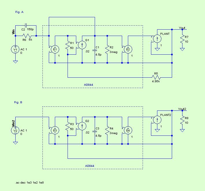

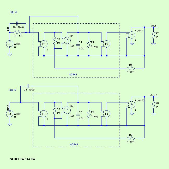

I modified Fig B to correctly include a FB resistor and the 150pF input capacitor.
I present these to facilitate a comparative discussion. Fig 1 is Jan's "PAX implementation of HEC" and Fig 2 is a functionally similar circuit that does not use a PFB loop. Showing the two in stark contrast may help with clarity of understanding.
I am interested in your opinions about the pros and cons of each circuit. What would cause you to favour one over the other?
Brian
Brian
Nice! I like it when everything is made as simple as possible, but not simpler, to quote Mr. Einstein (I think).
I don't intuitively see immediately what the performance difference is between the two. C2/C4 being as large as they are, I would *suspect* but don't kill me for it, that the performance is pretty similar.
That C2/C4 at 150pF is determining the final ec in the paX amp. On my test bench I had it working with just 36pF, and the ec was at least 5x better, but I couldn't get it unconditionally stable with cap loads, so in the interest of stability margin I went for 150pF.
I guess you simmed these, can you show us the beef please?
As shown I guess it is stable without C2/C4; how does it look without these caps?
Jan Didden
