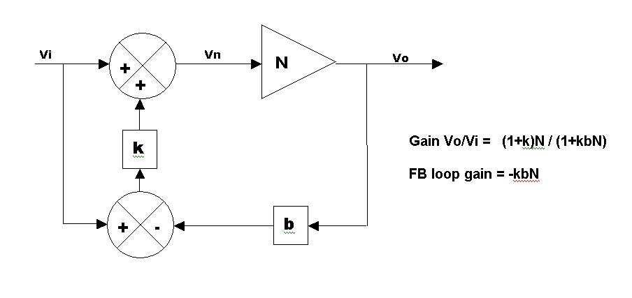

HEC is positive feedback on demand
Here is a version of the feedback-on-demand view of HEC.
With a slight chuckle, I am throwing this into the mix just to create more confusion.
HEC is actually a POSITIVE feedback system. The voltage across the output stage, from input to output, is fed back as an error and added to the input signal to the output stage. It is added in such a way that increased drop across the output stage is added in-phase with the signal to the input of the output stage. Thus, if the output stage has a gain of 0.9, then positive feedback with a loop gain factor of about 0.1 is fed back to the input. This results in a slight gain enhancement to the otherwise near-unity-gain system.
Now realize that MOSFET output stage distortion is largely a result of changes in output stage transconductance as a function of output current. Thus the output stage can be modeled as a perfect unity gain buffer followed by a variable resistor – one whose resistance depends on the current flowing. It is the voltage across this resistor that is fed back and added to the input of the output stage.
The gain of the output stage is just that of the resistor divider formed by this varying output resistance against the load resistance.
We are now free to swap the load resistance and the output resistor modeling the output stage, placing the latter at the ground end. We now need only take the single-ended voltage from this resistor and feed it back. Again, it is fed back as positive feedback. It is positive feedback whose amount is varied depending on the resistance of the variable resistor modeling the output stage. The voltage across the now-floating load resistor is still the same, and is what it should be. We thus have a simple positive feedback system whose loop gain is dependent upon the value of the nonlinear resistance. Notice that if this feedback goes to zero, we are left with the simple near-unity-gain amplifier.
Notice also that this is extremely reminiscent of the old tube amplifiers that had a variable damping factor feature, where the damping factor could be adjusted upward or downward with feedback that was positive or negative, and where the feedback was sensed by a small resistor in series with the return of the loudspeaker. Indeed, some have also used a feature like this to adjust the effective Q of a loudspeaker downward by feeding it with what amounted to a negative resistance to wipe out a portion of the voice coil DCR.
It is also interesting to realize that the primary form of frequency compensation in the Cordell version of the HEC circuit acts to reduce the feedback of the error signal at high frequencies, as opposed to putting a pole in the forward path of the system. At the same time, it is also fair to note that the secondary compensation, the small capacitor to ground in the emitter circuit of the error differencing amplifier, acts to interfere with the positive feedback loop so as to reduce its gain from theoretically infinity down to a smaller very finite value at high frequencies.
I am not claiming that this view of HEC (positive feedback on demand) is one that provides good insight on stability. Indeed, it may provide a misleading view on stability. For example, if the loop-gain-on-demand is so small, be it positive or negative, how can we possibly get into stability trouble. Maybe I am missing something here. I’m just throwing this all out as a brain teaser.
Bob

Well, you didn't answer my question. The way you talk, it seems to me that your real focus is on a specific implementation of a practical summer; a subtractor/integrator combo. That is novel and interesting, but I don't think it defines a functional difference with any other NFB system.
As for extracting the "net error", this is not unique to HEC either. This is how servos are often configured and servo-assist circuits. I would not call a servo an EC or a HEC just because it adds the difference between input and output to the input. This is not distinguishing. Using a PFB to generate gain is unusual but not original - this technique has been used in valve amps before I was born.
So this leaves me and my equations with no clear differentiator for HEC. For now, my analysis shows HEC to belong to the general class of NFB control systems, within the servo sub-category, with the unusual (but not essential) facility of a PFB nested loop to generate excess gain.
The reason I say a "tunable" PFB loop is not essential is because an equally ideal integrator can be made in practice using a transconductance stage and a capacitor. Nevertheless, the HEC topology makes a PFB integrator easier to implement.
As for hypotheses...
If I can help anyone objectively analyse a hypothesis, I'll be happy to try. But you need to define clearly what the hypothesis is, and its really up to you to let go of it if it is wrong or unverifiable.
"NFB on demand" - I still don't understand the definition.

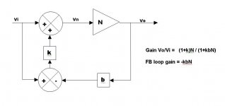

Brian's Error Correction
I'm going to take Bob's lead and throw another cat into the pigeon coup just for fun.
Here's my answer to HEC. Let's call it Brian's EC or BEC for short. I have incorporated the "wow" elements: only the error in the output is fed to the input, if the feedback signal to the input is cut the circuit becomes a simple follower. If you want infinite dc gain you can make K a perfect integrator (PFB or otherwise).
PS: it's really just a servo circuit.
traderbam said:
... For now, my analysis shows HEC to belong to the general class of NFB control systems, within the servo sub-category, ..
Turning the argument around, then you may as well dismiss all forms of servo systems insofar as they are equivalent to single loop NFB. Is that what you want?
On the other hand, if what you want is to make me admit HEC is NFB where the error instead of the signal is what is fed back, well, this is what I've been saying all the time.
Rodolfo

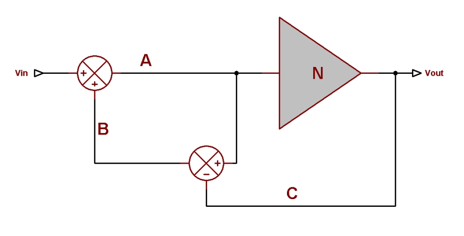

blind spot?
Hi Jan,
If I understand you correctly, you are saying that the only way to get insight in the amount of error reduction is by cutting the loop at point A, right?
Well, Brian's method (and mine) -cutting the loop at C- also predicts to which extent the error will be reduced. If the DC loop gain is 40dB, for example, the error will be reduced to 1% of its original value. Another example: suppose the loop gain at 60kHz is 30dB, then the 3rd harmonic of 20kHz will be reduced by a factor of 31.6, etc.
Please correct me if I misunderstood your point.
Edmond.

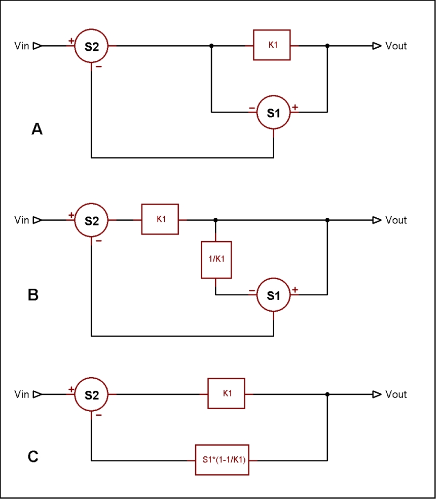

janneman said:[snip]
I think we agree that cutting it either at say, A or at C, gives different views and different attributes of that particular loop we thus created. I agree that cutting it at C does expose the infinite gain loop.
Cutting it at A, for example, exposes other attributes. For example, it shows that the error reduction at low frequencies is limited to the accuracy of 'a' (and the input summer), in that an accuracy of 1% gives you a max error reduction of 40dB.
As another example, it shows you that if you want this 40dB reduction up to frequency fe, your 'a' should have its -3dB frequency at least 2 decades above fe.
These are attributes that can readily be verified in calculations or in actual hardware, and confirm teh results of analyzing the loop in that way. Surely the purpose of analyzing the loop is to gain insight in how the actual system behaves? I don't see how analyzing the loop as proposed by Brian, while possibly interesting as an academic exercise, tells me how my system will behave, with the examples shown as well as in other ways. Maybe that is my blind spot?
Jan Didden

Re: blind spot?
Hello Edmond,
We xposted. I know which picture you referred to.
Interesting point. My point was that when you cut the loop at C instead of A you would get different values for loop gain and feedback. What you are saying now, if I understand you correctly, is that this may be the case, but still the final result, as far as the relationship between Vo and Vi, is identical.
I think we knew this already but maybe didn't give it enough attention: Brian's view and mine both lead to the same clg.
Maybe in the final analysis that is what Bob calls the different views: each view has its own, different, set of loop gain and feedback factor, but in each case the resulting clg behaviour is identical.
Speculating: looking ahead to an analysis where each element (K, a, b) is a function of the complex variable s, how would that manifest itself in the different views?
I wish I'd gone to university 40 years ago 😱
Jan Didden

Can you agree to my transformation to situation C in my earlier post?
Jan Didden
Edmond Stuart said:[snip] Let a simulator do the dirty job.
Much faster, less errors.
Edmond.
For this, I prefer Mathcad. No hassle with models 😉
Jan Didden
I guess you mean C in post 3611. Well, to a certain extent. See my post 3564.
Edmond.
Edmond.

Edmond Stuart said:I guess you mean C in post 3611. Well, to a certain extent. See my post 3564.
Edmond.
I'm not sure why it should be a problem that 1/K1 is not in the original circuit but in my transformation. It does lead to the same results as the original but is easier to analyse (at least for me) because it now is just a single loop.
I think it was Brian who remarked that moving the pos fb pickup point after N and then scaling it by 1/N was not allowed as it presumed a linear time-invariant system, which N generally is not.
OTOH, generations of control engineers have been using Laplace transforms to analyse similar systems, although the Laplace transform also presumes a linear, time-invariant system. People who convolve input signals with impulse responses to get output signals also seem to gloss over the fact that their systems are not linear.
So, I was wondering what this means. Does that mean that there is a small deviation from what the math predicts and what the real system gives, depending on how non-linear the system actually is? I could live with that, just like said generations of control engineers 😉
Jan Didden
