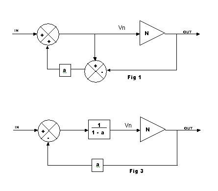

Jan,
Consider the diagrams below. Fig 1 is Hawksford's EC and from this diagram I calculate the equations for Vn...
Vn = Vin + a.(Vn - Vout)
Vn.(1-a) = Vin - a.Vout
Vn = (Vin - a.Vout)/(1-a)
This last equation is shown in diagram form in Fig 3.
Fig 1 and Fig 3 are identical, mathmatically. From Fig 3 you can see the FB loop gain is = -a.N/(1-a).
In this arrangement, by our earlier definitions, the FB factor is a.
Brian

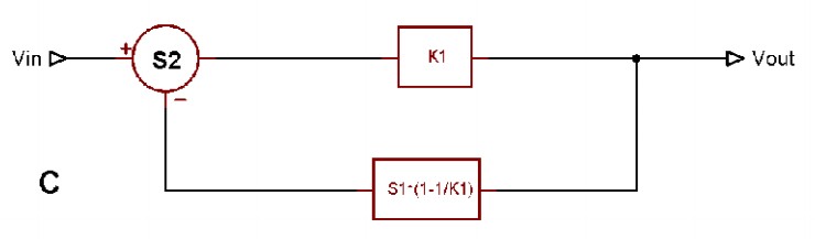

Hi Jan,
With all respect, I also have some trouble with your transformation (post #3552 and pic below). Although mathematically correct in the sense that if S1=S2=1, the X-fer function becomes independent of K1 (i.e. no distortion), I'm afraid your model does not reflect the real HEC, as there are a few things that bother me:
1. The expression in the FB loop contains a dependent term 1/K1, because it's also present in the forward loop (as K1). I wonder if this is 'legal'. At least it blurs the analysis.
2. The original HEC circuit doesn't contain such 1/K1 gain block (let alone that we can build such thing in real life).
For these reasons I think that Brian's transformation is more appropriate.
Edmond.
edit: Brian's FB loop gain = -a.N/(1-a) makes clear that if a=1 we get an infinite loop gain!

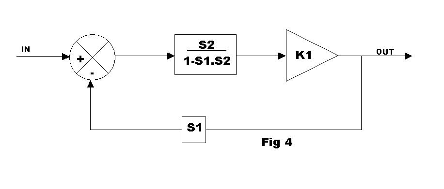

I agree. Jan's FB loop gain and FB factor calculations are in error because of the 1/K1 term in the feedback path. Let me try working these out using the system gain equation method.
From Jan's diagram C:
gain Vo/Vin = S2.K1 / [ 1 + S1.S2.(K1 - 1) ]
or
Vo/Vin = S2.K1 / [ (1 - S1.S2) + S1.S2.K1 ]
divide top and bottom by (1 - S1.S2)...
Vo/Vin = [ S2.K1/(1-S1.S2) ] / [ 1 + S1.S2.K1/(1-S1.S2) ]
Mapping on to G = A/(1+AB) gives A = S2.K1/(1-S1.S2) and B = S1
So FB loop gain = -S1.S2.K1/(1-S1.S2) and FB factor = S1
Again, the FB loop gain is of the same form as -aN/(1-a) and the FB factor is independent of K1.
Fig C can be redrawn like this:

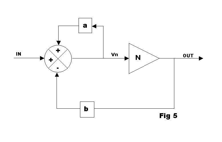

Here's a diagram of HEC showing the nesting and splitting the PFB loop scalar, a, from the NFB loop scalar, b.
Vout/Vin = N / (1-a+bN)
FB loop gain = -bN/(1-a)
FB factor = b
You can see that the infinite gain is determined by a alone. The NFB loop has no part in it. I see no special interaction between the loops; the loops are independent.
