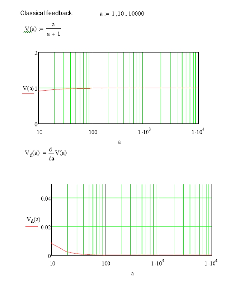

OK Brian, thanks for your pointer, here's what I have found.
We seem to have established that both the fb value and factor go through zero at A=1 and then incrementally grow with A deviating from 1. That lends credibility to the 'feedback on demand' view.
Your and Edmonds position is - in order to reconcile view #1 and view #3 - that even if the fb value and factor is zero, the fb 'power' is still there, and you referred to the Ve slope. (Ve being the output from the fb summer going to the input summer, I assumed).
I asked MathCad to plot the Ve curve. As expected, Ve=0 for A=1. At that point (A=1), the slope of Ve=1. That means that very close to A=1, Ve and A change at the same ratio, correct? So, that did give me some additional insight of what's going on near A=1.
Unfortunately, I still don't understand what it means that 'the power' of the fb is still there even when you can cut the input to the input summer or delete all traces of fb (both pos and neg) without any change. What is the physical effect of the slope being 1, other than showing how Ve changes wrt A around A=1? Or should I just stop worrying and see it as a mathematical thing that provides the connection between view #1 and #3, with no real physical complement?

OK, I think I understand better your reasoning. Even if at the time where there is no deviation, and I take my hands of the handlebars, still, when there *would* be a deviation, I'll react to it. So, the fb, as a system attribute, is still there even if latent. Not sure where this leads, but I get your reasoning.
I've done some more thinking about that Ve derivative. I would have thought that at a point where the fb would be infinite, the derivative of the feedback (factor) would be 0. Indeed, if you plot Ve for a range of A (see attachment) you find that at much higher A, the derivative asymptotes to 0. And, as noted, for A=1, the derivative = 1 as well.
Now if A becomes much higher that 1, we can expect the 'effective' fb to grow much higher as the nfb part of the combined loop starts to increase and dominate. That would jive with the derivative going to 0. But that would also indicate that the total system feedback at A=1 isn't infinite. Since the total system feedback is build up from a negative feedback part and a positive feedback part (giving an infinite gain block), those parts being exactly equal at A=1, this all seems to make sense.
If I have some time I'll try to do the same calculation and plots for a nfb-only system with an infinite forward gain. See how that looks.
Thanks for bearing with me Brian, I'm really getting a lot out of this.

I did the same curves for a high-fb amp, with a forward gain=a and unity feedback. See attached.
It seems that when a (the OL gain) gets above 100 we are already very close to the situation for a>infinity. The 'Va' (Ve in the other case) gets close to 1, and the derivative gets close to 0.
This appears to be consistent with the Hec situation.
Jan Didden
