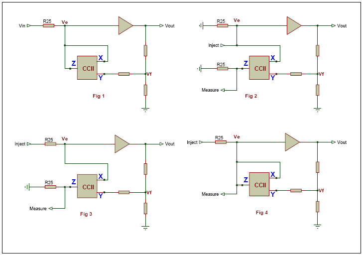

Fig 1 is the conceptual diagram of my ec amp. The CCII sets up a current into Y which is the error, this current is conveyed to R25 so a correction voltage is added to Vin. I won't go into details, more on my website.
For doing LG measurements I would cut the loop as in Fig 2, inject the stimulus and measure the response as shown. Is this a correct way to do it?
If so, then I could just use the regular input for the stimulus as in Fig 3, of course. Then I would go to Fig 4, and when doing the measurement would just subtract the stimulus from the raw measurement to get the LG measurement. In other words, I wouldn't have to break the loop at all.
Does that make sense?

Anyway. I still would appreciate an input as to my method to measure loop gain, see attached. I think it is in line with what I read elsewere and in Middlebrook's paper. The voltage injection point has a load Z (the amp input Z) that is much higher than the source Z (the measurement signal generator).
By terminating the error current generator at node Z in an impedance equal to the impedance it sees when the loop is closed (R25), that part is also being taken care of.
So, my loop gain is the measured response (fig 3) at node Z (measure) / input signal (inject). Any comments?

Hi Jan, I should use Fig. 2, but with a series impedance in the injection port as close al possible to the CCII output impedance across the measurement range, just for completness.
In Fig. 3 you do not have the CCII output impedance shunting node Ve, so measured transfer could in principle be affected, depending on whether R25 is comparable or not.

Rodolfo,
Thanks for your input. Indeed I should include that. In the audio band, R25 is several orders of magnitude smaller than the CCII Zout, but at higher frequencies that may not be the case.
OTOH, the CCII Zout is in parallel with the R25 that is on the measurement node, so at that point it IS included. Maybe that is adequate.

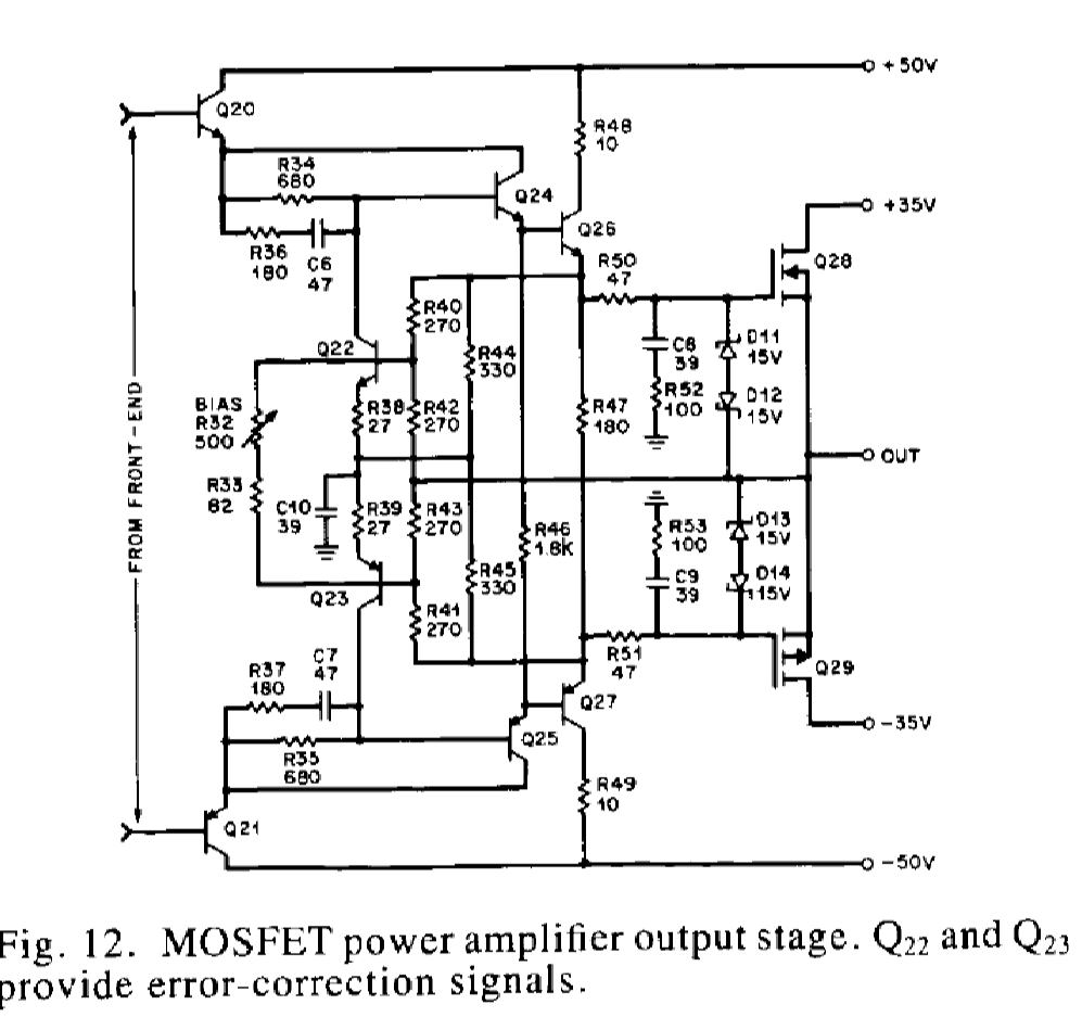

I've been playing with an ec ops similar to your fig 12 (attached), and I have a query.
The way I see it is that the ec mechanism reduces the distortion from the junction of R34 and B-Q24 to the output. This it does by varying the current drawn from that R34/Q24 node. However, the result of that is that the signal at R34/Q24 is no longer a faithfull copy of the Vas Vout: iow, the input signal to the ec loop is distorted by that loop itself.
Am I reasoning correctly here?

What a pleasant surprise! A new post in this thread since many days and bang! you're there. As if you were lurking for it (which you weren't of course, you were putting up wallpaper, right 😉 ).
Yes I *think* I know what you mean, I probably know Hawksfords paper by heart. But it keeps coming back at me all the time.
As you probably remember I used his concept in my paX amplifier, so I am familiar with it somewhat.
What I keep marvelling at is this. The signal at that R34/Q24 node is distorted by the EC. Still, the final result (in the ideal case) is that Vout is identical to Vin. Since the EC 'input' is connected to it's 'control' node, it can't really null out the distortion between it's input and the output. So what apparently happens is that it 'pre-distorts' the R34/Q24 node just enough so that, in combination with the intrinsic distortion of the ops, the result is perfect linearity (in the ideal case).
And it does that 'perfect pre-distortion' without having access to the Vin in the first place. Isn't that marvellous?
I was hoping Bob would have a view that was new to me to help me assimilate it better. I just hope you didn't scare him off. Then again, I find that Bob isn't a man who scares easily...
