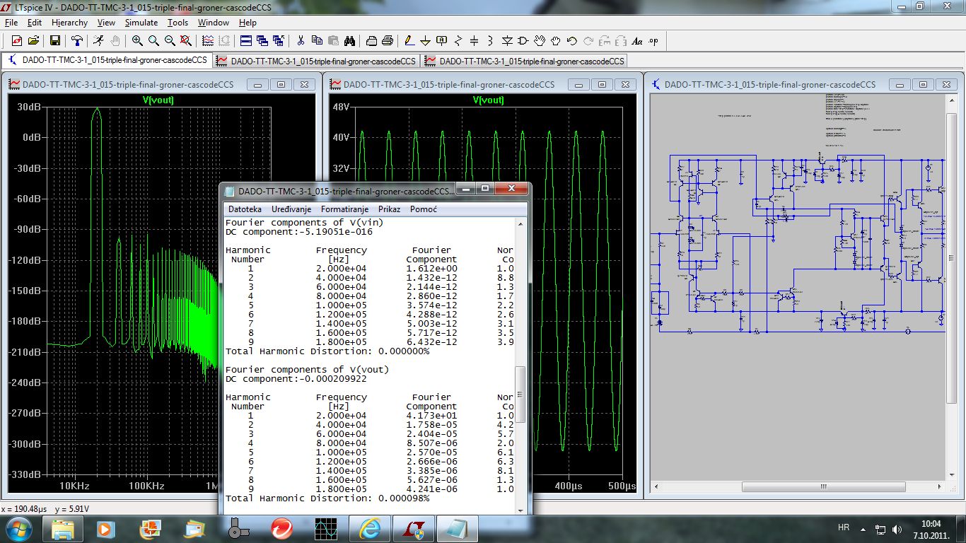

For purpose of comparison here are a few more simulated figures:
Bob's amp with HEC: THD20 = 5.7ppm
Bob's amp with TMC: THD20 = 8.7ppm
without HEC or TMC: THD20 = 96 ppm
As you see, TMC scores not as good as HEC, though it comes close.
I've tried to keep essential parameters as much as possible equal, except one thing: the transition frequency of the TMC network. It has to be limited at 1MHz, opposed to the 3MHz BW of the EC circuitry. If it was also set to 3MHz, the distortion would equal that of HEC, but at the expense of stability which dropped to an unacceptable level.
E.

This is the trouble of relying on SPICE for THD results.
There is no way TMC can give less than 0.002% THD at 20KHz closed loop in any class B or AB amp in practice with a stable TMC loop about the output stage.
EC on the other hand can give less than 0.0006% at 20KHz closed loop with ease.
For the amp with BJT outputs there is no need for EC.
This is not true. A BJT output amp will benefit a substantial amout from EC, significantly more so than with TMC.

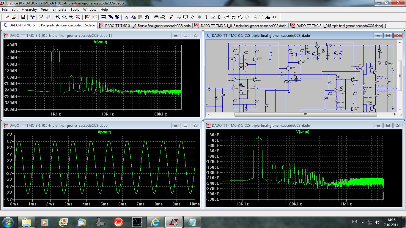

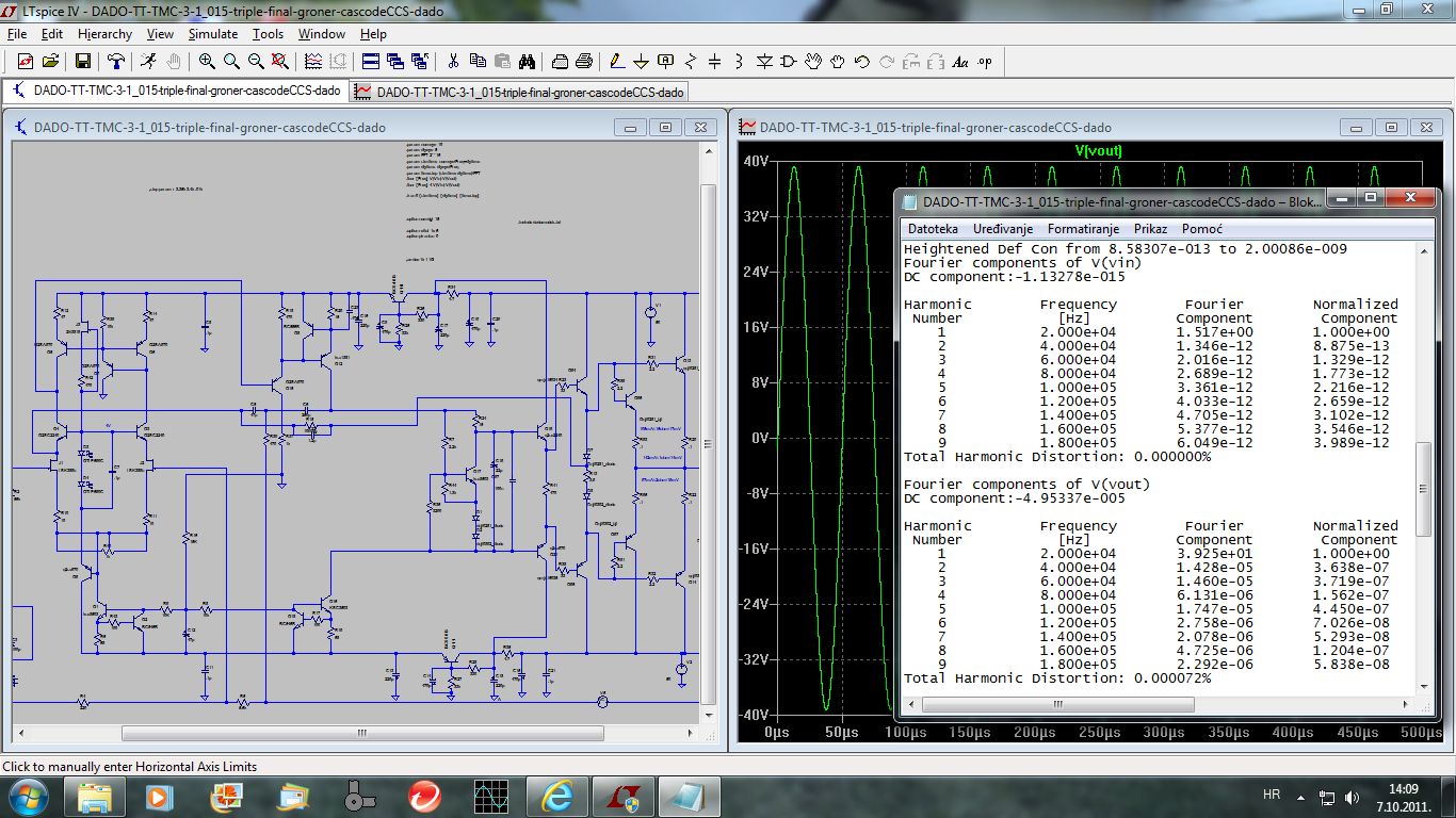

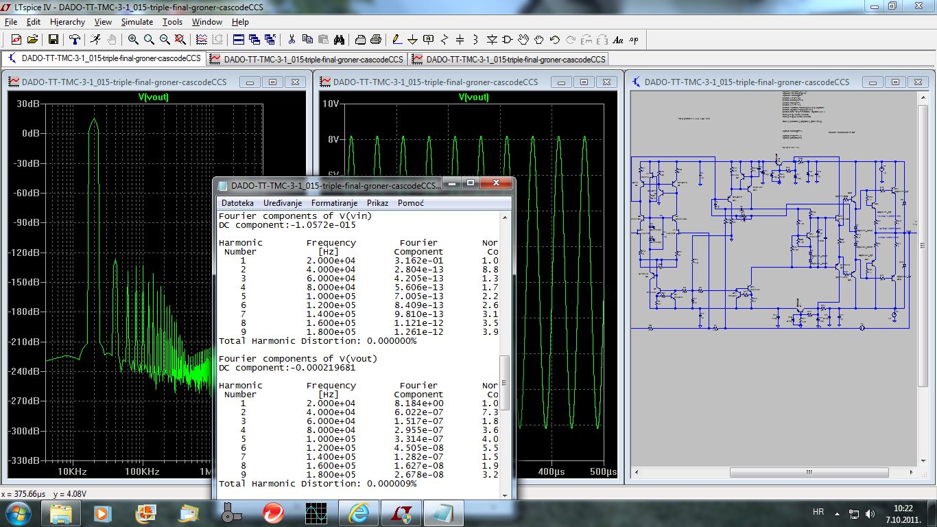

Can you prove that? Show some simulation. Do you need distortion lower then I showed in my post, and with simple TMC at that?

Distortion in SPICE is highly misleading, bordering on completely useless.
No need for Mike to prove and/or substantiate anything, as "his semiconductor physics background is beyond reproach" 🙄
E.
OK I accept that(without sarcasm), but still how is possible that spice simulation is good enough for EC and not for TMC.
You also use spice simulation to prove your point and what result you get fot EC is acceptable, but for TMC must be wrong??
I appreciate if someone can present real life TMC amp and how good it could be.
I made some TMC amps, but have no means to measure so low distortion.
Soundwise I liked what I've heard.
dado
