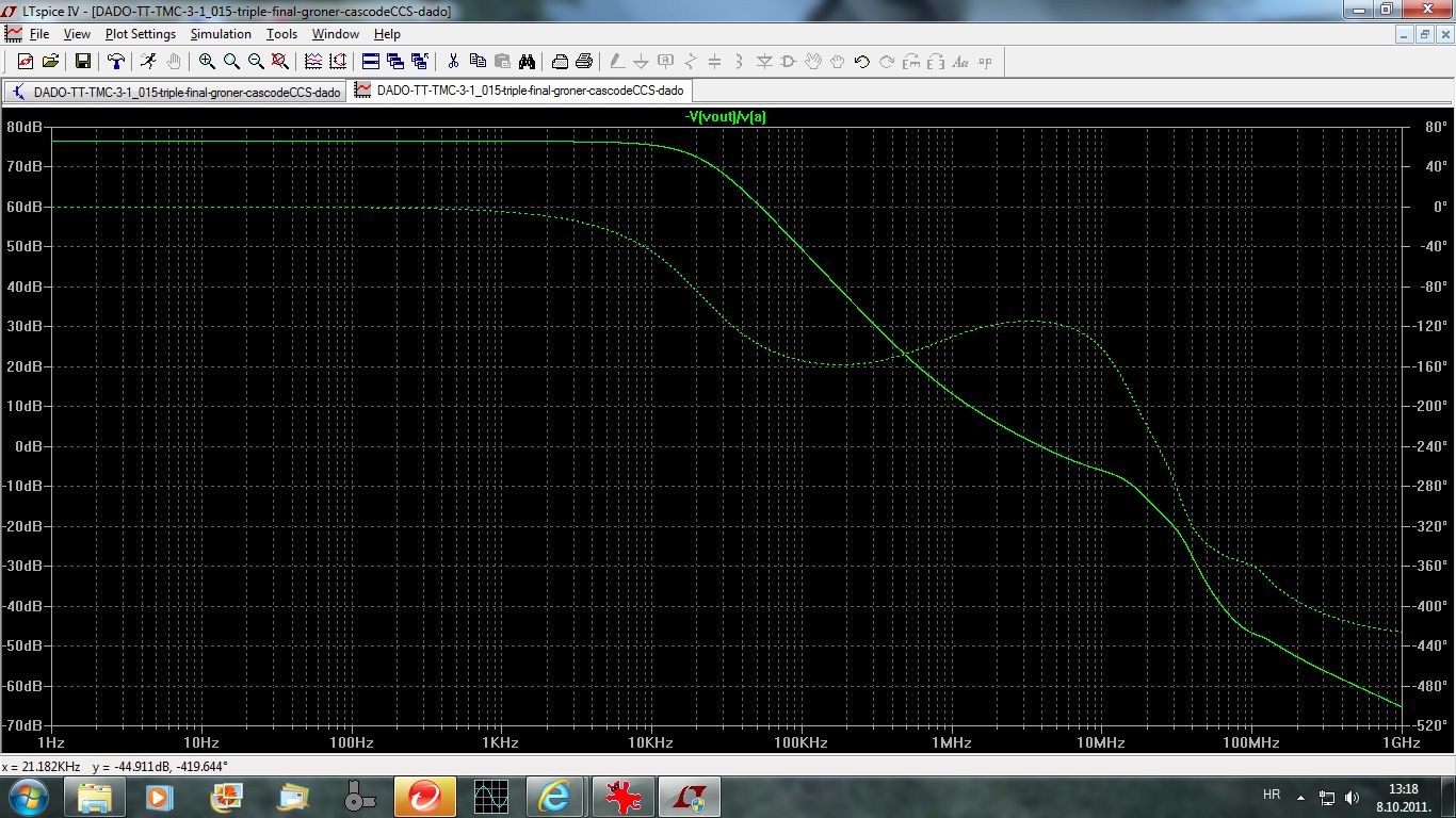

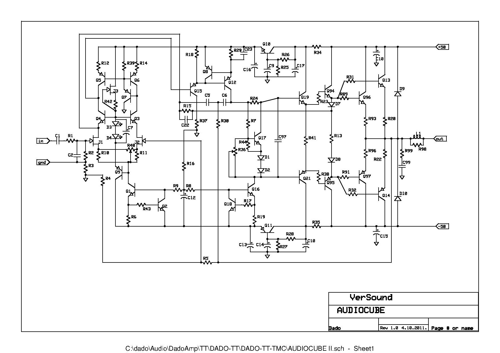

Hi Edmond,
There nothing special in my circuit. I just tried to optimize each state separatelly.
Input state is NFET cascoded LTP with floated cascode.
VAS is buffered, and TMC is connected a bit differently, between LTP and cascode, not between cascode and current mirror. Output state is a Triple.
Loog gain(Negative Feedback) was set to 76dB from 0-10kHz. I did it to get better phase behavior not to lower TIM, I am not the one to believe that wide OLG is better. Not sure about spice models accuracy, I used some from Cordell and some from others from this forum.
If you like I can send you my LTspice files, just I need your email.
regards Dado

Hi Edmond,
regards Dado

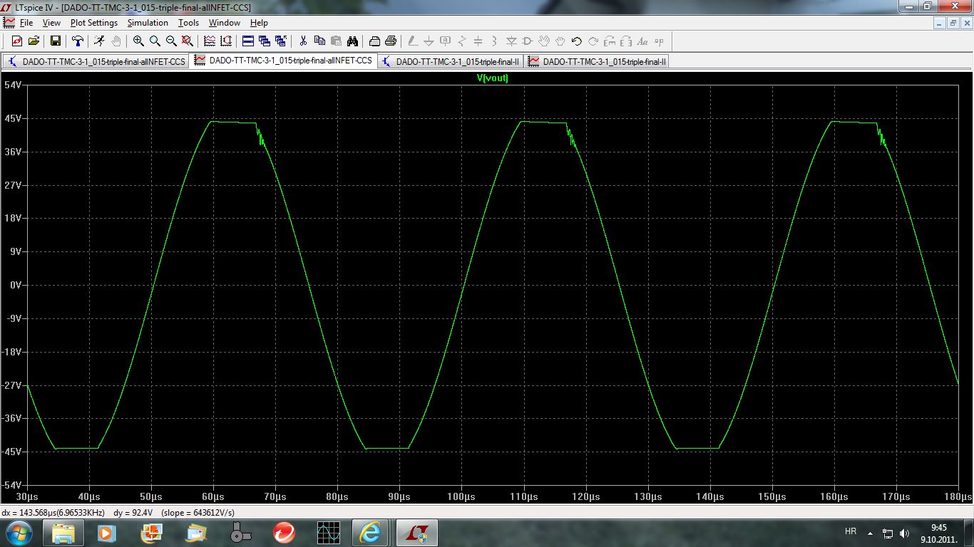

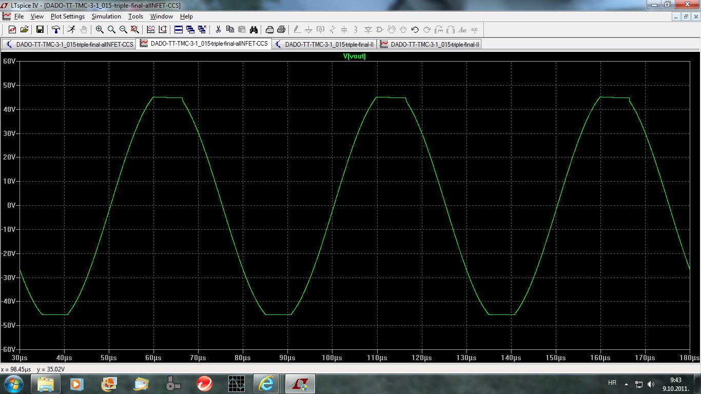

Hello Dado
This may seem like a stupid request but can you clip the amp by driving input with sine wave into 2 and 4 ohm load and see what the overload recovery looks like and post results if possible.
Regards
Arthur
Hello Dado
Regards
Arthur

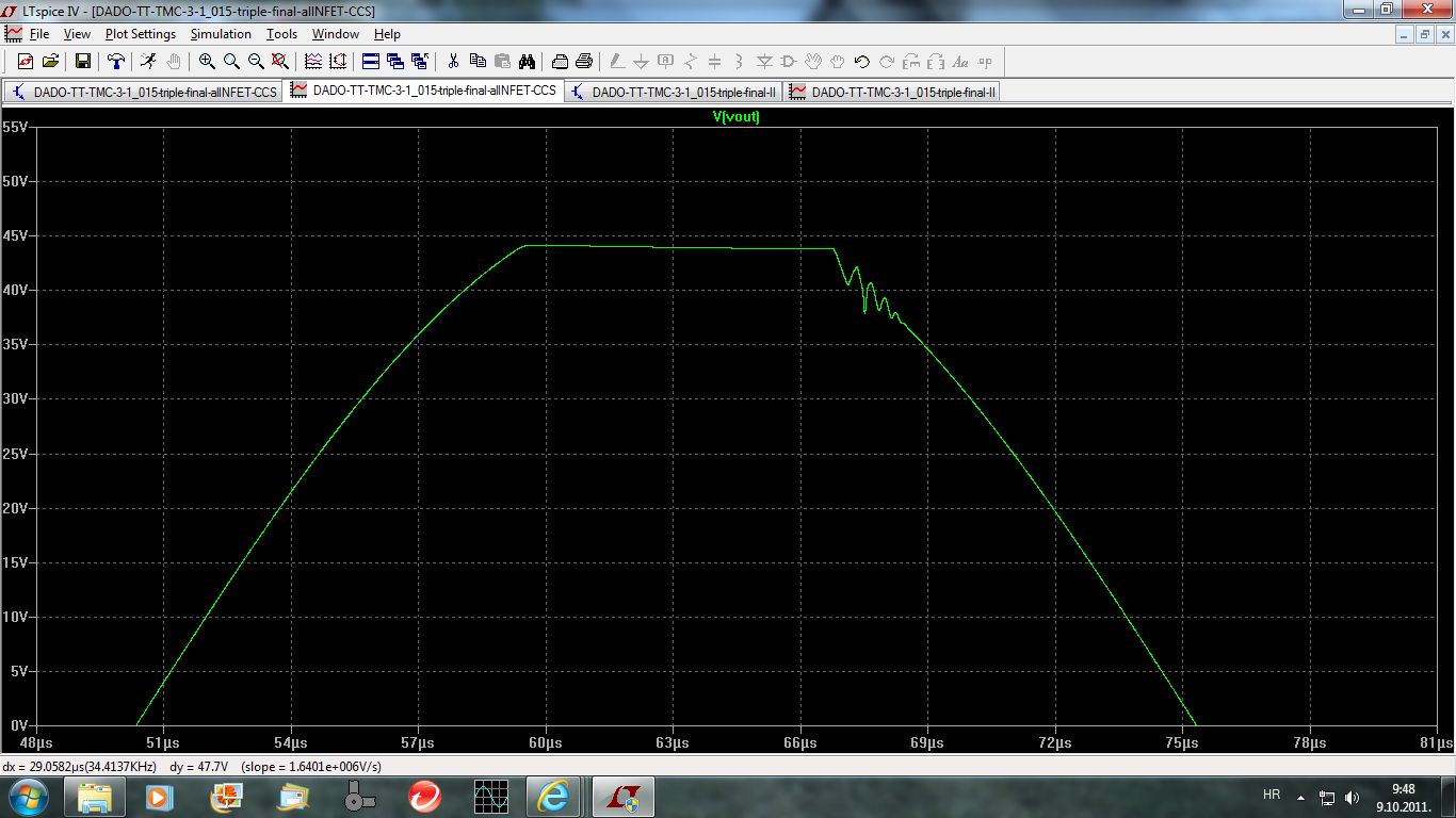

Hi Arthur,
That was not a stupid request, not at all. I can see some small oscilatios when clipped on 2 ohm load.
in this order: 8ohm, 4ohm, last two 2ohm
regards
Dado

I have built the amp and connected to my lab power supply(+-30V, 2A) just to see if there some faults on the PCB. I have to build proper power supply firts(in next weeks) and than I will test it properly. I do not have proper 2ohm load(just 8ohm and 4ohm) specially not for clipping test.
regards
Dado

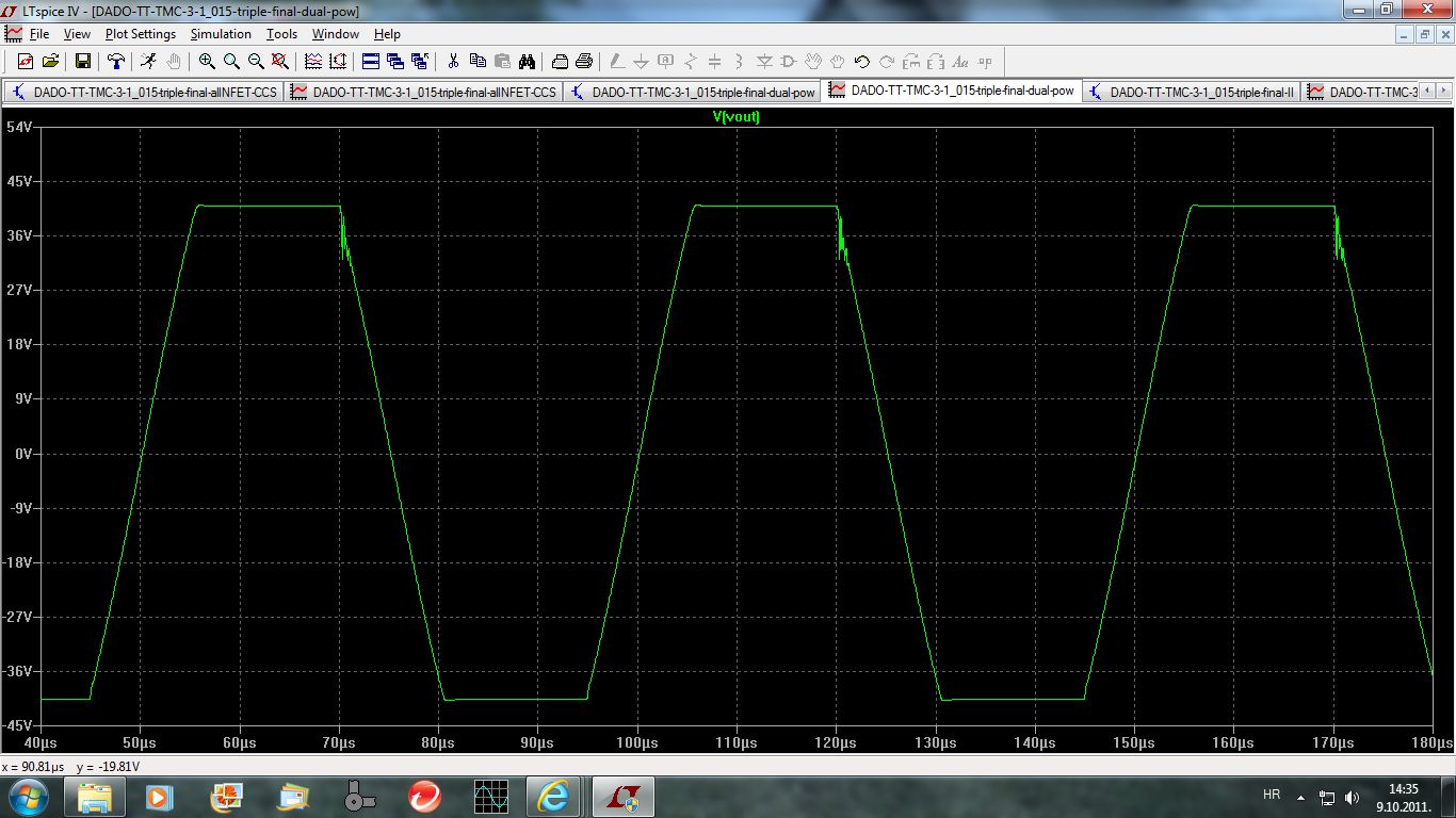

Dad,
is that a little bit of rail hanging on returning from clip @ +ve swing?
If it is then that seems to be what is promoting the sudden step input that gives the +ve return swing the kick into oscillation.
Maybe this is a sign that those anti-clip/saturation diodes might be useful.

AndrewT,
Yes of course there is solution, separated power supply with higher voltage for input state then for output, and use of Backer clamps. I tried it in simulation and it works. To keep it simle for a moment I have one power supply and hope that the clipping will not be to bad, I have to test in real world first. The simulated clipping it tipical for VAS with TMC, not oscilation part of course.
For 2ohm dummy I have to buy a new set of resistors and aditional heathsink. Actually i have now two sets of 15//18omh 50W resistors on the same heathsink(not to big one) so I have 8ohm or when parallel 4ohm load.
Dado

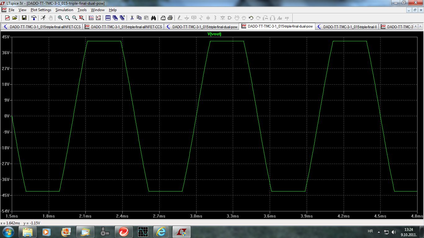

Hello Dado
Is the amp you are simulating with a clamp into 2 ohms and 2 pairs of output or 1 pair of output devices.
What clamp are you using and where is it connected.
Regards
Arthur
Hello Dado
Regards
Arthur
Hello Dado
Regards
Arthur
That was simulated into 6ohm 1kHz. Here is into 2ohm, first one at 20kHz(maybe that is to high frequence for clipping simulation??? the simulation already presented were at 20kHz too).
Firts diagram at 20kHz(oscilation present), and second one at 1kHz(no oscilation) and you can see clamping. Do you have suggestion to improve it?
dado
