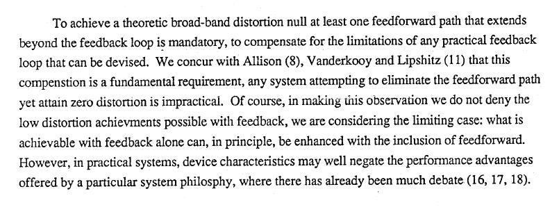

Thanks for the apology, Bob. I should say that I didn't cite this post in my email nor did it or any other posts upset me, including the ones I explicitly referenced in my email. However, I appreciate the sentiment and extend goodwill to you too.
For the reasons I explained in my email I would like to try to stick to objective reasoning.
Now, when I read Hawkford I get a different message. I think Hawksford's original 1981 paper was a little loose in its claims but he went on to tighten it all up in his paper "Towards a Generation of Error Correction Amplifiers" written in 1991:
Hawksford publications
Hawksford does not mix up FB and FF. He understands that error elimination, or nulling, using feedback requires infinite gain and is therefore impractical in both theory and practice when applied to a non-linear, speed limited amplifier.
Hi Brian,
I don't disagree with anything Hawksford has said there. To get a theoretical BROADBAND null, you need feedforward. To get a wonderfully deep and useful minima over the full audio band, all you need is HEC. The theoretical BROADBAND null whereof Hawksford speaks is attainable only in theory with FF EC due to the lack of a perfect summer through which the output power can flow. That's pretty much where I come down on this.
