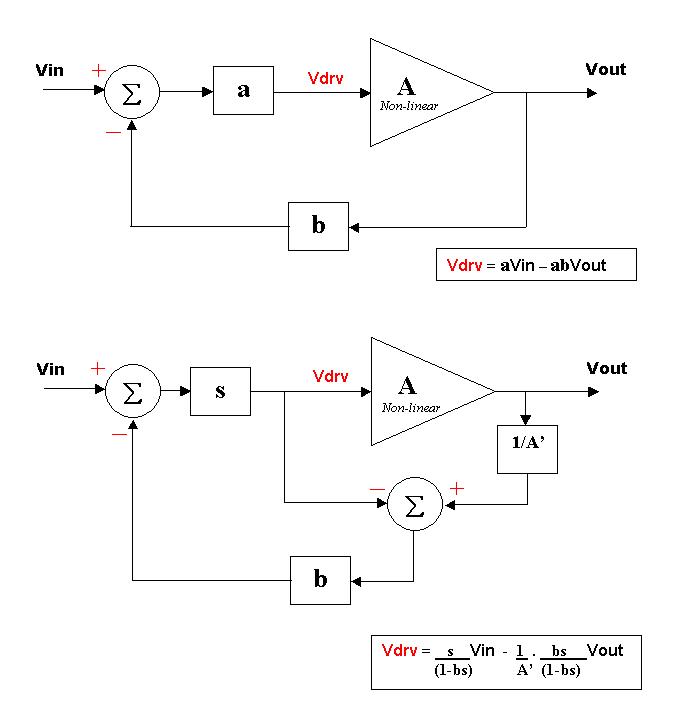

Do the maths, you'll see.
Here it is. Why don't you believe it? The two systems are identical. Either both can cancel or neither can.

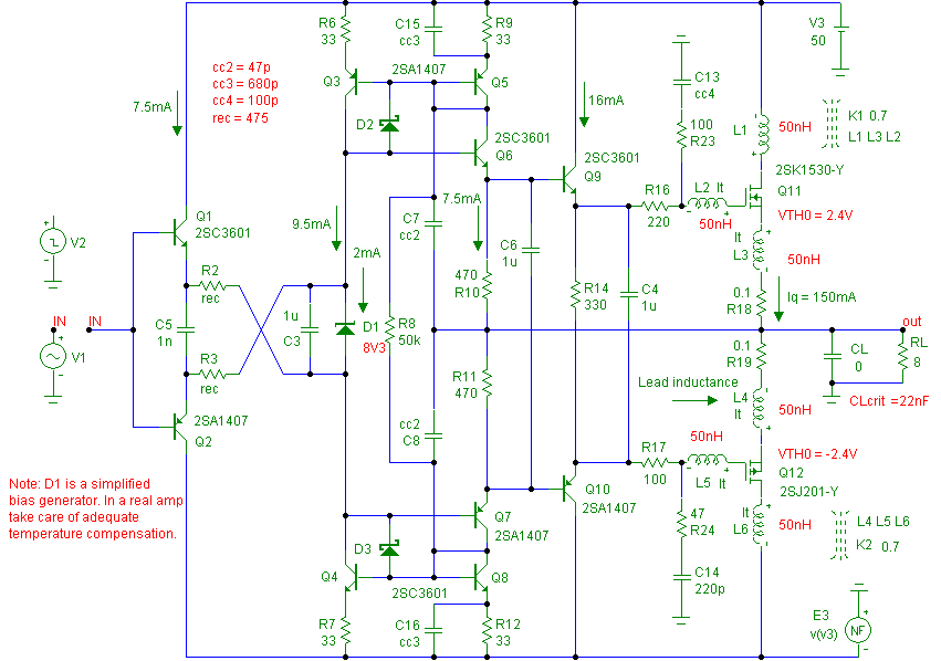

Hi Adam,
Here's a alternative circuit. It differs from HEC in that it doesn't subtract the error signal from the input, in stead, the error signal is inverted first by means of the I-mirrors and then added to the input signal. In doing so, no bias voltage (22V or so) is stolen from the VAS, thus no need for a boosted power supply for the front-end.
OTOH, the output voltage is slightly limited, because the drivers are also fed from the same power supply. But who cares, as the last few volts from a vertical MOSFET are problematic anyhow, as in this region Cgd is sky-rocketing. THD20 = 30ppm (according my sim).
That's certainly very clever.

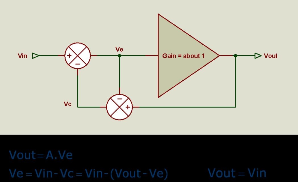

Yes if you built either of the circuits you will find that neither zeros the error. But conceptually, in theory and mathematically, ec CAN zero the error.
Observe: for a nfb circuit, the Vout/Vin = A/(1-B.A) where A is the non-linear gain and B is the fb factor. Normally we all want to make B.A as big as possible by making A as big as possible, so that we can neglect the '1' and the 'A' drops out. But that cannot even in theory and mathematically happpen. The greater you make A, the closer you get, but not quite there. That's why Rodolfo says 'asympthotically' and for me that is the correct word to use.
EC, on the other hand, gives Vout/Vin = 1, without A. A drops out in the theoritical/mathematical concept, so it CAN zero the error. That is why Rodolfo calls it 'cancellation' of the error and again for me that is the correct use of the word. See attached pic.

Jan,
I think you are confusing cancelling the denominator term in the PFB loop gain equation with cancelling the output error.
Both systems are NFB and have identical system equations. Therefore their performance in reducing output error is identical. Of course when infinite forward gain is assumed, which is impossible even in theory with a finite bandwidth amplifer in either case due to stability, then the output error is zero. In this theortically impossible condition you can say both circuits have reduced the error to zero or you can say both circuits have cancelled the error. For the non-cancelling condition, which is the condition ALL stable theorectical and practical circuits find themselves in, both reduce the output error. They are simply NFB loops.
I think you want there to be something superior about HEC in terms of how the output error is corrected but there isn't. The only difference is HEC uses PFB to generate forward gain.
