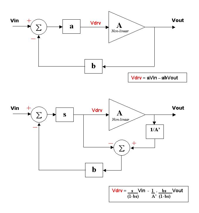

Rodolfo,
Please can you explain this to me? I have redrawn your Fig 1 and Fig 3 slightly so that they can be more easily compared mathmatically. I trust you will find them equivalent to yours in form and that the top diagram is still conventional NFB.
If we conceptually remove the amplifer A from both systems, so that we are considering only the "correction" parts, we can focus on calculating the value of Vdrv from Vi and Vout. I have shown the two equations. You will notice that they are of exactly the same form...in other words, one could simply choose arbitrary constants and make both systems identical.
My problem is this. If both systems have the same characteristic equation for Vdrv then how can one be said to be "asymptotic" and the other said to be "cancelling"?

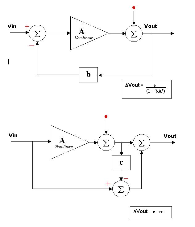

The diagram shows a FB and FF system, both with non-linear amplifier A which are to be corrected. To illustrate the difference in how they deal with distortion I have shown a "small" error, e, added to the amplifier output. I then show the small change in Vout...which is the same as the change in amplifier output. Because A is non-linear we must make e very small.
Feedback: delta Vout = e/(1 + bA')
where A' is the small-signal gain of A.
Feedforward: delta Vout = e - ec
Note that in the FF case setting c=1 cancels the error exactly. Note that the cancellation is independent of A.
In the FB case the error can only be reduced, never cancelled out, and the reduction depends on A.
With FB it is the characteristics of A that limit the amount of theoretical reduction. FB is doomed because it cannot escape from the charateristics of A. Because A is non-linear and has phase shift there will always be a finite limit on the size of b before instability cripples the system.
This is an interesting angle Brian. Your numbers ar right, now look again at the equations.
The first form - conventional NFB, features in the second term the loop gain ab (A has been factored out bt you in both cases) while the second form has in place the equivalent loop gain as shown in my pdf, eqn. [3].
In the limiting case for NFB, you can make this loop gain infinite making the front end gain a infinite, this is what I call asymptotic correction.
In the second case, you can make the loop gain infinite making 1-bs=0 instead, and I call this cancellation.
It is beyond dispute both that infinite gain a, or exact cancellation 1-bs=0 are unreachable. In fact for the error correction scheme, I clearly stated in the pdf that there is not even danger of 1-bs=0 for any frequency except DC, inasmuch as b being usually a passive network (b < 1) implies s > 1 i.e. active therefore with at least one pole, in turn implying a non null imaginary part for any nonzero frequency. True cancellation is consequently not possible but asymptotically for DC.
Another form of looking at cancellation is substituting in eqn. [2] in the pdf, BS=1. System gain then colapses to A'S - independent of A - which was the main objective, to slave an imperfect power stage to a passive or low level high quality stage.

Rodolfo,
I think I'm getting closer to understanding of what you mean by cancellation.
You agree that the two Vdrv equations are of the same form, so from the point of view of the amplifier A the two systems are the same? Therefore, it must be that any characteristic of A is being treated identically in the two cases. So either they are both cancelling or they are both asymptoting.
How can it be otherwise?
It would appear to me that your identification of cancellation is independent of the input signal to A. In other words, you are taking into account only the behaviour of the correction network.
If (1-bs) is finite is there still "cancellation" going on?
Duh!
This proves nothing we did not know already.
Yes, Brian, if you have an ideal summer at the output, feedforward error correction is better than HEC, and theoretically perfect.
Why don't you do some work on that output summer.
Bob
traderbam said:
.... So either they are both cancelling or they are both asymptoting.
Brian, this is precisely the issue with you from the begining. It was never in discussion both topologies are equivalent inasmuch it is possible to arrive to a functionally identical system description.
The differences in viewpoint are that with NFB one substracts an output sample from the input and finds out system improves with larger loop gain. With EC on the other hand, one definitely extracts only the error, but reckons this cannot be done (*) perfectly for any frequency except DC.
Rodolfo
They are equivalent?
Then why in your paper do you say that the difference between NFB and EC is that one asymptotes and one cancels?
Is it not the case that they BOTH asymptote until the special condition is reached, a=infinity and 1-bs = 0 (both equivalent to infinite forward gain) when output error is zero?
Whether, in the unachievable special case when the output error is zero, you call this "canellation" or you call it "reduction" is immaterial.
Am I Right?
traderbam said:
....Then why in your paper do you say that the difference between NFB and EC is that one asymptotes and one cancels?....
Because in EC one first computes the error (scaled output - input) and in NFB not. The topologies are inherently different no matter whether the end result is the same.
You can make an active 2nd. order filter Sallen Key, or state variable, different topologies same result. Why is it there exist different versions? Because at implementation time, one may be advantageous over the other in a particular context.
Brian, I am afraid little more can be said at this time and it is my belief other members may start to find this discussion boring, I am dropping it if you allow me.
Rodolfo
That's fine, Rodolfo.
You are saying that the topology of the feedback network is different and this impacts he circuit design.
You are also saying that the system behaviour is identical. There is no difference between conventional NFB and EC feedback.
I agree.
This is not how I initially interpreted the wording of your paper.
I suggest that it is the system behaviour that the readers of this thread are firstly concerned with, as the purpose is to correct erors in the system behaviour. And it is at the system level that the erroneous assertion that the two systems are different has been argued by others.
That's all.
