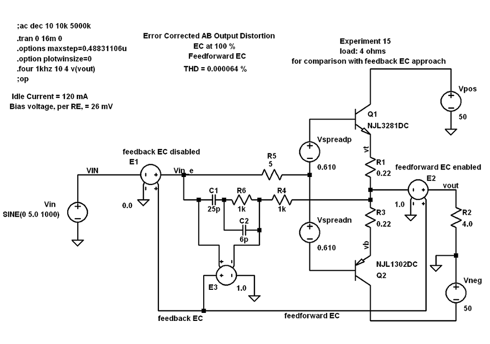

HEC and Feedforward EC data
For reference, below is the simulation diagram of the circuit I used to compare feedback error correction (HEC) and feedforward error correction. The error in both cases is derived at the output of summer E3. Its input contains the frequency compensation necessary for proper operation of HEC. C2 represents the fact that the summer must have finite bandwidth. The derived error from E3 is either fed back (disabled in this schematic by gain of Summer E1 = 0), or fed forward to summer E2.
The output stage is built with ThermalTrak RET transistors with 0.22 RE and biased at a drop of 26 mV, for an idle current of 120 mA. The output stage is operated into a 4 ohms load at a voltage of 5 V peak at 1 kHz, near where crossover distortion is highest.
In subsequent posts I'll show some of the performance characteristics.
Bob

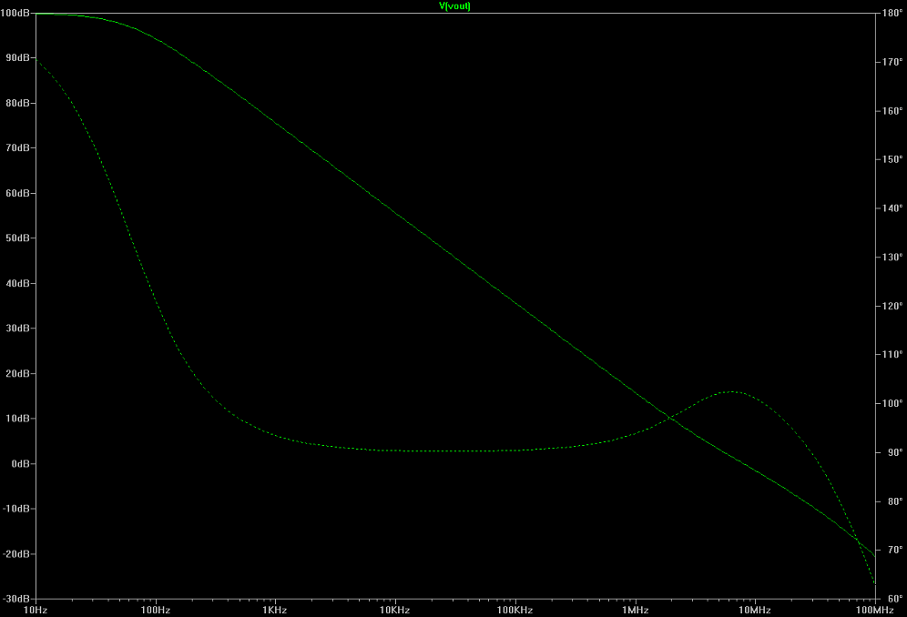

Here is the measured loop gain of the HEC circuit. The feedback loop was broken between the output stage output and the input to the E2 summer. A 100 Meg resistor in combination with the 1 k series resistor from the output stage (R4) provided DC stability and is what limits the loop gain to 100 dB at frequencies below 10 Hz.
This picture of loop gain illustrates the "feedback view" of HEC.
Bob

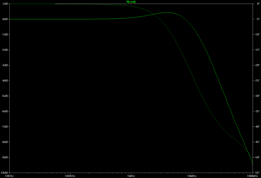

This graph shows the error-corrected frequency response of the output stage. 3 dB bandwidth is 22 MHz. Peaking is 0.4 dB. Curiously, this same peaking showed up in the frequency response of the feedforward stage, so it appears not to represent peaking due to the NFB process.
At 1 MHz, where one might cross over a global feedback loop around this stage in an amplifier, gain is +0.1 dB and phase lag is 0nly 0.8 degrees.
Bob

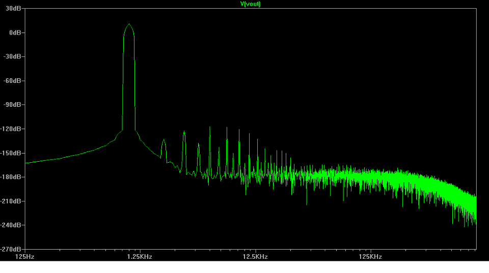

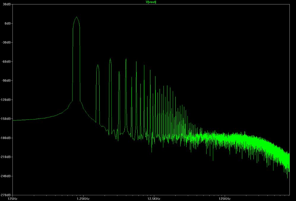

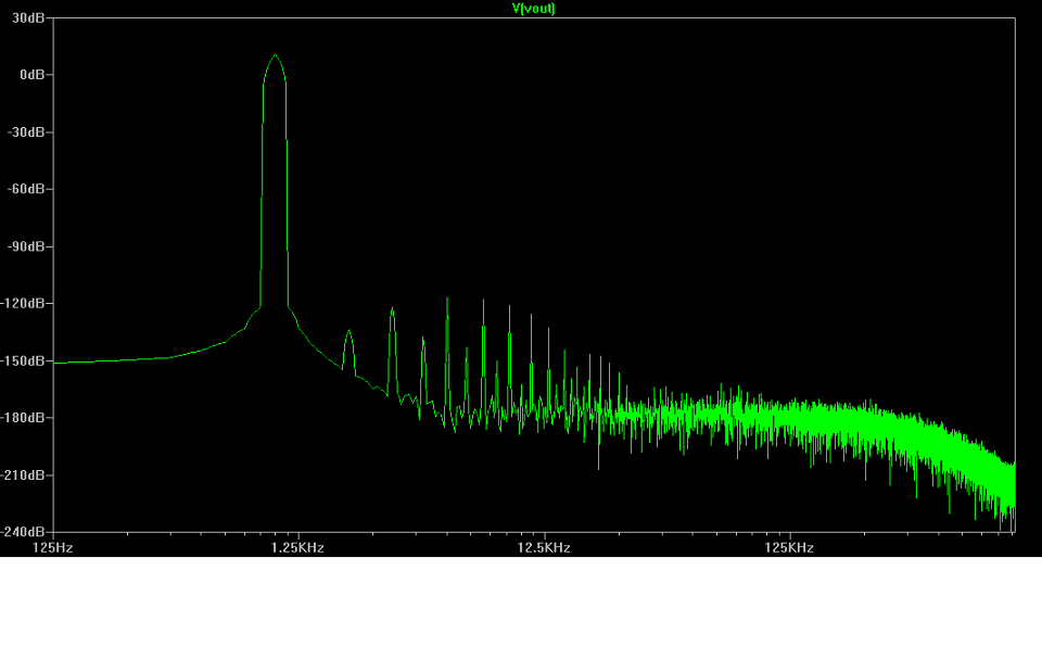

Need to see a cleaner Spice simulation for the FFT (see attached). Have you got the FFT without any correction circuit?
What is your justification for slugging the FF? The whole point about FF vs FB is that FF not only cancels but needs no compensation whatsoever.
Hi Brian,
The FFT of the uncorrected stage is shown below.
My FFT is perfectly fine, although I was lazy in letting the scale go all the way down to -270 dB, revealing trash that your FFT did't show as it cut off at 160 dB. We're not talking about who can plot better FFTs here, anyway.
Brian, I think you have lost sight of the reason that I presented this. What I was trying to show was that the HEC and feedforward have a lot in common when they are compered apples to apples - an amazing lot! That is why I applied the same error signal rolloff to both.
I was NOT trying to show that HEC is as good as pure, ideal, simulated EC. It is not, and I have said that before. Pure feedforward EC will win every time in a simulation like this. But that is academic, since the required output summer to do so is virtually impossible to realize in the real world without adding in quite a bit of distortion itself. I am surprized that point was lost on you.
The compensation I am using for the HEC is not "slugging" it, but it is on the conservative side. Again, I was not trying to gandstand and show how great HEC is, but rather to demonstrate its similarities in behavior to feedforward EC. The circuit I showed is actually quite stable down to much lower values of compensating capacitance.
Bob
