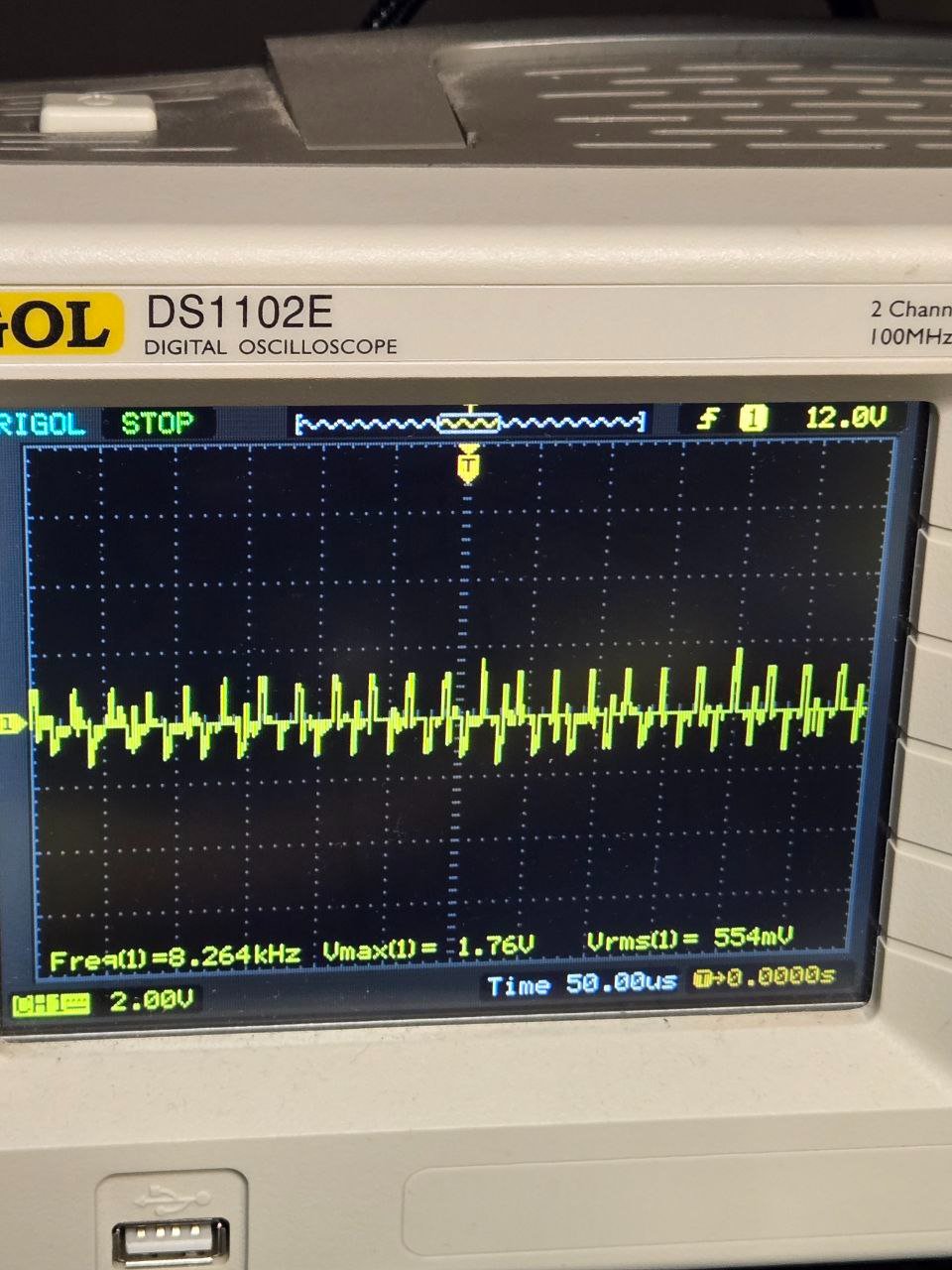

I think I'd replace the driver IC, in case it was damaged. Lift the 1.5k resistors to break the output of the drive from the main circuit. Does that give you low-side drive?

Ok I will replace with another 2184 and give it a test. Is there a way to know if the TL072 or LM211 is faulty ? Yes these parts were ordered through Mouser. I will try lifting the resistors. Just to go over the process I performed to see if I got low side drive. I connected the ground probe of the battery powered oscilloscope to the negative rail and probed pin 4 of the ir2184. Also probed the input pads of the TL4452 (no fets fitted). I tried dial in a signal using auto mode and also manually and tested with both DC / AC coupling to no avail. Thanks for the help perry I really do appreciate it.

Double checked again and the LM211 is still functioning correctly with voltage swinging. What is feeding the input of the 2184 ? I'm guessing the output of the lm211 goes thru a few buffer transistors ??
Are the waveforms on the high-side drive and the input approximately 50% duty cycle?
Are you checking on the actual low-side output terminal of the IC or some other point?
with the 1.5k resistors soldered back it measures the same as before. I have not test high side drive yet, the high side has its TC4452's installed the lowside does not I am waiting for them to show up. Yes I am probing pin 4 of the IRS2184 as listed in the data sheet also have probed both sides of the 1.5k resistor

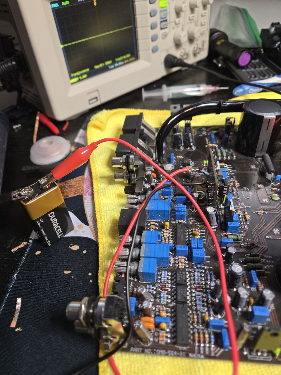

2. Can you please instruct me how to properly power the high side with a 9v battery, I remember you mentioned a trick to do it before ?
The 9v battery needs to be fully charged. Confirm 9v+
Connect
Vs to the negative terminal of the battery
VB to the positive terminal of the battery
If you have a 1 ohm 1/8 or 1/4w resistor, connect it in series with the battery.
Connect
