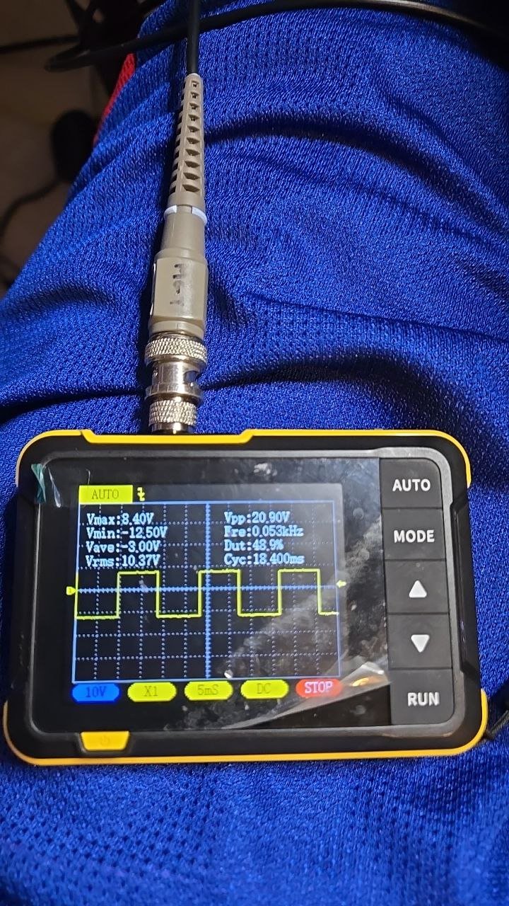

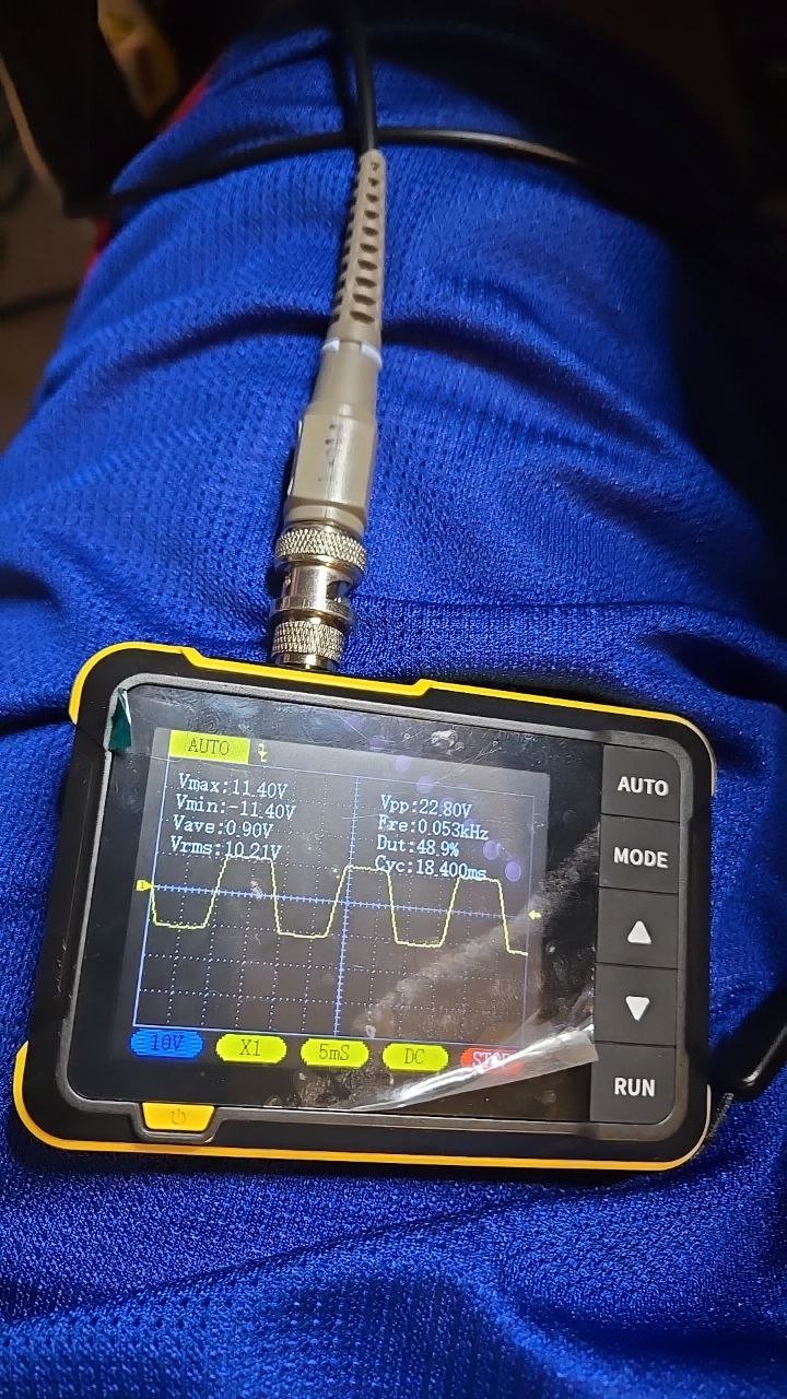

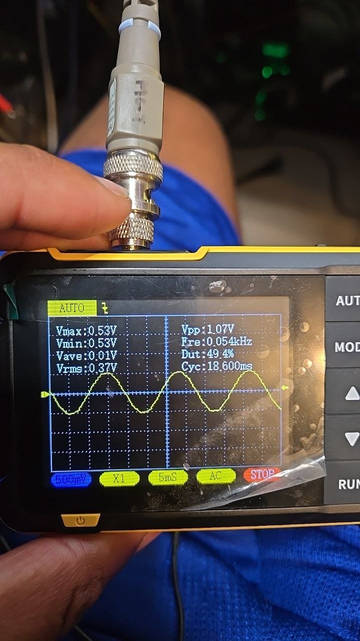

When injecting 53hz signal to rca I get the following
1. 53hz square wave pin 1 of IRS2184
2. 53 HZ square wave on LO output from IRS2184
2. 53hz square wave on pin 7 of LM211
3. 53 HZ square wave on 072c Pin 7 / Clean since wave 50hz with 10k feedback resistor connected
4. Nothing on highside output,
Seems it is getting signal all the way through the chain up to pin 1 on the irs2184 and out to the LO side gate. I notice no difference on the HO when applying the 9v strangely enough . Does a square wave on the LO out indicate a good low side drive signal ( is it possible the amp needs rca input sig to generate low side drive?

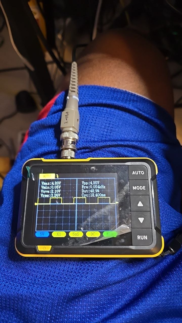

Yes using the battery powered scope, when I apply power to the 2184 while driving a signal into the amp is just see the HO output go high but no square wave .
Is this with the negative scope probe on the negative terminal of the 9v battery and the positive (probe tip) on the HO terminal of the 2184?
