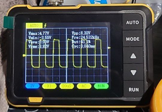

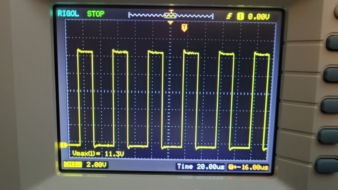

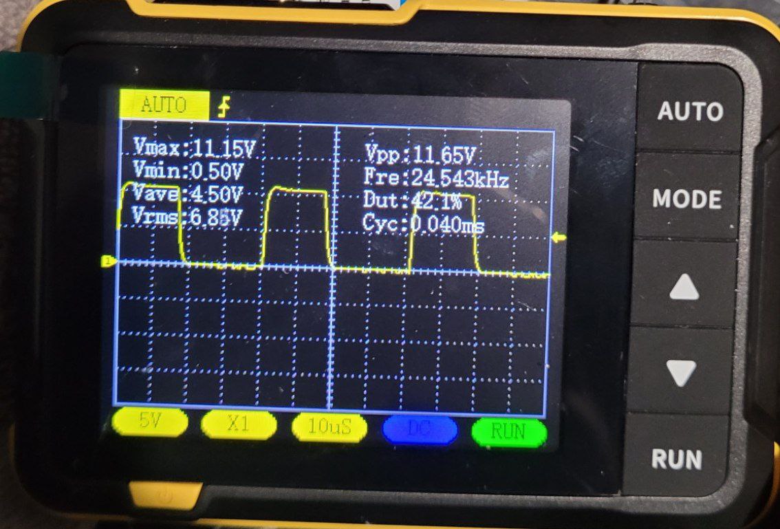

Thanks for the info, I am not able to test any voltages on the output at this moment, some traces were damaged and have been doing some repairs on that before I power up the Output section again. I had a chance to load down the drive signal on the PS today with the capacitor you recommended and the drive signal looks good so I'll start populating the mosfets again and report back about the output section voltages. I had some spare 22ohm +- 1% resistors laying around so swapped the gate resistors out anyway. Here a pic of the signal while loaded down, I have the amp current limited on a power supply set to 9v for testing right now. Thanks ! 🙂 I appreciate all the info I have been taking notes,
The 9v I was referring too was for something else. You can test the supply at 13.5v (or something close to normal).
The voltage on the drivers for the power supply should have an amplitude of nearly the B+ supply voltage. I don't know why you're getting just over 4v. Test at higher B+ voltage to see if the amplitude goes higher (and near B+ in amplitude.

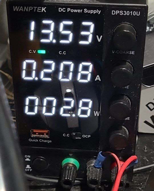

Some amps won't power up at less than 10.5v due to low-voltage protection. With no FETs in the circuit, there is very little that could be damaged.

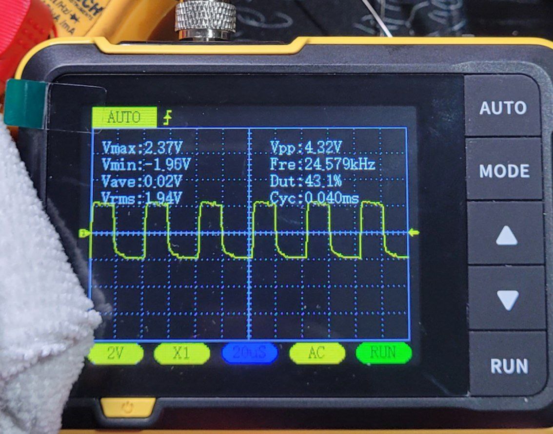

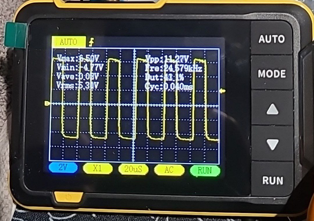

Oh okay thank you for that info I thought because they rate the amp usually around 9v min that would be okay. I upped the voltage to 13.5 as suggested and the drive signal looks a bit better, I also included pic of it at 10.5v for reference.

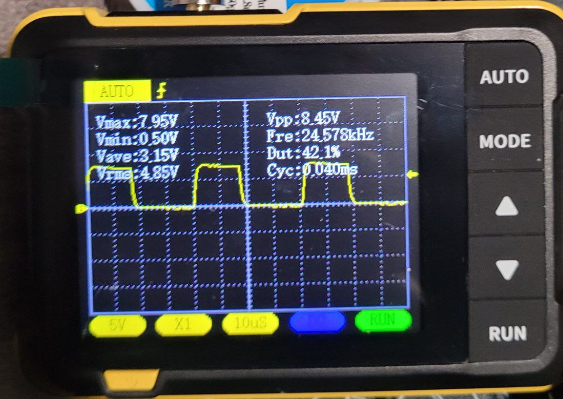

I believe in #29 both were different input voltages. Here is a photo with a 13.5v input. I have yet to populate the PS section with mosfets, I was mostly inquiring about the High side drive signal for when they come in and I can power the amp up partially.
No outputs yet, was doing research to see if I could drop in the 24n50F's with no modifications to the circuit but it doesnt look plausible so I will be ordering the stock 24n40f's. I do not believe it was taken using differential mode. just probing the gate on the ps mosfet pads with a 13.5v input going to the amp.

Do you have low-side drive from the audio driver IC? You'll either need to use differential mode or use a high vertical amplifier setting. You need to use DC coupling for the waveforms to be of any use.

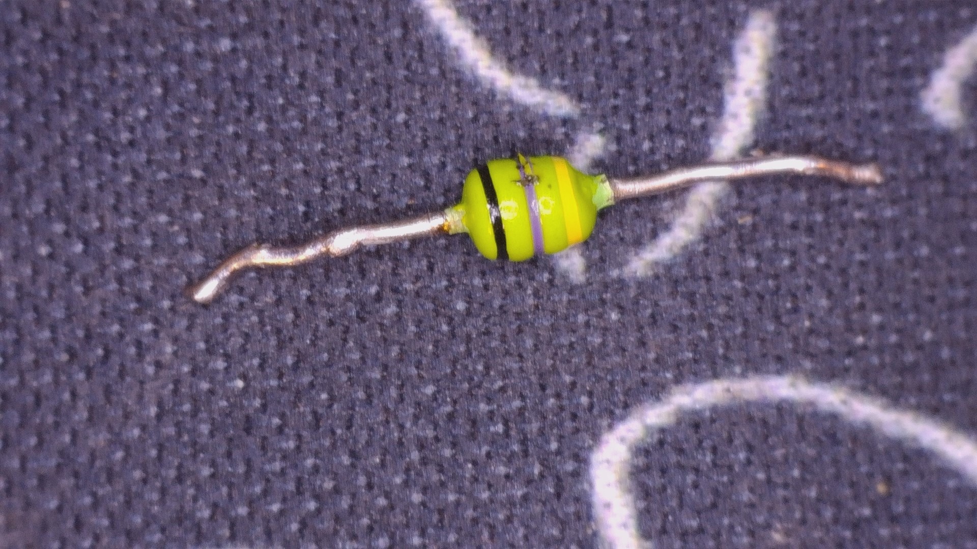

Do you know what this component value this component is labeled L5 on the board? I believe it is an inductor but i haven't seen many with only 3 bands. This inductor was feeding voltage into a DIODE network that fed the 12v regulator?.

47uH inductor. They typically read about 3-5 ohms.
OK, I do have a second probe I will test with that. Ok this part was OL will replace. Is the inductor a 1w part?
Wattage? That's not generally an inductor spec. Someone will correct me if I'm wrong.
Someone here will have a good part number but I don't have anything.
Order the same size (or as large that will fit for the lead spacing). Find one in the 3-5 ohm range.
