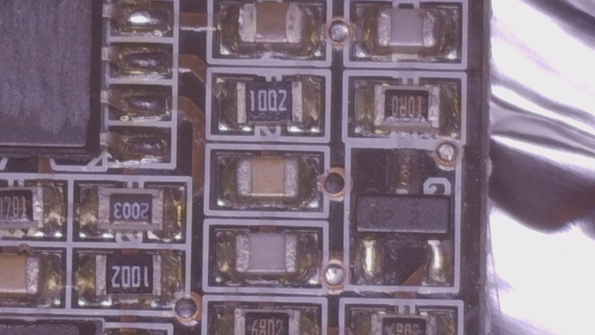

IT has been replaced no worries. Working on the driver card and will be replacing the IR2184, LM211 just in case but I also found the transistor labeled 6P to the right of the LM211 is measuring 24 ohm between the collector and emitter . Do you know the appropriate replacement parts for the smd transistor labeled 6p. A bit of research shows it as an N channel jfet but this fellow replaces it with BCX 71J E6433 just wanted a bit of advice before proceeding

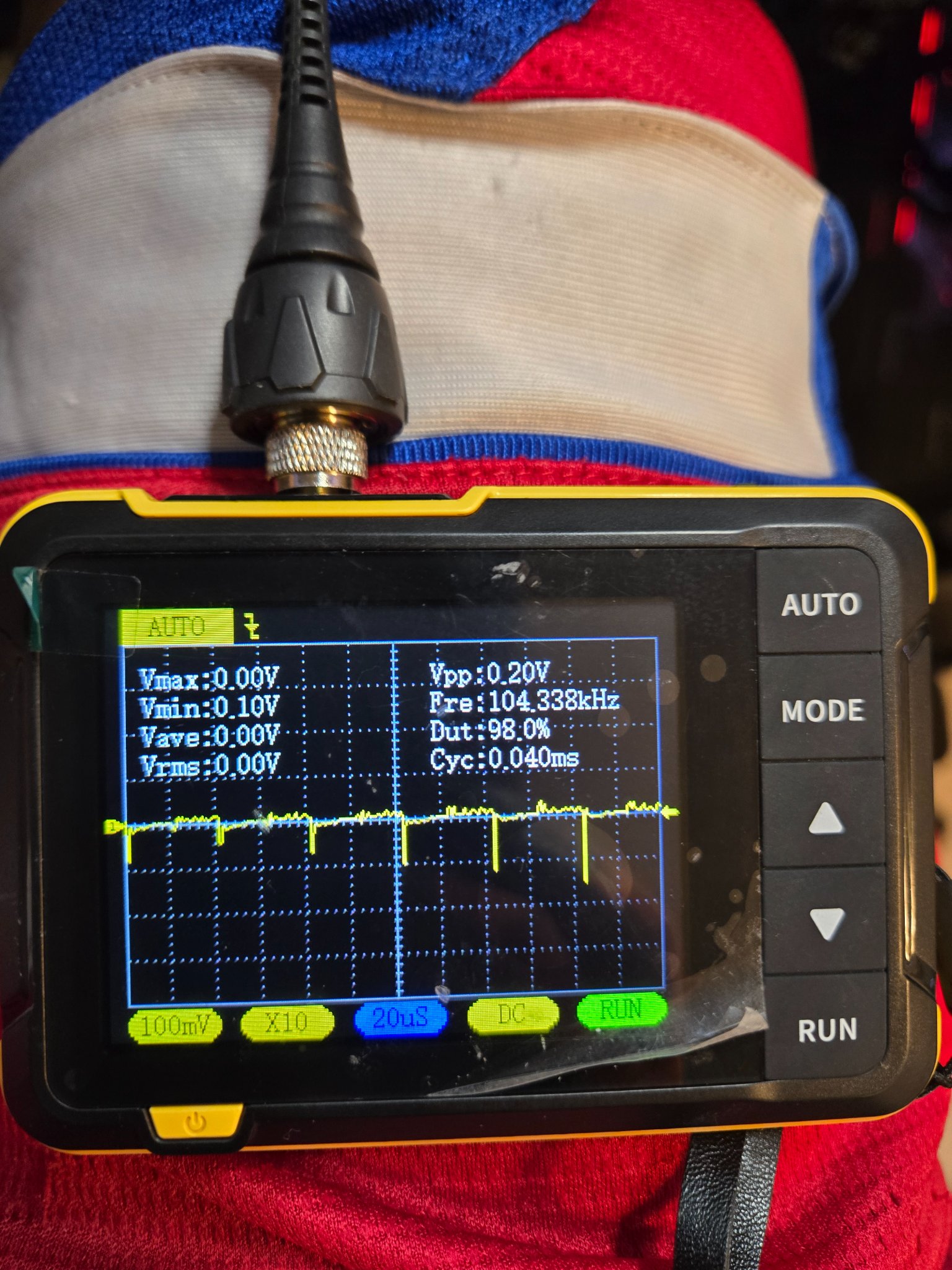

Its so strange no drive wave on the LO of the 2184 probed this with negative rail as a reference (o scope negative probe) with the battery powered oscilloscope, no matter time division/ voltage Div I couldn't locate a drive signal. , will check Pin 7 on the TL072 next, when checking this pin did you want me to reference to ground ?

Do you have a square wave on pin 1 of the 2184? Amplitude?
With no signal going into the amp no square wave on pin1 also nothing on pins 1 and 7 of the lm211. The best I have to inject a signal is a tablet
