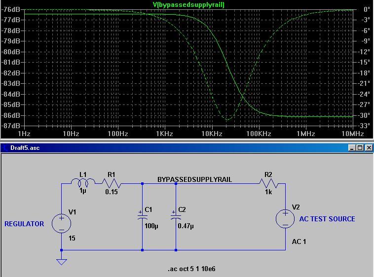

Don't forget that any high frequency supply rail bypassing on whatever this regulator may be used to power could set it off into oscillation. For instance audio circuitry using wide bandwidth opamps which require such bypassing.
A small series inductance may be required here. You can often pick an inductor (such as those common ones that look like 1W carbon resistors) with moderate series resistance to dampen (critically or greater) the series resonance.
You then have to wave good bye to your milliohm output impedance though :bawling:
Glen

If the applied test voltage is 20Vac then the peak currents being injected and extracted from the PSU are ~+-28mApk .i.e. 30Vdc across 1k0
If this applies, then the CCS must be set to pass ~>= [2 * Ipk] + Iq.
for 28mApk, then CCS=72mA just meets this requirement, but is it a requirement for the test?
