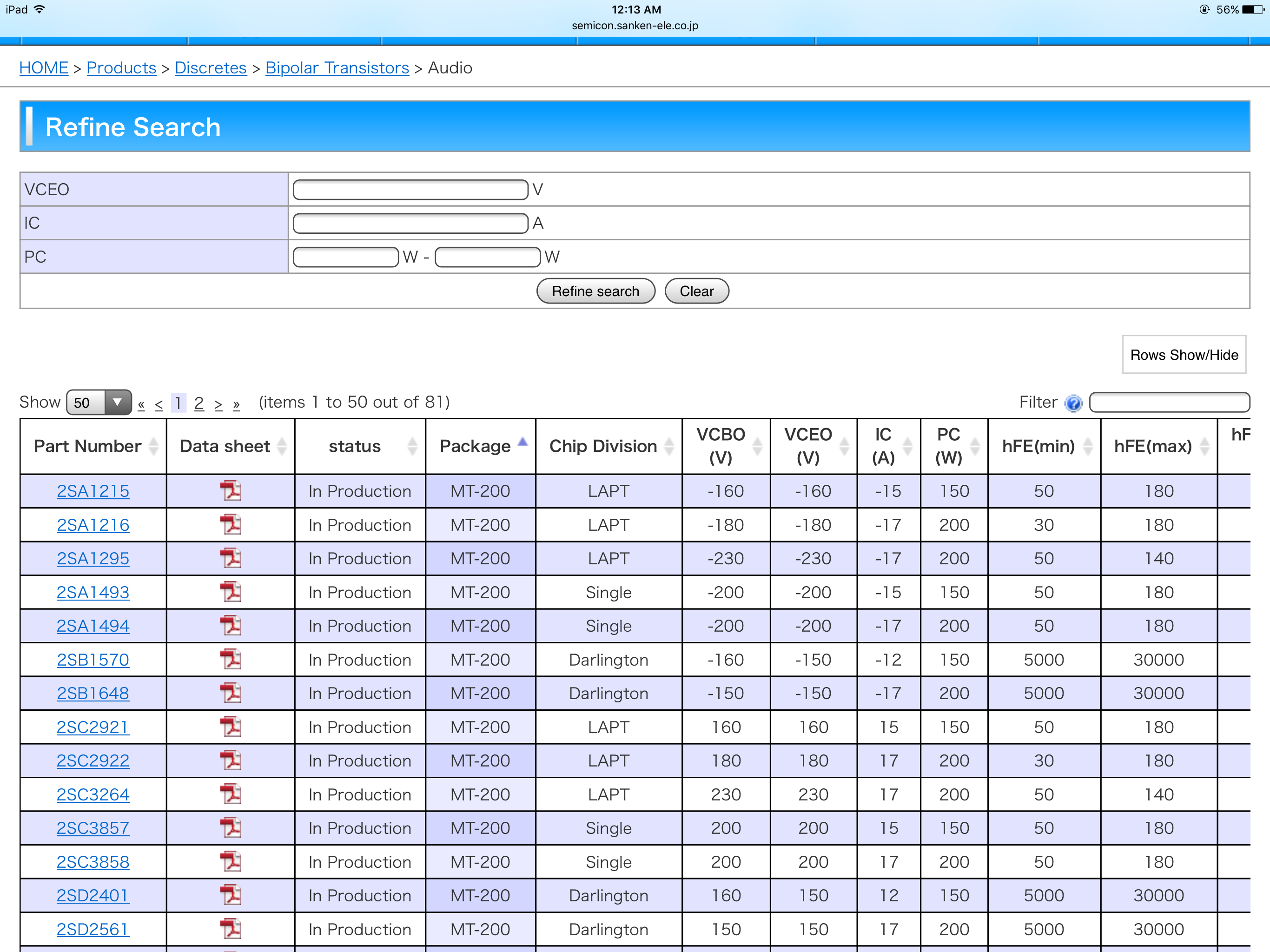

according the presently available line-up of audio power devices there are some new versions - OTOH the ones in MT-200 outline are not longer listet - go to
Audio |Sanken Electric
most interesting types for replace a lot of no longer available output devices seems to be this:
http://www.semicon.sanken-ele.co.jp/sk_content/2sa2151a_ds_en.pdf
http://www.semicon.sanken-ele.co.jp/sk_content/2sc6011a_ds_en.pdf

This is correct according this image underAs I know, the 2SC3519 and the 2SA1386 pair use same die as the 2SC2922/2SA1216.
Sajti

The die is attached to a TO3P type heatsink which is in turn bonded to a larger heatsink contact face (therefore a MT200 outline).
The abbreviation "LAPT" confuses me.
Under
2SA2223 - Power Transistor -260V -15A (Master Part)
I read LAPT (High frequency multi emitter transistor)
Under
http://www.semicon.sanken-ele.co.jp/sk_content/2sa2223a_ds_en.pdf
there is to read this:
LAPT (Linear Amplifier Power Transistor)
And under
Sanken audio components at Profusion
is mentioned this definition
LAPT (Large Area Parallel Transistor)
Only the last mentioned definition I know - go to
http://www.profusionplc.com/brands/sanken
and post 11 under
How many transistors inside 2SA1302/2SC3281 ?
so as post #2 under
The skinny on Sanken 2SA1216 Epitaxials
MT200 devices have been obsoleted with the advent of the newer generation thin die LAPT. The die geometry and electrical performance is the same but the thinner silicon makes it possible to dissipate MT200-like power in a MT100 case. Since the MT200 has become unique to Sanken, it is probably a large factor in the cost of a transistor, and also probably an increasing percentage of the price.
