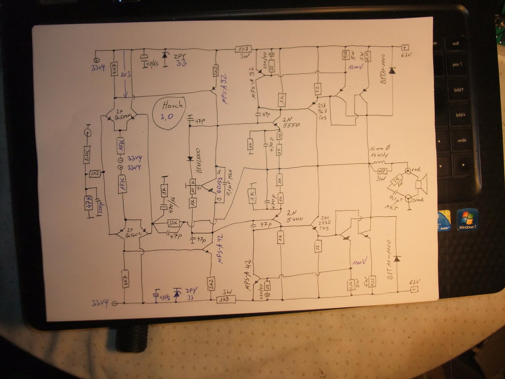

The output buffer is executed as compound (Sziklai-) darlington.
From this point of view, the ST version with a higher value for Ft would be the better choice.
Unfortunately I don't know currently available successors for this obsolete type.
Is there a possibility to find out, what type is in use through certainly measurements by a transistor tester ?
The Sziklai doesn’t preclude using 3-5 MHz outputs - the latest one I built used TIP35/6. The drivers are very important. What does your amp use for drivers? With modern sustained-beta types regular ON outputs work fine. The 21193/4 is the best match to the faster flatter Jap outputs. Slower yes, but at least the gain is flat up to around 5-8 amps before it tanks. And what supply voltage?

The output buffer consist of three stages (triplet, last stage two pairs in parallel mode - go to the attached circuit diagram).
2N5550/2N5400 - 2SA968/2SC2238 - two pairs in TO-3 outline and in parallel mode and abraded type designation.

Oh no, not just a sziklai - an output stage with GAIN! Going to be finicky. To make these work, the drivers (the TO-5’s) need to be VERY fast with low output capacitance. Putting in bigger ones there to deal with lower speed outputs often doesn’t work at all.
When I see these circuits I just want to hit someone. If it was an EF or run of the mill unity gain Sziklai I wouldn’t be worried about it not working at all, and I would say they are non critical. Not here at all , unfortunately. I would be looking for ways to get TO3-P’s in there, and considering LAPTs. And even then youll probably still fight stability to some degree.
