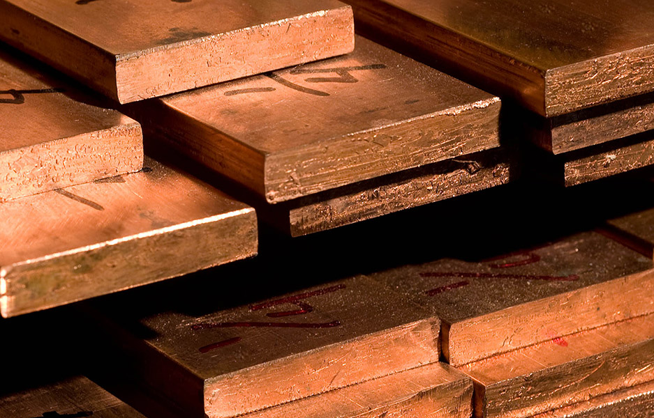

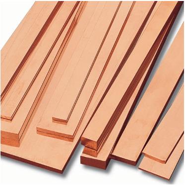

In the meantime there are a lot of SMD outlines for power transistors.
The TO-252 (DPAK) discrete power BjT devices mounted on copper bar elements in parallel mode allows extrem robust properties regard safe operating aera.
What about this?
Are there any experiences?
Here various datasheets of good known types, but in today's prefer outline
http://www.st.com/internet/com/TECHNICAL_RESOURCES/TECHNICAL_LITERATURE/DATASHEET/CD00000828.pdf
http://www.st.com/internet/com/TECHNICAL_RESOURCES/TECHNICAL_LITERATURE/DATASHEET/CD00000829.pdf
http://www.st.com/internet/com/TECHNICAL_RESOURCES/TECHNICAL_LITERATURE/DATASHEET/CD00000831.pdf
http://www.st.com/internet/com/TECHNICAL_RESOURCES/TECHNICAL_LITERATURE/DATASHEET/CD00164144.pdf
http://www.st.com/internet/com/TECHNICAL_RESOURCES/TECHNICAL_LITERATURE/DATASHEET/CD00158496.pdf
http://www.st.com/internet/com/TECHNICAL_RESOURCES/TECHNICAL_LITERATURE/DATASHEET/CD00161335.pdf
http://www.st.com/internet/com/TECHNICAL_RESOURCES/TECHNICAL_LITERATURE/DATASHEET/CD00001311.pdf
http://www.st.com/internet/com/TECHNICAL_RESOURCES/TECHNICAL_LITERATURE/DATASHEET/CD00000830.pdf
http://www.st.com/internet/com/TECHNICAL_RESOURCES/TECHNICAL_LITERATURE/DATASHEET/CD00000833.pdf
This parts are suited both for solder the die carrier of the BjT on the copper-bar and for mounting the copper-bar on a big heatsink like this:
http://pictures.xbox-scene.com/xbox360/cpu/heatsink4-2.jpg
copper-bars:
Buy Copper and Brass Brass angle,1m L 1x1x1/8in RS 16525Q online from RS for next day delivery.
Welding Electrode and Materials of Taiwan Da Jie is a Welder Electrode and Material Manufacture
http://www.cut2sizemetals.com/images/products/detail/kbr-6.jpg
http://image.made-in-china.com/2f0j00gMwtinLyCEfq/Copper-Bar.jpg
