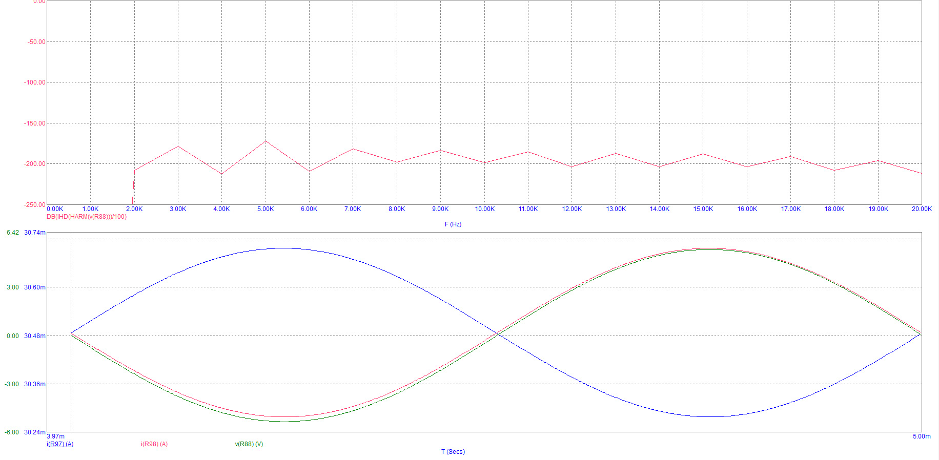

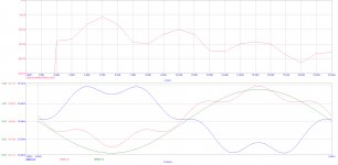

Simulation of my bridge amp in Microcap12
Up: Harmonics
Down: Green is output voltage, red and blue are currents through VAS legs.
NFB may change the distribution of EXISTING nonlinearties but it CAN NOT INVENT nonlinearities (either dynamical or static) not yet presents in circuit. This is another key point that Lumba Ogir miss... Of course! 🙂
