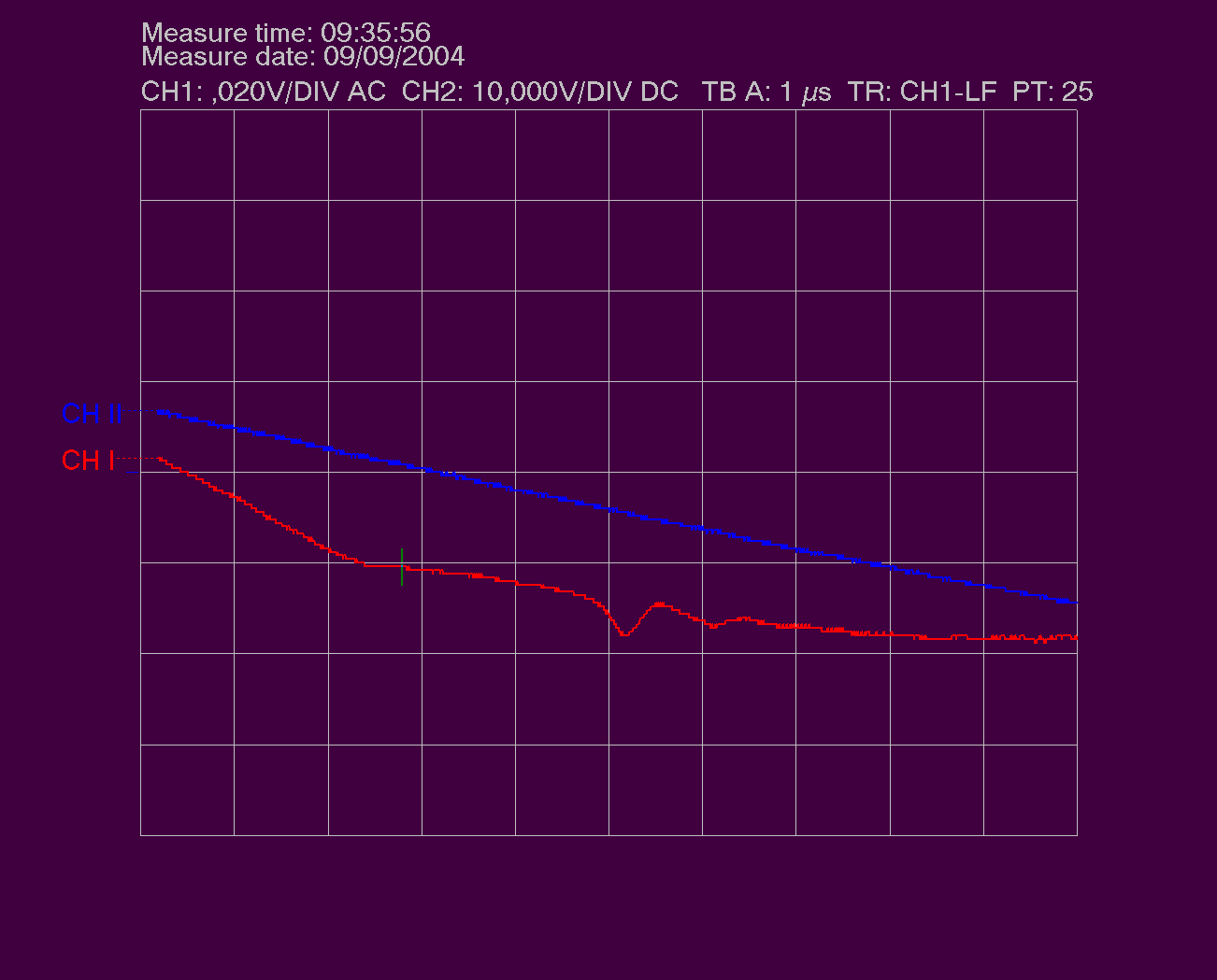

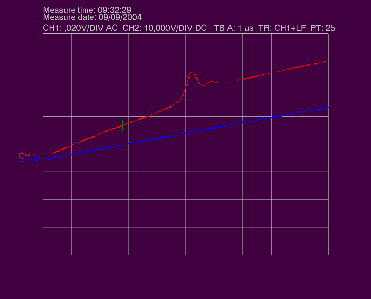

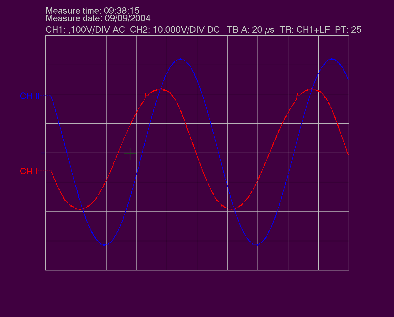

These are oscilloscope captures from a typical class AB circuit with composite VAS, optimum bias, class A drivers, switching speed-up capacitor across the bases of output devices, low inductance emitter resistors, low inductance layout, etc...
The VAS is driving BD139/BD140, then TIP35C/TIP36C at 4 ohm and 10khz.
CH1 is VAS current, mostly dominated by VAS compensation capacitor current, but revealing the non linearities due to switching. Nowadays I would have taken the effort to remove capacitor current in order to show output stage non linearity more clearly. Increasing or decreasing bias resulted in worse waveforms.
CH2 is output voltage.
The 4Mhz Ft of output devices is noticeable But with a bad layout with high inductances and inductive output resistors it could be much worse...
Note that this is 5 year old work.

there´s not much I like about Douglas Self`s views, the theory of optimally biased class B is not an exception. Besides switching distortion, crossover distortion consists of a large number of components, most of them device-specific. Resistances in the base-emitter path stabilize some variables, a lower Vbe excursion improves the generally poor Vbe/Ice relationship, but increase the switching time, thereby crossover distortion. Output stages should be class A biased for normal listening power levels.
The blameless amplifiers necessarily have poor subjective quality and high distortion, even if it´s beyond measurement boundaries, no matter how many chapters are written in support of the opposite. The open-loop properties set the pertinent values, the rest is a bubble. Disconnect the closed-loop and make your measurements, an amplifier is never better than its open-loop.
Resistance in the base-emitter path makes switching worse, or at least slower.
Switching behaviour of bipolar transistors is not that hard to understand (at least when you have used them for plain switching and fine tuned these circuits). Base-emitter capacitances when some collector current is being conducted becomes quite high due to charge storage. Real world current gain is strongly time dependent and is low in the low current region for some devices.
When output current is increasing from negative to positive in order to shift from PNP to NPN and the less than 1A or so IC is reached, current gain starts to roll off so base current does not fall linearly with output current, then current crosses zero and a positive current pulse is required to remove the remaining charge stored in PNP b-e junction and store some charge in NPN b-e junction. Then, current gain starts as unity and gradually increases to DC gain within a few microseconds depending on Ft of output devices. And vice-versa.
Fast local error correction at the input of the output stage can prevent the voltage amplifier stage from seeing most of that non-linear stuff. However, in the usual amplifier topologies (in which most people has been stuck for ages), the dominant pole compensation of the VAS does the opposite of what would be required for optimum switching, it tries to "reconstruct" the expected output waveform at the input of the output stage, where spikes *must* exist due to the nature of class AB, rather than at amplifier output.
The inductance of output resistors, transistor packages and PCB traces also plays a role, a voltage equal to L*di/dt appears across these inductances. The base current spikes result also in voltage spikes due to these inductances. But this is not necessarily a terrible thing, for example, in class D amplifiers I use this parasitic inductance (mostly from TO-220 packages due to the chip capacitors directly from TO-220 leads to power planes) to get a regulated di/dt, the rate at which current rises and falls, regardless of supply voltage and temperature.
I wish most people writing here had some background on high speed switching electronics. Simulating linear circuits does not tell about many details.
