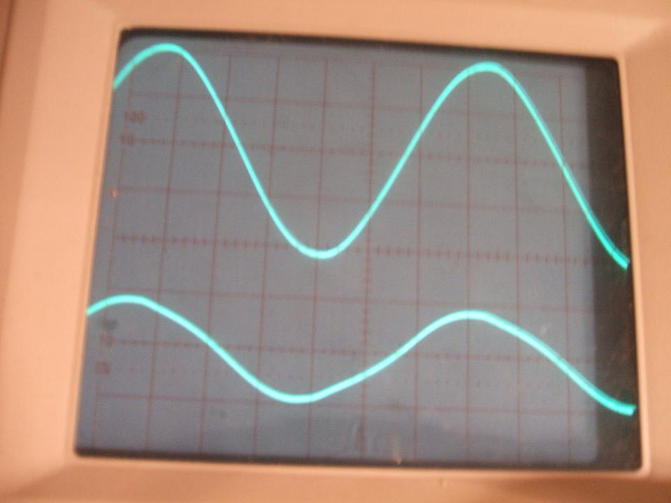

Has anyone seen the base current waveforms of the output devices in a class AB output stage while sourcing/sinking high current at anything but bass frequencies? They usually look horribly distorted, with turn on and turn off spikes and 25%-50% non-linearity. And I don't mean in simulation, I mean probing in prototypes.
Hi
This is a good point. The distorted drive waveforms really throw a kink in the transfer function wrt the "wire with gain" goal, and conventional feedback is not going to eliminate all of this distortion at the output.
For example, you can see the gate drive with all of the distortion, or rather the error that is corrected for in these waveforms from my EC fet amp...(the sine wave is the output )100KHz and 200KHz
The errors are exaggerated in the fast signal, but at audio frequencies, they are still there.

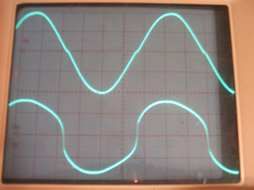

As for crossover, the drive distortions are specific. The attached photo shows the output waveform (30KHz) of a heavy class B bias OPS and the difference from the output signal or rather the 'error' signal, required at the gates to produce it. Notice the slope of the EC drive signal around the crossover notch, and the distortion is still visible at the output. This is the 'error' Eva is referring too pertaining to crossover switching. The relatively limited BW of the global closed loop prevents correction of much of the switching distortion, which is where high BW local feedback/feedforward comes into play. The second photo is with 300mA of bias, yet the distortion is still there as indicated by the change in slope of the error signal around crossover. As you can see even with significant bias, crossover switching distortion is still an issue.
