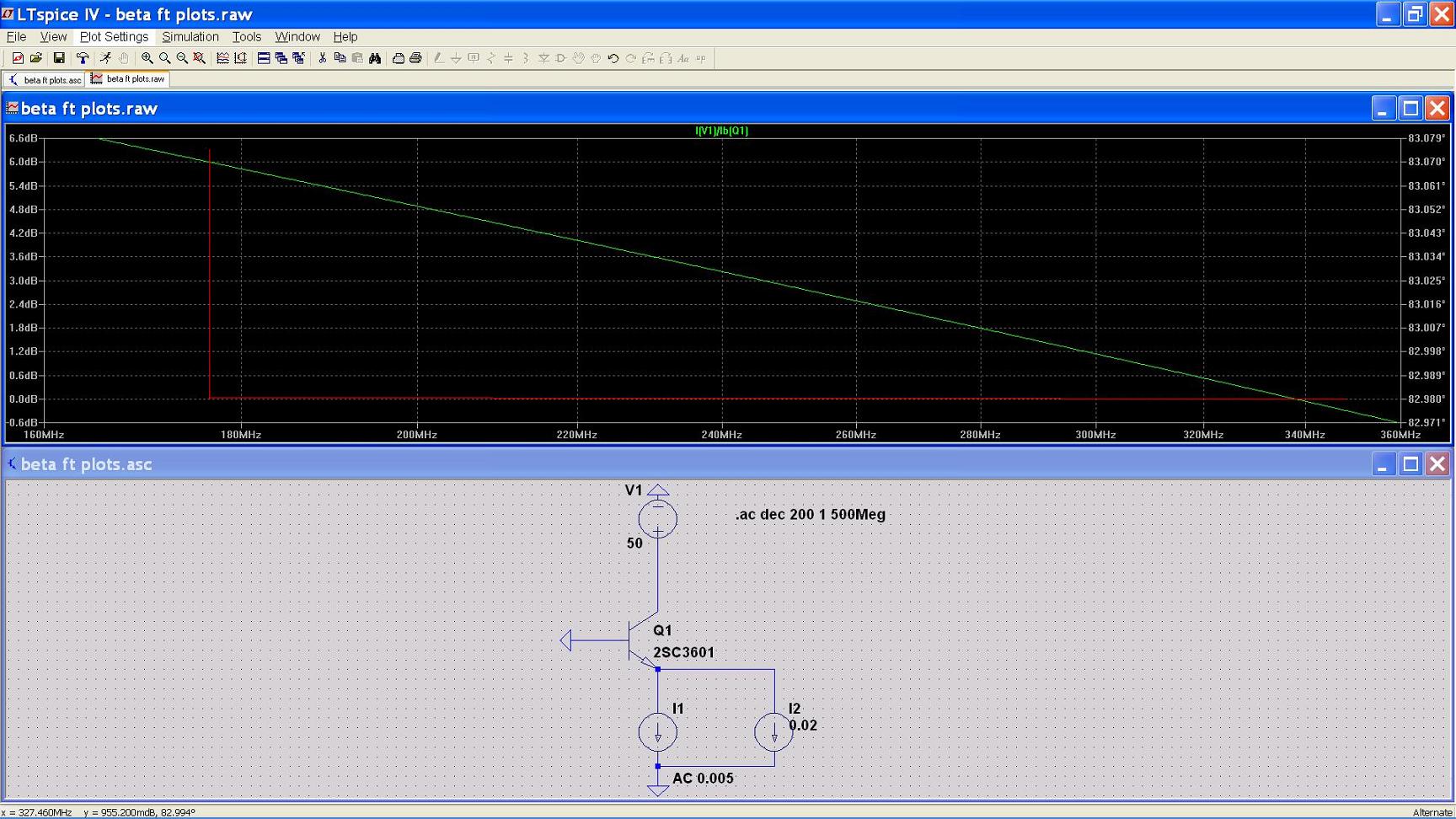

To measure fT though, you'll need to look at the current gain Ic(Q1)/Ib(Q1), not voltage gain, and you'll need to set R2 (the collector resistor) to zero in your schematic. This is because hfe is defined as Ic/Ib with the AC component of the collector and emitter voltages set to zero. One need not excite the circuit with a current source to measure current gain. A voltage source will work just fine. Just enter Ic(Q1)/Ib(Q1) as the expression to plot. This works fine even with voltage source drive. I don't know about the other models, but if you use mine, the value of fT you compute should be pretty close to the corresponding fT value of the datasheet as long as the collector current is not too large (< 5A or so), and the Vce value is the same as the datasheet.
Another way of doing this is to put a voltage source at the base with a DC value of zero and an AC value of 1. At the emitter, use a DC current source of a value almost the same as the desired collector current. Bypass this current source with a very large capacitor, say 1 Farad, to ground. Connect the collector to the DC bias supply with no collector resistor. Then sweep the AC base voltage over frequency and plot Ic(Q1)/Ib(Q1) vs. frequency.

Here is a I(V1)/Ib(Q1) plot showing ft of 2SC3601 . It looks pretty close to
data sheet and has close to the specified 6dB/Oct beta roll off.
The spice model goes a bit astray in other areas though. If you increase
collector voltage the beta just increases almost in direct proportion (at
lower frequencies).
Secondly if you decrease collector voltage to saturated region, beta 'knee'
is a lot sharper and at a much lower vce than reality.
