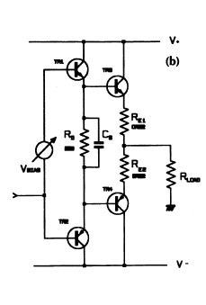

You can do it this way, old ,well known.. Base can be bias in reverse polarity (if needed), and available currrent is limited only by driver current (e.g 8A for MJE15031/15032). So speedy enough, and measurements show it, e.g. limitatition behaviour at 10kHz (no evidence of "sticking" in limitation), fast recovery.
Yes, the capacitor to help suck-out current is an old and well-known trick. However, consider how big the capacitor needs to be in order to be really effective. You will often find that it needs to be an electrolytic. I have never liked having to resort to this trick, and instead run the drivers hotter AND use devices with higher ft. Maybe some others here would like to comment on their feelings and experiences with this trick.

Mr. Cordell,
I am using resistor between bases of output transistors in order 33-47 ohm, so drivers are running at higher bias. With paralel capacitor about 1uF it performs quite well, this capacity seems to be enough. It is needed (in real life, not in testing with 100kHz square at full power) only at short ,fast transients, so here is a lot of time to discharge. This metod seems to me not so expensive (faster power devices with the same SOAR and Pd= more pieces and expensive device), and results are about the same. No crosconduction problems with "slow" MJL , power bandwith to about 200kHz, quite good DIM 100 and IMD19+20 results. Runnig drivers in A class or very near this (e.g resistors to opposite rails) brings (according my experiences) no advantages and improvement.
And I am always measuring performance (whole amplifier) also without load, at different levels and frequencies, to discover what really is caused by output devices.

When you use high fT output devices you generally will also need base stopper resistors and these will severely limit the peak base "suck-out" current, mitigating the advantage to some degree. Suppose you have a crossover region of 2V and 4.7 ohm base stoppers - 2/4.7 = 425mA.
The capacitor trick across the driver bias resistor is much more effective on low fT output stages that can get away without base stopper because of this.
Also, running the drivers hot just doesn't work very well when driving multiple parallel output pairs. Suppose you have a driver bias resistor of 10 ohms, giving a standing bias current of around 130mA. That can be considered reasonably hot.
Suppose the signal voltage is swinging in the negative direction, through the zero crossover. The NPN driver transistor will begin to turn off and the suck-out base current for the NPN power transistor will be provided by the PNP driver transistor, through that 10 ohm resistor.
That 10 ohm resistor ensures that the PNP driver cannot deliver a huge suck-out current. The only real cure here is to bypass it by a big cap, which is simple and effective.
