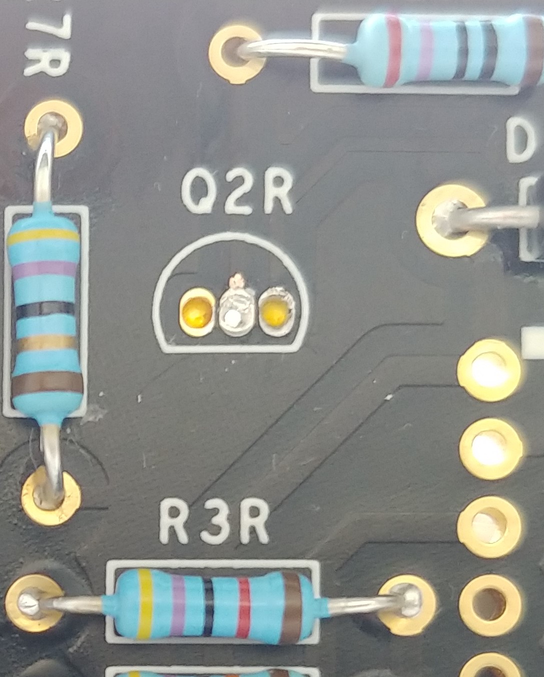

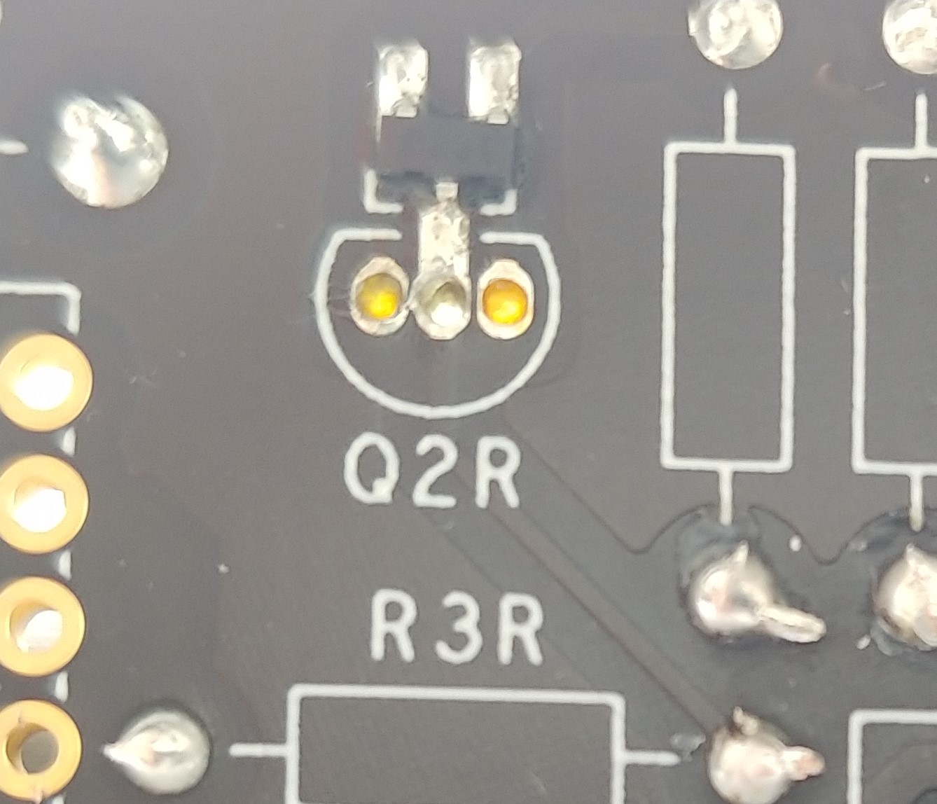

While I was soldering the JFET to Q2R, some solder went to the 3 little holes and now they are not separated anymore. Will this cause trouble? I tried to get solder out of it but the connection between the holes is still there, when measuring with ohmmeter. Comparing to the other side (Q2L), there is no connection.
Yes, you need to get that solder out.While I was soldering the JFET to Q2R, some solder went to the 3 little holes and now they are not separated anymore. Will this cause trouble? I tried to get solder out of it but the connection between the holes is still there, when measuring with ohmmeter. Comparing to the other side (Q2L), there is no connection.
I did the same but managed to clear it with a solder sucker. You could alternatively try solder wick.
I don't have PCB yet but it seems like you could use 2 different types of jfet: surface mounted or through hole and there should be connection between holes for through hole and soldering pads for surface mounted . Looks like your problem is a bit of solder between source and gate , look at the photo on the right and you can clearly see that you have made connection between 2 holes from the left , break this connection and you should be fine no need to remove solder from the inside of the holes .

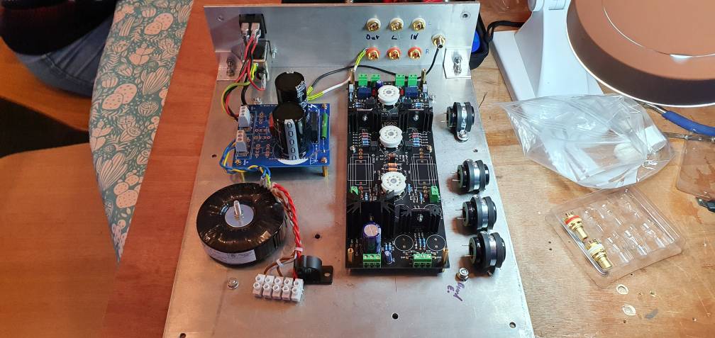

Yes. Power supply is completely on board, only the transformer is off board.
An alternative is to use a 9-0-9 50VA connected for the heaters, then also drive a 24V (12-0-12) to 230V 20VA in reverse from the same 9-0-9 to step back up to around 170V.

Will the transformers spec'd in the attached files work for the two transformer configuration described in the quoted post? I can get these in a week - the China R-core and the Audiophonics toroid are both nearly two months out.
Thanks!
Good thing you asked, I tried this combination with a 24/240 transformer and the high voltage was a little low at 150V AC.
A better combination would be to use a VTP18-1390 as the step up transformer then adjust the final HT on the board by fitting a 1.2 Megohm resistor across C5P on the back of the board.

Awesome, thanks for the great hint, it worked!Looks like your problem is a bit of solder between source and gate , look at the photo on the right and you can clearly see that you have made connection between 2 holes from the left , break this connection and you should be fine no need to remove solder from the inside of the holes .
