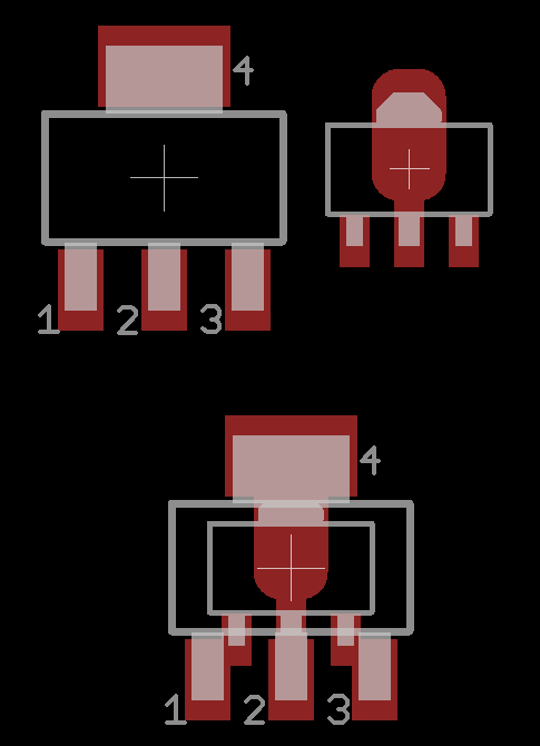

I've just slapped one on the board, and SOT89 is quite a bit smaller. One could indeed place the SOT89 on the original pad, but contact area would be minimal.Just checked data sheet, pads are indeed GDS, with D on 4th so should be compatible if spacing is correct.
Plus there would only be ~0.3mm clearance between the outer pins and the pad for the middle pin. See attached image, the two side by side and then stacked on top.
I also wonder what the reduced size would mean for thermal dissipation.
I can totally play around with the footprint though, and see if a good compromise can be made

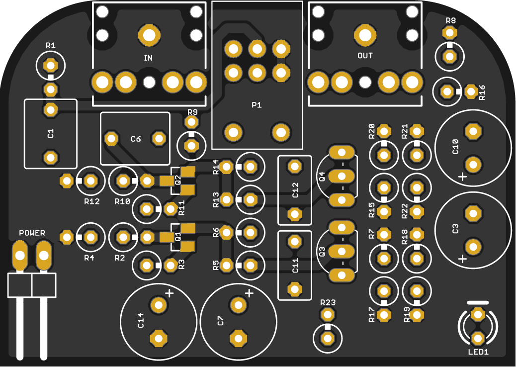

had a thought today that if we make the PCB in a hybrid SMT and through hole for all non-actives, people might not be as intimidated to make this amp without worrying about soldering all those little resistors. It is simple enough that we may just have enough room. What do you all think?
+1 for through-hole soldering preference! Ill attempt it either way, but this makes it less daunting.

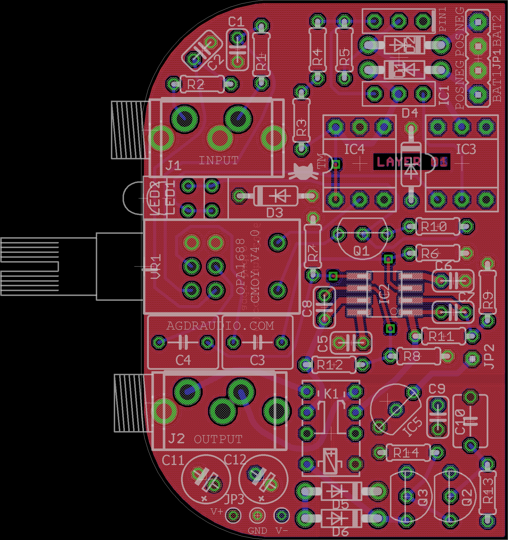

I am concerned that the 3.5mm jacks you have don't have enough spacing (center to center) with the volume knob shaft to allow a regular volume knob to fit without interference. Please look at the jacks used on Agdr's. Super CMOY - they are narrow profileand allow you actually squeeze a pair of input caps and an LED in between and permit sufficient clearance for a knob.
This may free up some space on main area by moving caps and LeD away. Also LED on end next to pot shaft is preferable.

Yup! The BF862 is only available in SMT. I could easily place provision for 2SK170s for those who can get em.Nice! You got it to fit as through hole except for JFETs!

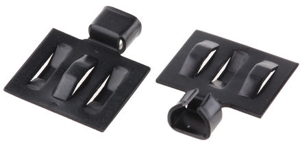

Indeedy: http://www.mouser.co.za/ProductDeta...=sGAEpiMZZMshyDBzk1/Wi0w8OutPcgKpEXQ7Oa3Ayf4=Is that a TO220 ZVN4306? It will have to rely on air convection or tiny TO92 heatsinks?
This is why I asked for consensus on 3.5mm jack . Does anyone know what make and model the ones Agdr used are? Otherwise, these are decent and also quite slim: Product – LumbergPlease look at the jacks used on Agdr's. Super CMOY
The part no is in the BOM in Agdr's thread post 1. It's from Mouser I think. How is the photo of the thing you posted supposed to be used as a 3.5mm jack?
Oh I see that's the TO92 heatsink.
The linked part is indeed compact but has no threaded nut for securing to the panel and must rely on the PCB for stress relief of insertion and removal. That may break the boards prematurely as they are only anchored via volume pot.

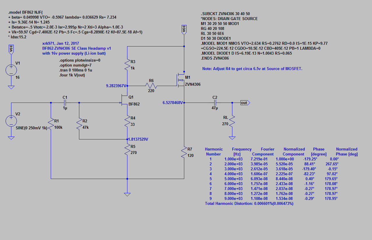

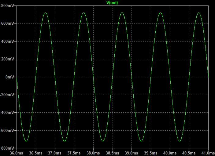

Revised sims with Li-ion batt

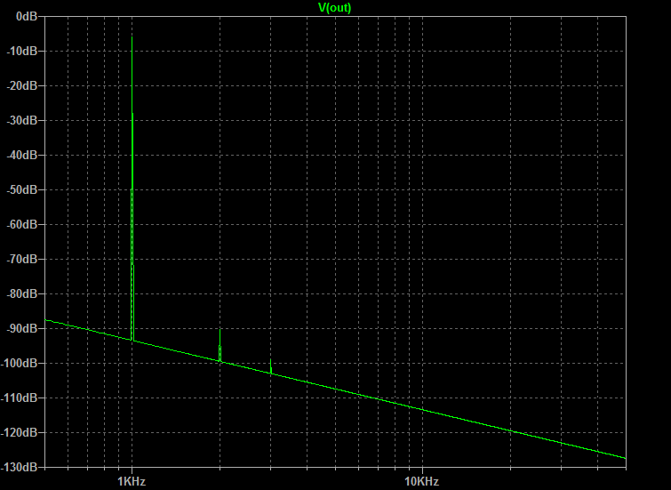

I just noticed that a rechargeable 9v Li-ion battery is not really 9v but 8.4v and under load is more like 8v. So I set power rail at 16v and put in as built parts (except for R2 which needs manual adjustment for particular Idss of JFET). The predicted THD is now a very respectable 0.0065% at full volume. The FFT is still very nice looking.
And FFT (with grid lines this time) at 1.40v peak-peak output level:
1k sine wave at 1.4v p-p:

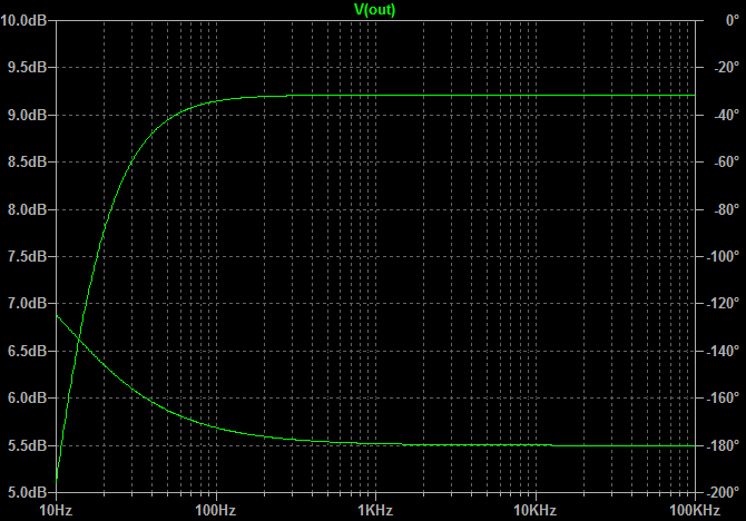

Frequency response and phase for above. -3dB point is about 12Hz - phase is off about 50deg at 12Hz but is within 20deg above 35Hz. Use of larger caps would flatten phase but at expense of non-euphonic (H3 same as H2) harmonic distortion profile. I would rather take 20deg shift down to 35Hz.
C2 and the 270r load is setting the ~12Hz roll off. And starts to have an effect from ~120Hz downwards.
If you add any headphone load in parallel to the 270r, then the roll-off frequency will move a bit higher.
I suspect this high roll-off frequency is what you heard when you made comment on the mid range frequencies.
