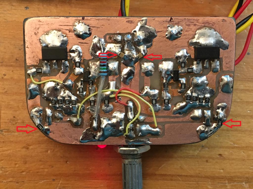

New amp I just made last night - truly CMOY sized but SE Class A MOSFET output. BF862 input stage and ZVN4306 output with about 67mA bias current. Sounds very promising. 🙂

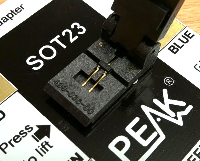

How do you test for idss those smd parts(bf862) without soldering them?
With a small board like this. I had to flow a tiny amount of solder on the pads so they were ever so slightly higher than the pcb surface. Tweezers and patience help.

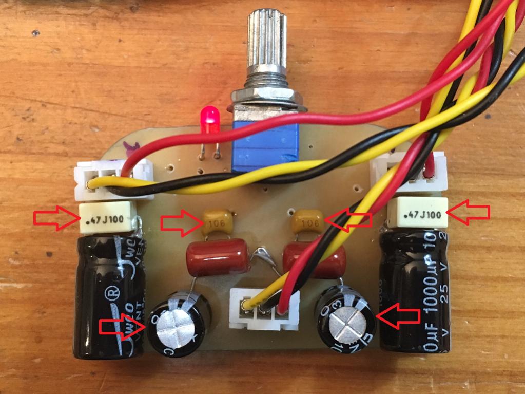

I added Vishay 0.47uF 100v MKP bypass output caps for added top end clarity; also added 2x 100uF 63v electrolytic power rail smoothing caps right next to MOSFET drain pins; added 100nF X7R bypass caps on MOSFET drain power rails; added 10uF 50v MLCC caps to the 1uF MKT input caps to get more bass extensuon; added 270R load resistors (shunts to ground) on outputs after coupling cap to load amp more and increase bass output and reduce HD (per sim of other similar amps - lower impedance than 250R brings HD down). Changes shown by red arrows.
I have had a chance to listen to my usual suite of test tracks including jazz, female vocals, pop, deep house dance, rock, ... and this little guy just really suprises me! Puts a smile on my face and my feet start tapping. The mods helped the clarity and bass extension - very powerful bass beyond the little size would indicate. Absolutely low distortion and very pleasing harmonic profile. If I am right, there should be low amount of H2 and vanishingly small H3, and nothing else.
This amp is getting a case for sure. Well, it's just an Altoids tin for $1.67, so no biggie - but nice to have a pocket class A amp. Doubles as a hand warmer in this cold weather. 🙂

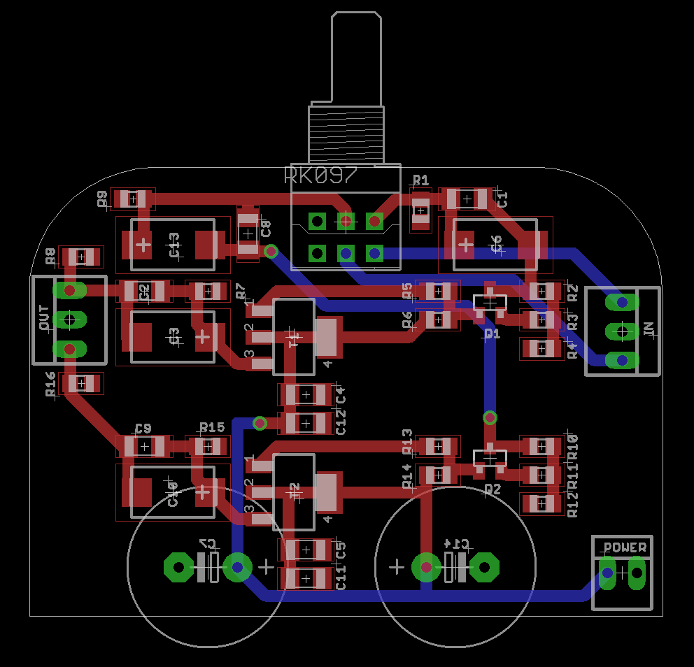

It sounds wonderful. I don't do CAD layouts so someone else will have to help out for a real board we can send to a fabrication house.
Excellent work! PM reply sent. 😀
Very preliminary, but it's a start 😀.

Thanks BDHM. You might want to look at my layout and follow it closely because it uses the larger copper plane on the end (1/3rd of the board) as a heatsink. Also the arrangement places the MOSFETs and the power resistors arrays at 4 corners to spread the heat. This board is pure class A and dissipates 18v x 140mA = 2.5w. Also, probably need to put through hole on one side like I did and mount board upside down like Agdr did. Need to use a pot with on off clicker. And maybe make room for PCB mounted 3.5mm jacks.
Thanks!
I was going to add planes top and bottom with vias to spread heat, but I'll look closer at your design 🙂
The two big reservoir caps are on the opposite side

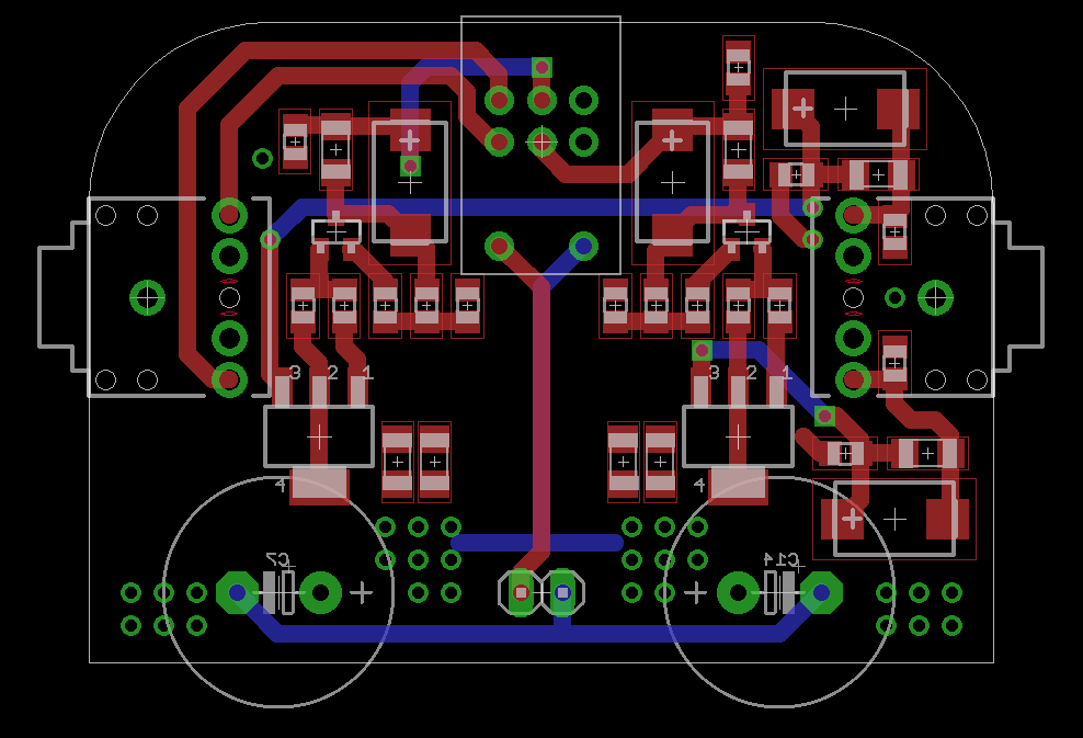

How is this looking?
Two images, one with ground and heatsink planes removed for clarity
Hey that looks great! I've had the Monday morning realization that I just don't have time to layout anything else right now, but looks like you are well on the way. If there is a group buy, I'm in for one! 🙂
Better but you have both source resistors and MOSFETs next to each other and heat output will be pretty concentrated. I am testing in actual use now and my current setup is very good at spreading heat over entire board evenly. The resistors actually put out as much or more heat than MOSFETs.
I can touch the heatsink area next to MOSFETs for about 12 seconds before uncomfortable. That's probably circa 45deg C.
Notes:
1. Move 3.5mm jacks side by side next to pot just like mine to keep cables coming out from one end. Otherwise 90 degrees makes unwieldy and not pocket size with cords plugged in.
2. Reduce size of caps intruding into battery space or move them.
3. Use vertical space in box more - when mounting board upside down (good for heat dissipation - you have tons of room underneath. So use through hole elco caps with 90deg bent leads to fit.
4. Upside down board puts pot centerline and 3.5mm jacks at location on edge that doesn't interfere with lid closing.
5. Use qnty four source resistors to spread heat over larger surface area. Those are the hottest components! I use four 470R in parallel.

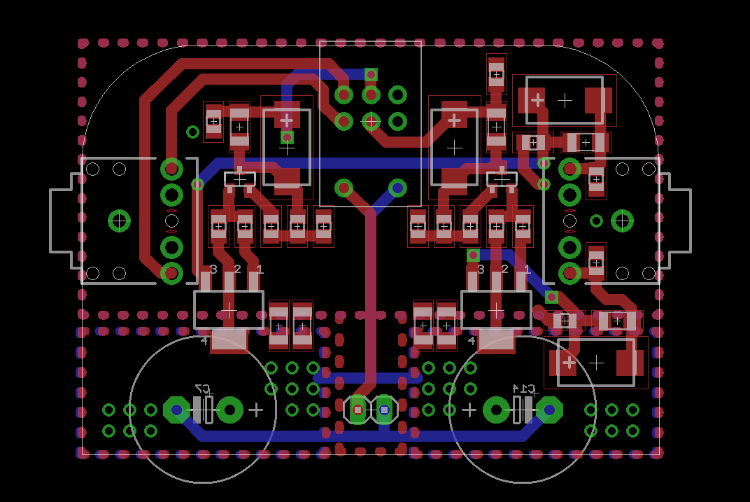

To me it seems not so practical to have in/out jacks on the opposite sides? Placing input, output and volume control together on a shorter side of the mint tin would probably be more convenient since it allows putting the headamp in a pocket while listening, otherwise cables sticking sidewise will not allow it, IMO.
I think I'll order something like this, price is 18£.
Is that just an adapter? Or a tester too? If adapter only that is pricey.
I got one of these testers and had SMT pad but doesn't measure Idss (at least as far as I know). You get Vgs (to single digit past decimal accuracy x.x ) though and was only $16. Also is handy LCR meter.
M328 LCD 12864 Transistor Tester DIY Kit Diode Triode Capacitance LCR ESR Meter | eBay
They're meant to be bent over, the intrusion won't happen then. Alas there's no way to tell Eagle that 😀2. Reduce size of caps intruding into battery space or move them.
Okie dokie. What is the internal height available in the tin?3. Use vertical space in box more
Hmm... perhaps larger TH resistors5. Use qnty four source resistors to spread heat over larger surface area. Those are the hottest components! I use four 470R in parallel.
I was just gonna use right angle connectors 🙂. But sure thing, will move 'em. Before I do so, however, what connector should I implement? The footprint is currently for this one: https://www.sparkfun.com/products/8032 . I'm happy to change it there's a better alternative (preferably with an available Eagle lib)
