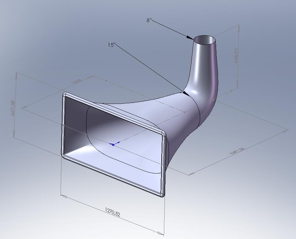

Hi jzagaja, Your horns look beautiful - very high production standard. Would you like to tell us anything about how they are made? How did you make the moulds? Did you CNC machine to the JMLC curve?
I understand from the website that they are fibreglass - is this a traditional hand layup? Or are you using some kind of infusion method? Any plans to do injection moulding and mass produce? I guess insufficient market. How do you get the throat accurate and make the flanges?
You have perhaps seen my own very amateur 'analogue' diy method on azurahorn.com. (Trade Secrets) It works very well, given care - but quality control is always the thing with entirely skill based traditional fibreglass.
Interested in how you have solved the problems, nice job.
best wishes, martin
Thanks 🙂 Autotech uses CNC machine to make a mold:
http://autotech.pl/pdf/firma.pdf
JMLC horn requires two molds - one for rollback and one for horn. It is traditional hand layup plus damping layer if required. SEOS-12 is also made out of solid surface (closed mold). Similar waveguide was mass produced by Diysoundgroup in China by using injection moulding.
Your work is beautiful and shows that no fancy tools are required.
Thanks 🙂. I looked at doing infusion, with a front and back mould, or vacuum bagging, but it was too hard to set up. I think it could be done if one had time and resources to get it right. The next step would be to set up temperature controlled bath and control the process. Composites technology has developed a long way in the aircraft industry, but hard to get beyond traditional layup without big investment. I think your damping layer sounds really good. Few people perhaps realise how much work goes into this.

Being from a tooling background in aerospace I can tell you that the advantage of using those methods for building horn lenses is not going to be that great. Mainly you would have less hassles with any chance of pinholes and the resin content to fiber ratio would change as any excess resin would be removed. But at the same time you would not be using any polyester resin in an aerospace application, everything is epoxy and this rules out using any glass mat, everything is done with only woven fibers rather than random fiber mat materials. Also we do not use gel coats, that just isn't done so you would lose that type of finish, I am sure you have seen carbon fiber parts with the fiber showing and this is what you would be looking at. RTM of the many different methods would also be done this way with no gel coat surfaces. I have done development work in closed tool molding of high speed composites and again there is never a gel coat though you can use an in-mold coating. Tooling would get rather expensive in any of these types of applications and unless you are talking serial molding of high volume not the most cost effective way to go.
