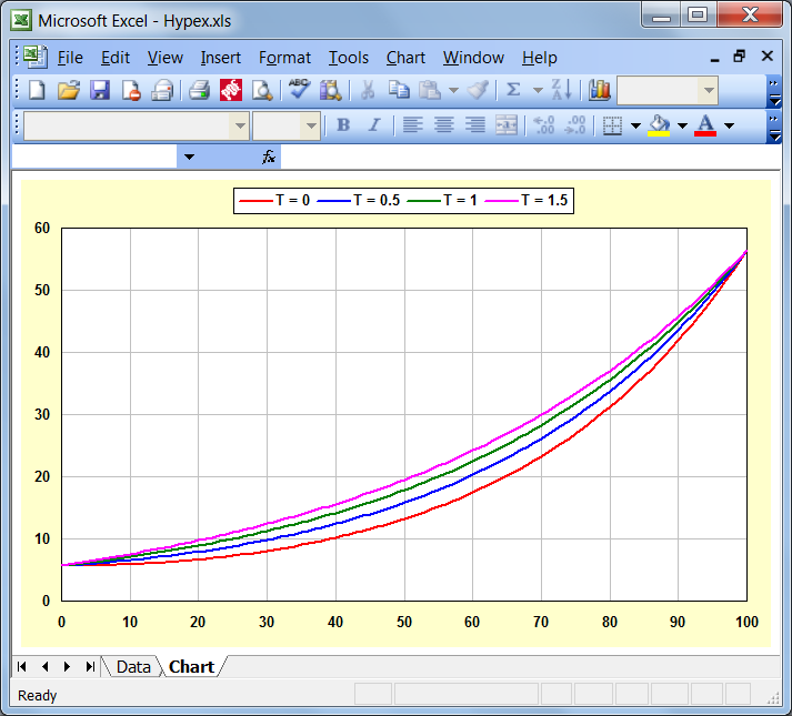

Hi Kindhornman,
I think you will find that a hyperbolic-exponential horn with T = 1 has a standard exponential expansion rate.
(The expression describing a hyperbolic-exponential horn simplifies down to that of an exponential horn when T = 1).
Kind regards,
David

Hi Kindhornman,
For an exponential horn:
m = Ln(S2 / S1) / L12
or
m = 4 * Pi * fc / c
In each case the unit of m is length ^ -1.
m is not equal to the area doubling length.
Area doubling length = Ln(2) / m
or
Area doubling length = Ln(2) * c / (4 * Pi * fc)
(where c = velocity of sound in air, fc = horn flare cutoff frequency)
Kind regards,
David

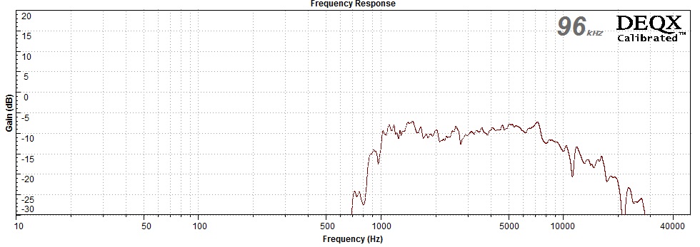

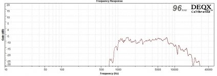

I have 475 Be in my system for 3 days. First impresion compared to BMS4538 is luck of sharpness and much more detality. I will try to make measurements and post it.

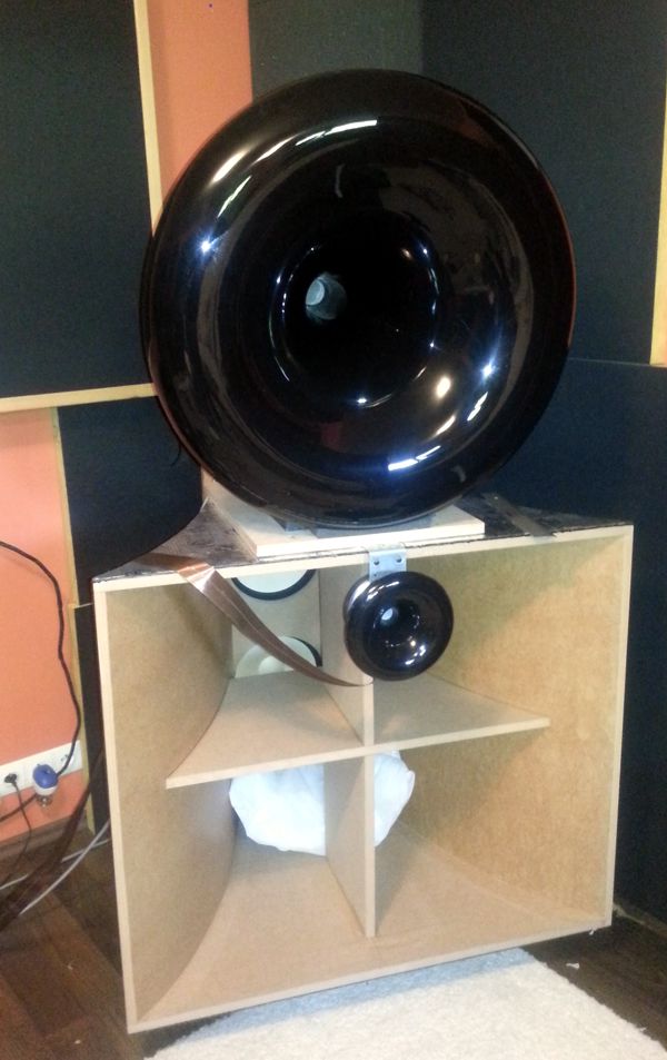

My system is fully active,
2 x SONIDO 300 paraler in 100 Hz JMLC horn (without ane enclusure now)
JMLC270 with BMS4592Nd (only midrange section is used)
JMLC1000 with radian 475 Be (was BMS4538)
xover points 400Hz and 1800Hz done by DEQX
amplifiers firstwatt F5 and LCAudio for biggest horn
to my opinion it is the best cofiguration, although 457Be cam be crossed lower than 1,8k i would not suggest treeble form bigger than 1000Hz horn, this I have done before with BMS4592 and the bigger horn the worse treeble JMLC400 was acceptable but sepaating midrange form treeble satisfied me more
David McBean,
Thanks it has been years since I did the math, should have gotten out my book and taken a look. Off the top of my head don't I remember Si=S0 e^mx as exponential with M being the flare constant in an exponential expansion. Been so long since I used the math need to look it up.
