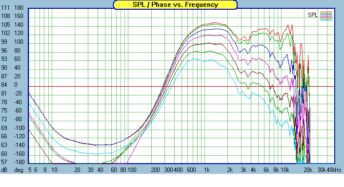

I was looking at the frequency response and impedance plots on this site and it looks like there is some ripple in the 1k and below measurements.
https://sites.google.com/site/drivervault/driver-measurements/horns-and-waveguides/azura-425hz-horn

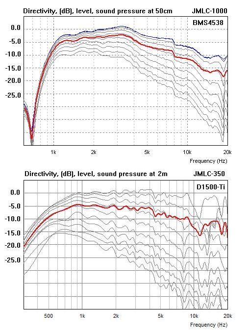

Autotech alternative ?
The Autotech JMLC horns have mouth termination not fare from 180 degrees. I have the 325 and the 1000 horns. The FR is smooter in the mids tha Azura horn. Does anyone considered them as an alternative to the Azuras? Lynn have you looked or tried them ?

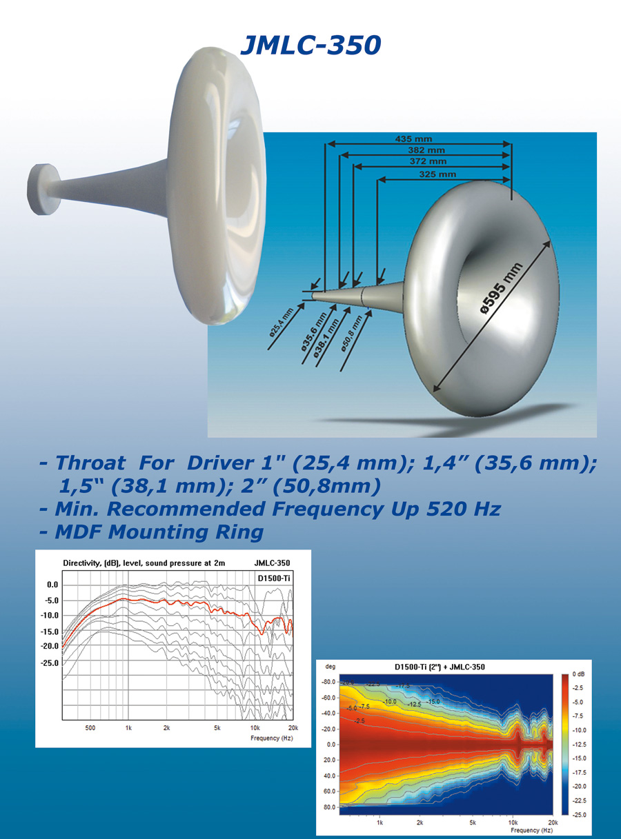

I like the Auto-Tech horns, but I can't find what T value Auto-Tech used.
I was looking at the JMLC-400 as being more equivalent in size to the AH-425.

The DriverVault notch between 3 and 4 kHz is a driver artifact, as far as I can tell. The width and depth of this notch was not the same between the two 288's tested by DriverVault, leading me to surmise that either the centering of the diaphragm, or differences in radiation from the tangential surrounds, is responsible.
The notch is not present with the Radian 745Neo driver, with very smooth response between 700 Hz and 10 kHz. Radians use a stretched Mylar surround instead of the Altec/GPA stamped tangential aluminum surround, as well as a different phase plug. (My understanding is the Radian 745Neo has a more sophisticated phase plug than the 745 ceramic, which gives smoother response in the 1~5 kHz region, as well as a little bit higher efficiency.) The potential downside of a stretched Mylar surround is a higher Fs for the compression driver, which limits the lowest frequency that can be safely used with low distortion.
The question with any LeCleac'h horn is the match between the exit angle of the compression driver, and entrance angle of the horn. These should be as close as possible, and if there's a mismatch, it's better that the exit angle of the compression driver is a bit narrower than the horn entrance.
If compression drivers and horns are mixed-n-matched without attention to exit angle, the response variations might be the result of mismatch, instead of anything the horn is doing. Similarly, it's a good idea to see how much difference there is between different samples of compression drivers ... if there is, that points to potential problems with the diaphragms.

Dough, I can not find the reference but as I remember T is 0.8. Maybe JZagaja or JMLC can chime in and confirm. They have designed those horns together.
I like those horns very much, they measure and sound very well, much better than my previous Tractrix 400 Stereorlab horns. They are BIG!

Lynn, directly from Jzagaja , the entrance angle of the Autotech 1.4" 350 JMLC is 5 degrees (half angle as I understand). Since I use GPA 288 with an angle of 4 degrees, it is very close.

Autotech always use T=0,8 except JMLC-200 which uses T=0. JMLC-200T uses T=0,8 as well. JMLC-350 has half angle of 7 degrees. It's good for tweeter application especially with new Radian 475-Be that we just received.
