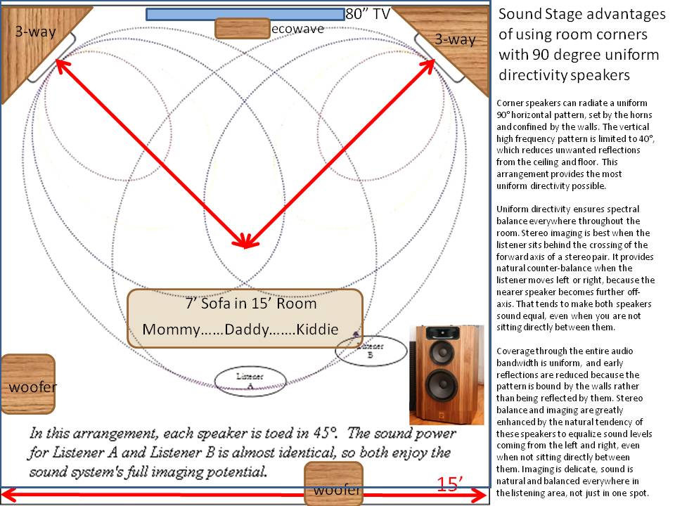

A 90 x 40 SEOS waveguide allows a corner placement option.
Controlled directivity now often means delivering a wide enough sweet spot for a family on a couch watching an on-wall flat panel. Advertisements with a single guy in one chair with a flapping scarf have been replaced by home theater glitz.
