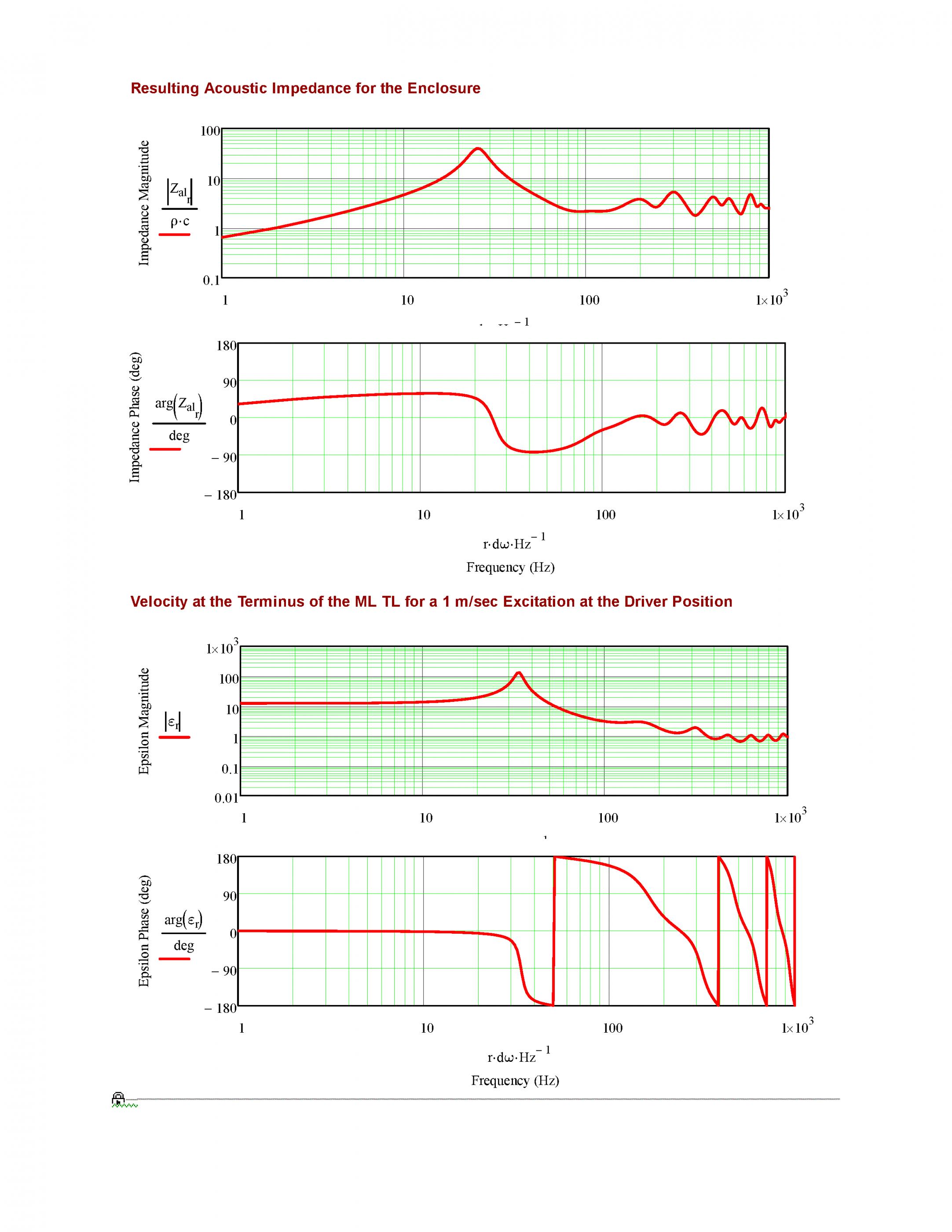

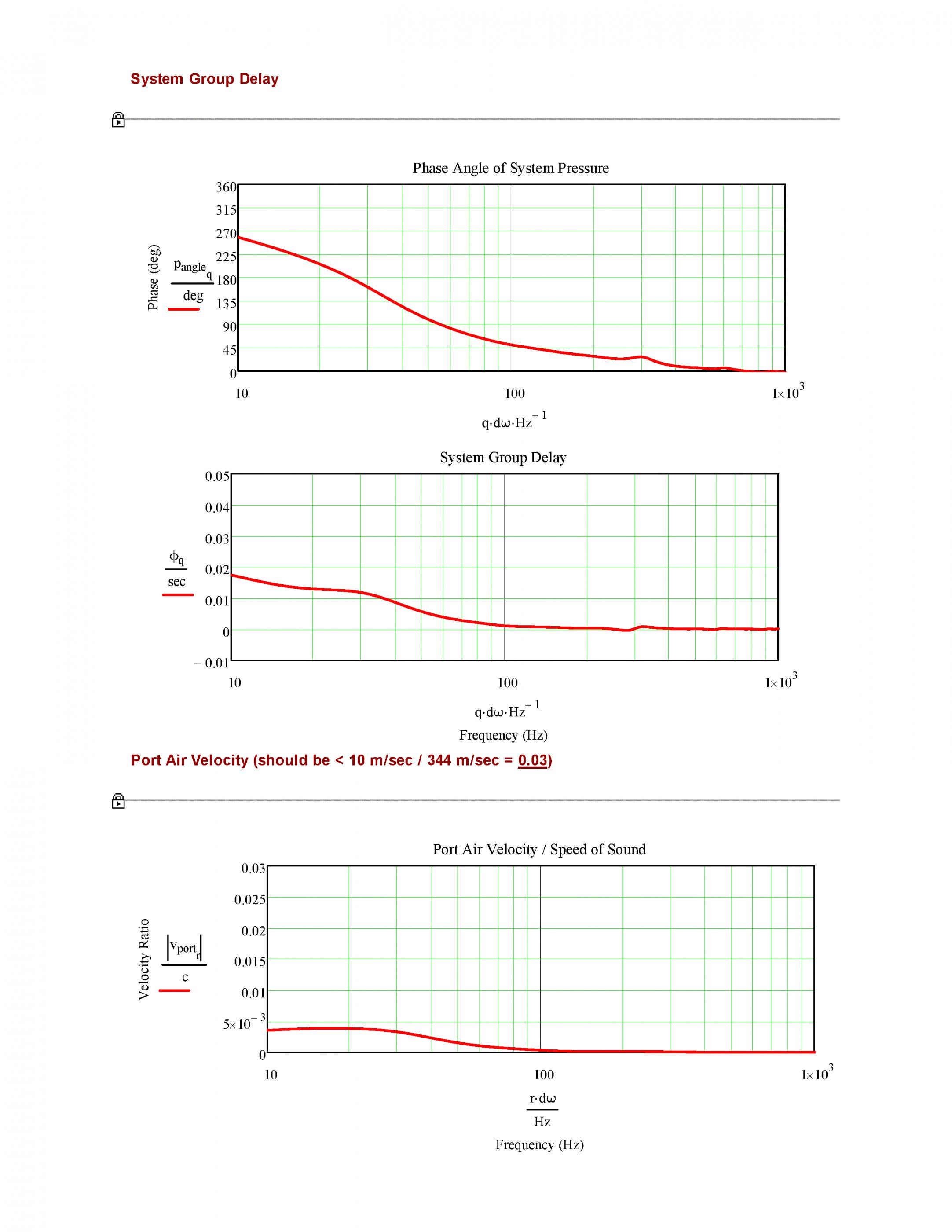

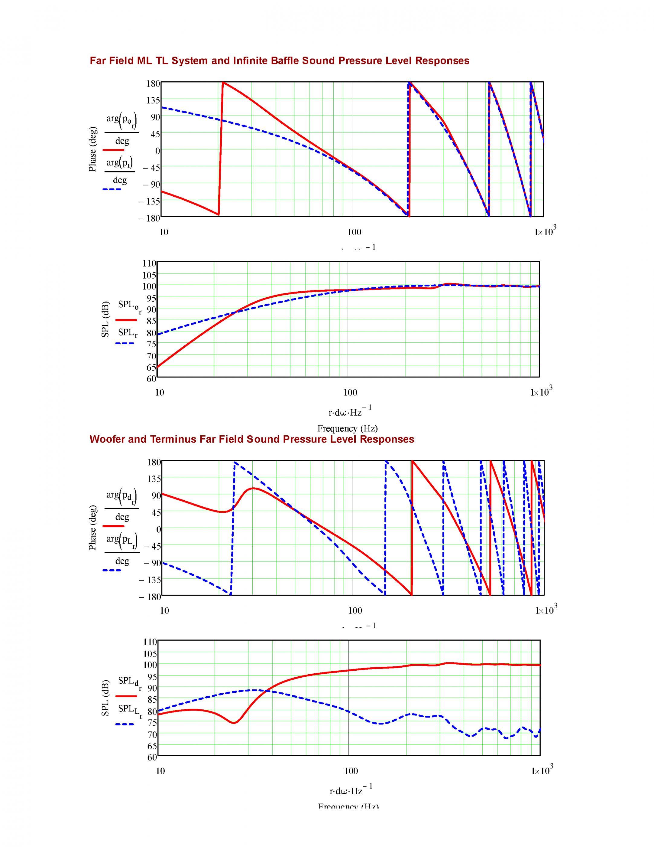

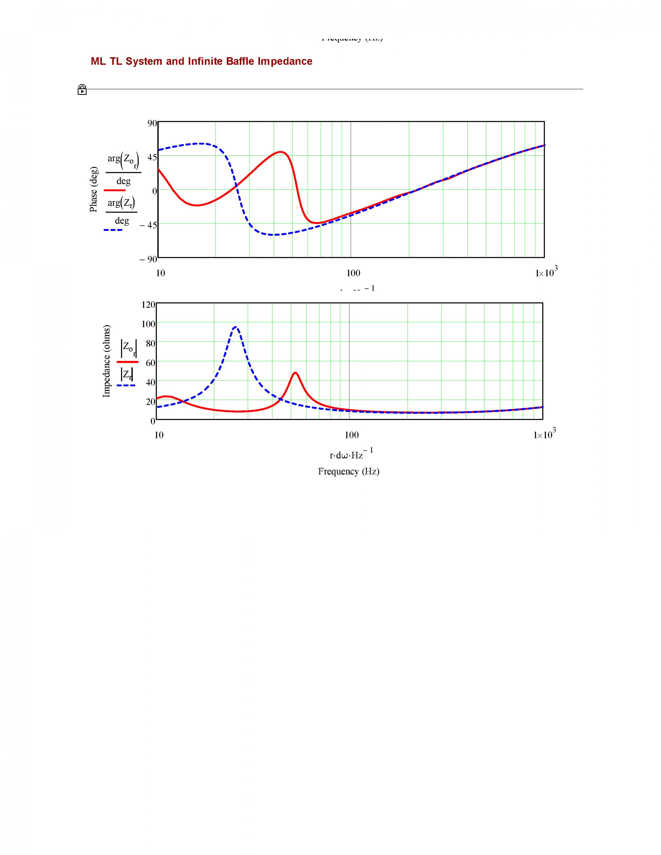

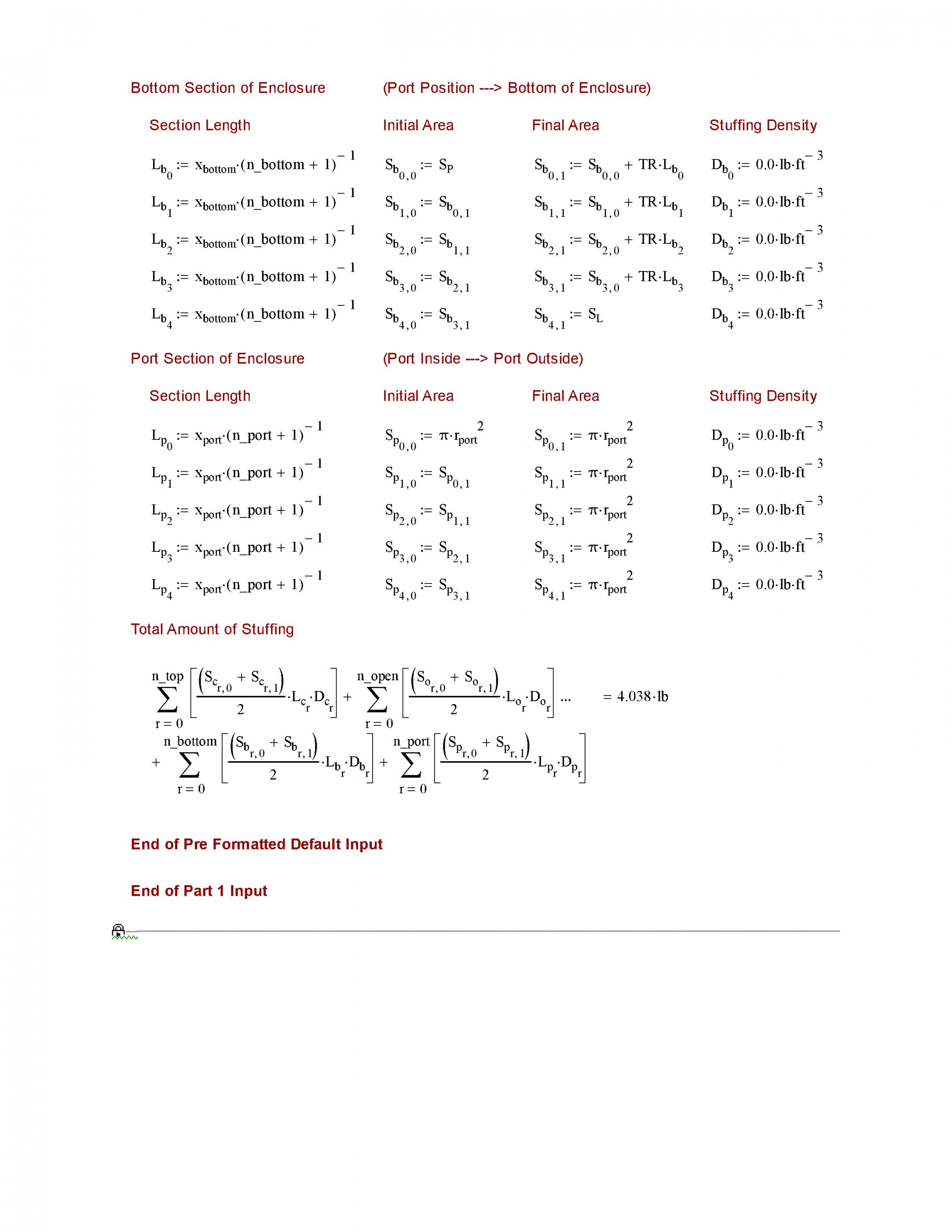

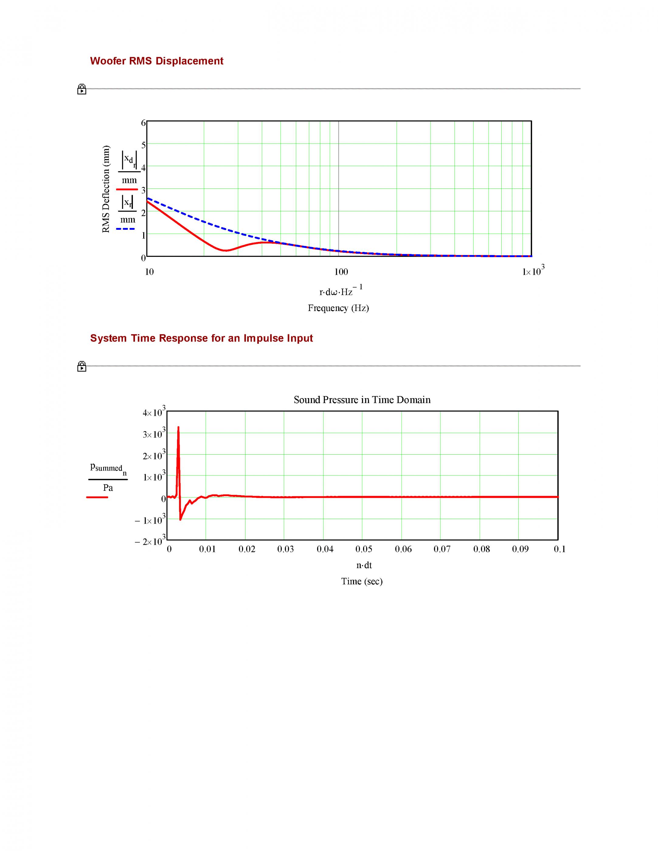

How inmportant is the bass shelf that Line Source designed into his sim. I have heard opposing views about whether to go maximally flat or build to room.
BTW, Here is a sim of my drivers in a down firig box that has a lot of tunability in terms of the LF, by either varying port or stuffing. May try it with linesource's idea.

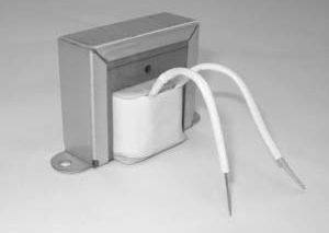

The Xovers I have seen, and not an abundance of them either, used a non saturable reactor. Somewhat of a misnomer, but they provide linearization of flux in the coil, including smooth settling, but do not suffer from the usual gaped choke problems or the nonlinear clumping of inductance in air coils.

Looks like the I is on the back of the E. One big air gap? How do cored inductors behave on very low level signals, when the inductance drops off? I understood more constant inductance was the idea of air cores. But in a cinema probably that was not an issue. Or I maybe these are for lower cross over points than practical with air core perhaps.
martin
The effective permeability of a core constructed like this is 45, rather than a few, to many tens of thousands. What the core is doing is just ordering what is otherwise a disorderly rise and fall of inductance in the windings. Also, since the core is basically inert regardless of the frequency, the typical distortion addition is not a factor. You, of course, do not want to mount these onto a steel plate....
