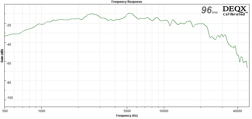

and the same without any horn, 10 cm distance to mic.
I guess a wide band horn CD tweeter would have the same function that the RAAL ribbon tweeter does in Lynn's design. The above plots are a good illustration of the roll off you get with any mid range CD driver / horn, that requires either EQ or a wide band transducer above. I wonder what the optimum Le Cleac'h flare rate would be? A 1200Hz horn would be about 60mm long and 120mm mouth dia. Might go well with the 425 horns - a nice little project for some TD2001 I have. But is there any actual advantage over using say a 500Hz horn? Perhaps directivity would be better (narrower) with the 500Hz flare? I have often wondered what the design objective of the low flare rate short horn stub on old WE tweeters was (WE597).

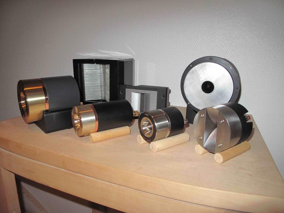

Not neccessarily a problem in real life... depending on the amount of info actually present in this range, also when xovered at a fairly high 2,5 - 3k a TAD-TD-2001 (as an example) will have a mutch simpler task than usual... And a TD-2001 sound a lot gutsier than the smaller "above 7k" tweeters mentioned when used this way, in a small JMLC-1400.
Been there, done that etc. etc.
An XO seem to take away information where it is at. After my minidsp experiments last week, I think an XO at 2.5kHz will be too noticable. I prefer it higher up, and live with the consequences, with beaming and such. Right now I use a very short, fast opening horn with the 2" Radian 750-8, which BTW has plenty of guts with a little EQ. I am not sure at all that this will work with the GOTO S150 clone, that I am building. It would be convenient to have one less channel to worry about, or maybe use it for an extra bass channel.
Is that a JA4281B in the picture, back right? If so what are your impressions?
