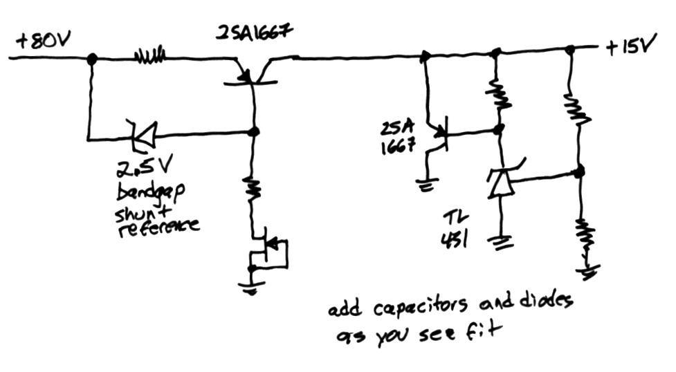

The Vardebedian topology gives tremendous attenuation ("PSRR"), if that is important.

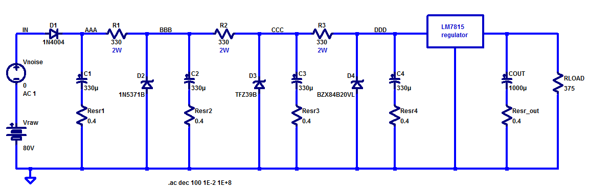

Yes, I mistakenly referred to the 78 reg as "adjustable" when I meant to refer to the "ref" pin (ground) as being adjustable by lifting it with the addition of a zener. In both cases of the 78xx and lm317 regs, they have been susceptible to failure when trying to trick use them above rated input / output differetial of 37v with ref pin directly to ground. I haven't found a reliable way to keep that from sporadically happening and its the main weakness of that type of Vreg.
I like the Vardebedian topology for this specific task, but you must remember: The power dissipated by the original series resistor is now the same in any linear regulator configuration we can think of, but this V regulator should have a great PSRR. Heatsinking will probably be necessary.
Reactions: profiguy
Plenty of PCB mounted (i.e. not chassis mounted) heatsinks can easily dissipate 3.5 watts without roasting the semiconductor junctions. Suggest you confine your search to the ones made by AAVID Thermalloy, their docs seem to contain the most realistic thermal information. Or, since the topology unavoidably contains ballast resistors, you can just connect two (ballasted) transistors in parallel, each on their own less-macho, less-expensive heatsink, and be confident that they will share the current and split the power dissipation, exactly fifty fifty.
All good suggestions High PSRR and low linear impedance is what I'm after. A well implemented 3 pin series reg can do alot, but its lousy at dampening reflected / reactive energy and its critical to get it working in the middle of its "fully on" state of operation.
The dissipation of dropped series voltage isn't so nuch concern if the resistive element doesn't add noise and isn't being run close to its max thermal capacity. I don't believe in running a power resistor more than 1/3 its rating and prefer thick film elements to wire wound as they can be had in to220 case. The small 10w Dale type ww resistors are nice too and very reliable for ballast R. Keeping an active zener out of the power handling path is my main goal, as they are very noisy, loose and non-linear.

Mark, where did you find the info on this topology? I searched and came up with nothing. I can see the theory of operation of separate components but would like to dig deeper into the interaction of it all. Assuming a healthy beta of series transistor is needed. The amplified zener ref shunt makes sense in its topology.
For dampening reflected / reactive energy I think it will be hard to beat the Bybee Music Rail approach. The load current actually makes the regulator regulate better (since closed loop Zout is proportional to (1/gm) and gm rises when load current rises).
One way to think about the TL431 shunt reference IC, is to imagine it as an NPN bipolar transistor whose VBE(on) is exactly 2.495 volts and whose gm is incredibly high: greater than five million micromhos ( >5 Siemens). Unfortunately, neither T.I. nor any of its competitors sell a "complementary TL431", i.e., a PNP bipolar transistor whose VBE(on) is exactly -2.495 volts and whose gm is enormous.
And (I claim) that is one reason why you seldom see the Vardebedian topology actually deployed in the field: in the applications where it might be appropriate, people almost always want bipolar supplies with plus and minus 15 volts DC. IF we had a "complementary TL431" to install within the negative regulator, it would merely be the dual, the complement, of the positive regulator. But there is no such IC. Which means the negative regulator circuit is forced to be different than the positive regulator circuit.
Apparently it's either difficult, or annoying, or aesthetically revolting, to implement bipolar regulators this way. Thus very few people do.
Actually, I prefer a normal zener diode over the TL 431, so all is not lost. Adding the transistor to the zener is what I find most useful. I realize that some here have had problems with zener diodes, but I use them all the time. Perhaps there are serious differences between brands.

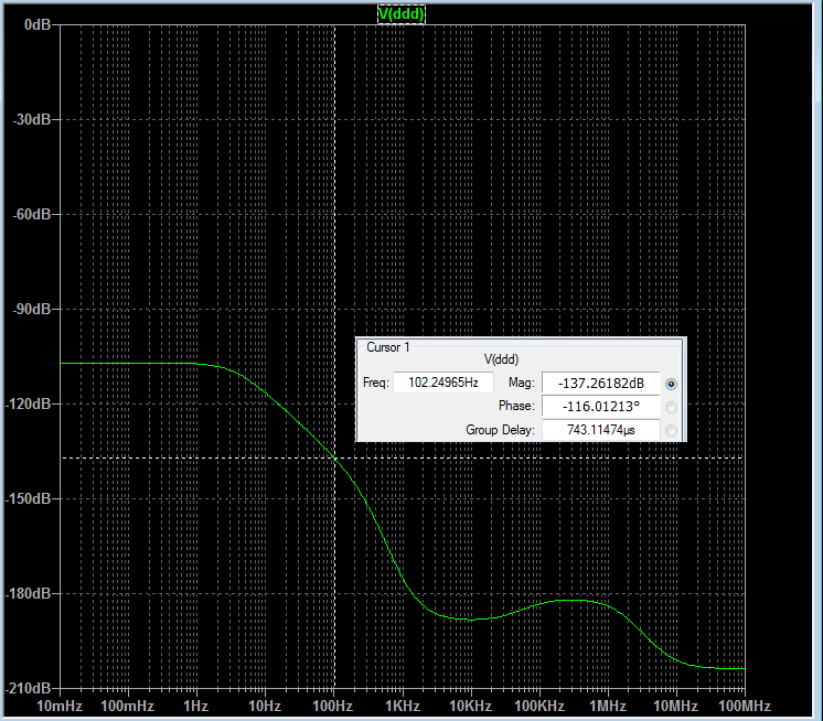

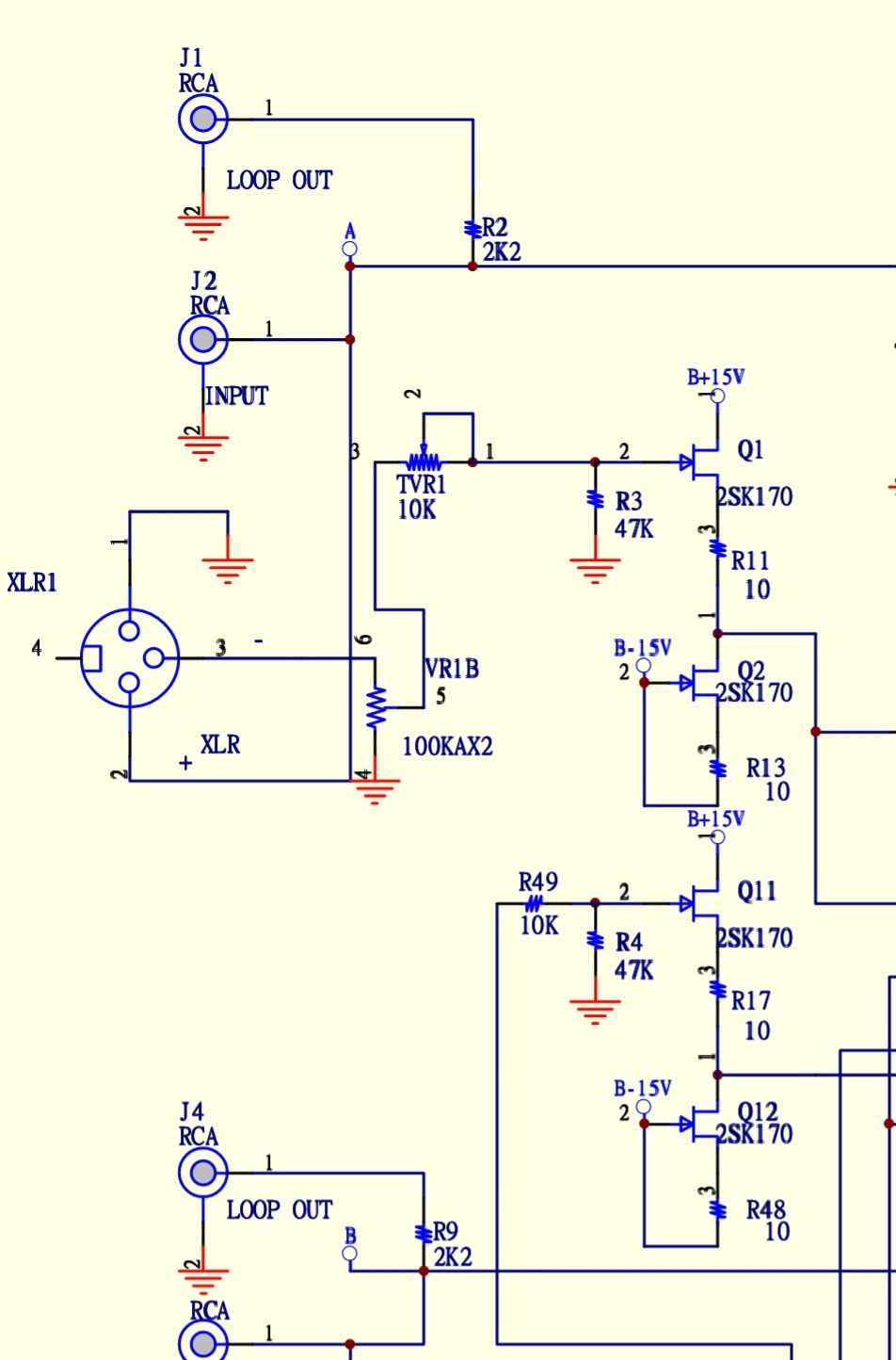

Thats interesting. I'm seeing around -90 dB distortion components in the 15V rails to servo and input fet pairs with a steady state 4 ohm load @ 10W..It gets worse with higher current peaks drawn from 80V main output rails. The fact that isolating the PS rails of the fet input sections made it sound significantly better is a sign theres junk entering the front via the PS.View attachment 1027803

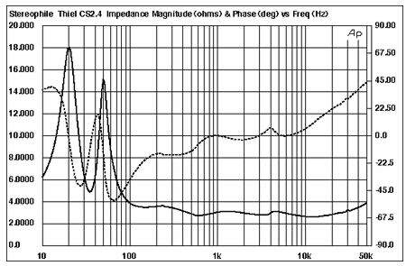

Thank you, unfortunately I haven't the necessary skill to do so. Anyway, in general, do you think that A21 is suited to drive a difficult load as that of the Thiel CS2.4, as below?
@andreaemme I think the A21 would do just fine with that load. I'd stay away from the first generation model A21 with the 80V main filter caps. These were eventually upgraded to the 100V caps because the rails were running right at 80V on the A21, so filter caps wouldn't last long run right at max voltage all the time. Otherwise they're very reliable.
