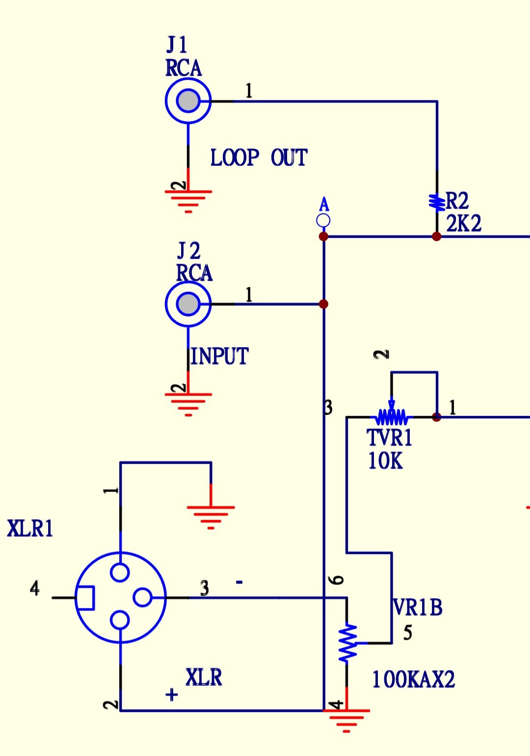

Sorry to take advantage of this conversation, as far as you know, does the switch between balanced and unbalanced input isolate the unused branch from the other? In other words, can I always keep two different sources connected to the A21, one balanced and one unbalanced, and use the switch to listen to one or the other?
@andreaemme The inputs aren't isolated from balanced to single ended. I prefer to install locking silver plated XLR to avoid any unintended disconnects and to improve connection quality. The input sensitivity controls are a potential weakness due to the resistive elements only being connected through pinch grommets. I upgrade these 2 areas on all of my A21s, then bias them to roughly 220W after about 30 min.
