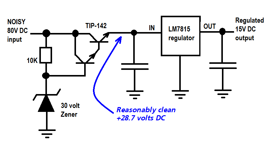

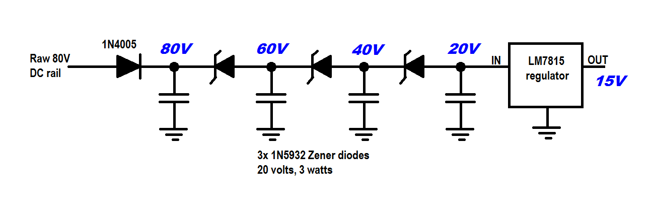

Use a discrete pre-regulator, optimized for low parts count, to drop most of the excess voltage and dissipate most of the heat (Darlington needs a heatsink). Then a proper regulator IC provides low output impedance and good regulation. Simple to explain, simple to understand, difficult to screw up. Forgiving of novice mistakes.
Optionally, substitute the fanciest Hyper Mega Super Regulator circuit on the planet, instead of the plebeian single-chip LM7815.

I appreciate the suggestion. I just want to stay away from having zeners in the active current handling part of the vreg circuit. Maybe a few amplified zeners in that arrangement would be worth exploring. I just get nervous about oscillation with a design like this and killing the amp - matched J74s and K170s are not easy to come by these days.Sutherland-style ladder using zener diodes as level shifters. IC voltage regulator at the end for low output impedance and good regulation. Simple to explain, simple to understand, difficult to screw up. Forgiving of novice mistakes.
_
Yeah, that was an option I was looking at. It appears reasonably simple and very effective. Definitely much better than dumping all the voltage and heat across one large resistor into a tiny 1 watt zener.Use a discrete pre-regulator, optimized for low parts count, to drop most of the excess voltage and dissipate most of the heat (Darlington needs a heatsink). Then a proper regulator IC provides low output impedance and good regulation. Simple to explain, simple to understand, difficult to screw up. Forgiving of novice mistakes.

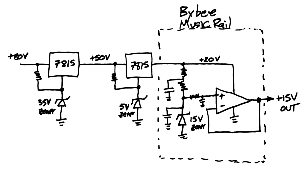

@Mark Johnson those cascading linear 78xx / 79xx could work if the turn on time was identical between them, so the individual regs don't have their safe input ranges exceeded. IIRC the limit is 37v for the standard versions. I've blown up these 3 pin regs before trying to adapt them to higher voltage applications and the problem is during the turn on phase, when the adjust pin cap isn't charged yet and the full delta V is momentarily across the one reg. Leaving out the cap across V adj pin to ground helps but makes the reg output noisier.
7815 is a fixed output voltage regulator IC, it doesn't have an "adjust pin". I've had good success using 7815s for HV applications, with judicious application of protection diodes in crucial spots. Some positions want Schottky diodes, others want Zener diodes, others want ordinary rectifier diodes. At least in my experience. It's worth spending some design time trying out unorthodox diode ideas, in large part because 7815's are so cheap and so widely available even during a global supply squeeze.
